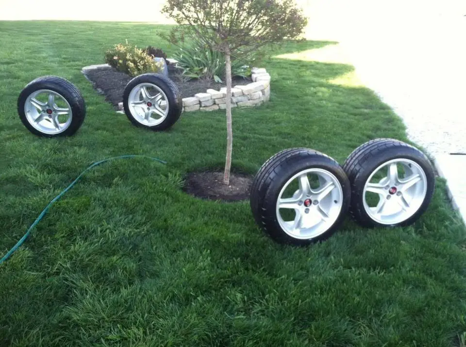

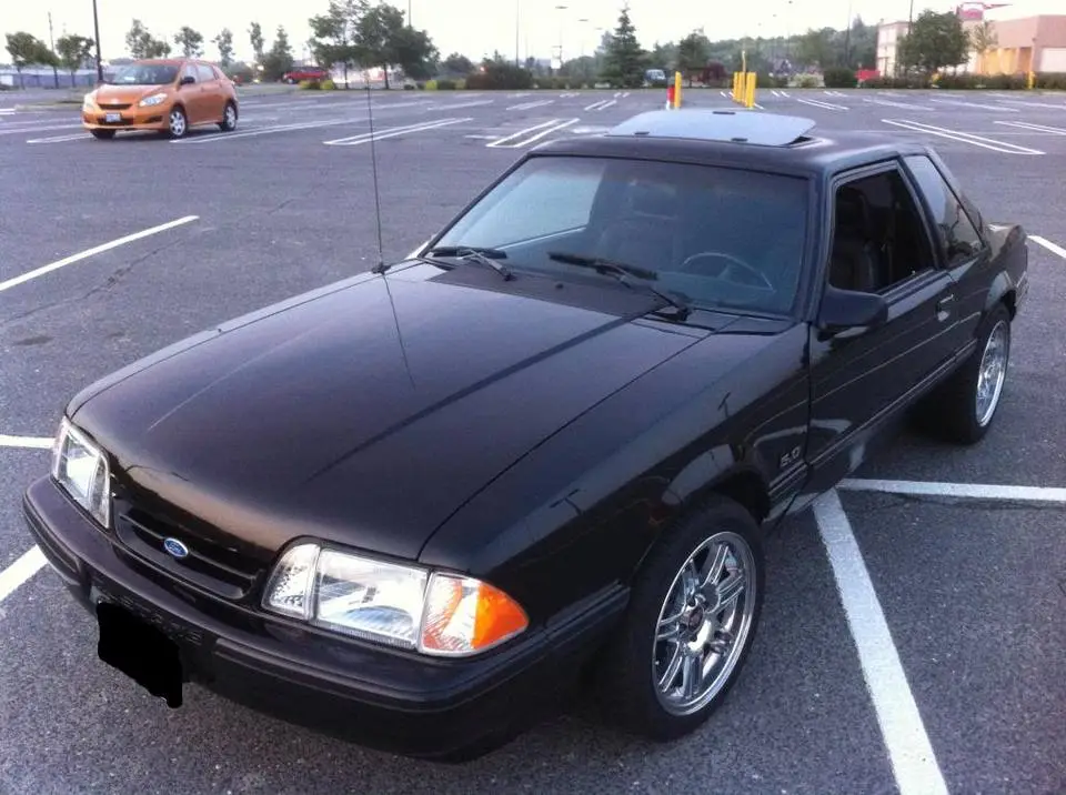

All joking aside, do these tires looked ballooned to you guys? Is there anyone out there with Mickey Thompson Street Comps? I mounted my tires this weekend and for some reason, to me, the sidewalls seem ballooned. Was just wondering if this is how they're supposed to look or if my wheels are too wide for 245s? I thought my wheels were 17x9, but since I did not purchase them, I'm not 100% on that.
Tires are 245/45-17s

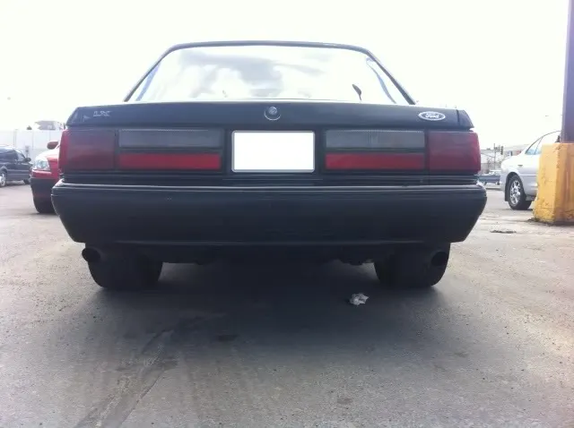

Not sure I can get anything wider than 245s under the front fenders (they'll probably rub some as it is). How wide can you go on the rear a) without removing the quad shocks and b) removing the quads? I have adjustable upper and lower control arms, so I guess I can remove the quads.
A 245 is the low side for a 9" wheel (better fir an 8"), but it does work, although it does look a bit narrow. I run 245/45 bfgs all around right now, but used to run a 275/40 nitto dr out back with quads just barely, any other 275 and youll need to ditch the quads.

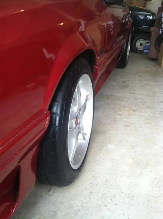

I've got 255/45/17's on the front of my 17x9's and they fit just about square. Ideally, you want a little bit of side-wall protruding past the rim to give you a little curb protection and retain the best ride quality.....but for some reason, wheel and tire packages keep being offered with a 245mm tire on a 9" rim?!?
I've also got 275.40/17's on a set of 17x10's in the rear and they too fit very squarely. Could stand to be a tad wider IMO.
I had to get rid of the quad shocks and tweak the tail pipes a little for them to fit.
FWIW, the '03-'04 Cobra had 9" wide wheels all the way around, with a 275/40/17 and they fit about perfect....but then SN95's have a little more room under the front fenders for fitment.

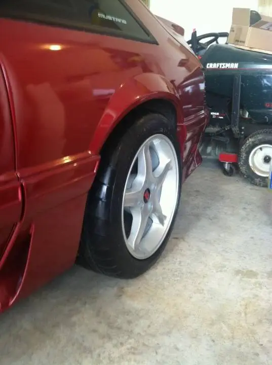

do you happen to have a pic with the 275 tire and 10" rim?
Indeed I do....

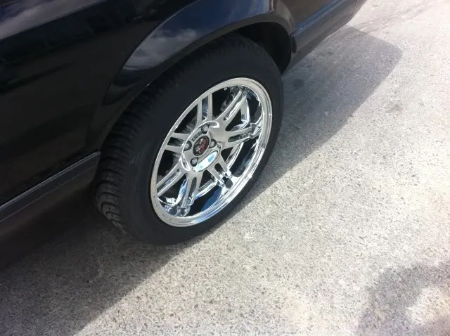

all the tire rim photos in this thread appear similar in rim lip to sidewall to me...
what does it take to get a 10inch rim under the back? lose the quad shocks? anything else? any downfalls to that?

Quad shocks had to be removed and the tailpipes had to be pulled in about 1/2" on either side. I did motivate the inner fenders a tad with the BFG to ensure there would be no rubbing. I also rolled the fender lips a tad in both front and rear for the same reason.
I experience no issues. My car is also lowered approx 1/2-3/4" over stock.
The 255's on the 9" rim and 275's on the 10" bulge far less than the initial photo of the 245 on the 9" rim, but you will still experience it to some degree.
Ideally, I would run a 275mm tire on 9" rim and a tire over 295mm in the rear....but unfortunately a 275mm would have some major interference issue with the front end components without some serious modification. Also, nobody makes a 295mm tire in the correct aspect ratio for a 17" rim. A 315/35/17 is the correct hight, but a little large for a 10"....and you would certainly need to do some banging to get them in there.
