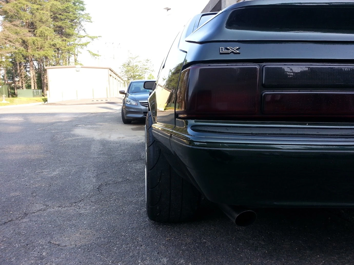

Unless you want to make some major adjustments to the front fenders and the fender bracing, a 9" wheel with a 255 is the absolute widest you're going to get away with. Problem is that with more back spacing, the tire and wheel bulges out past the fender lip, making it look awful. With less backspacing, the wheel/tire contacts the lower control arm and/or the front shock (ask me how I know). I needed to "massage" the lower control arm a little to fix a little contact issue I was having.
Same goes for the rear. Unless you want to mini-tub and lose your tailpipes, you're not gonna get away with running much wider than a 10" wheel and tire combo. And all this is on a car that's only about 1/2" lower than stock. Guys who like to drop their cars 1" + are going to be in for a real headache!!!
I think the widest I've seen without contacting the inner fender was a 10.5" rim and a 315 tire in the rear....but it required a pile of work to make it fit.
Backspacing can only get you so far. If you don't have the real estate to work with, it really doesn't matter.
