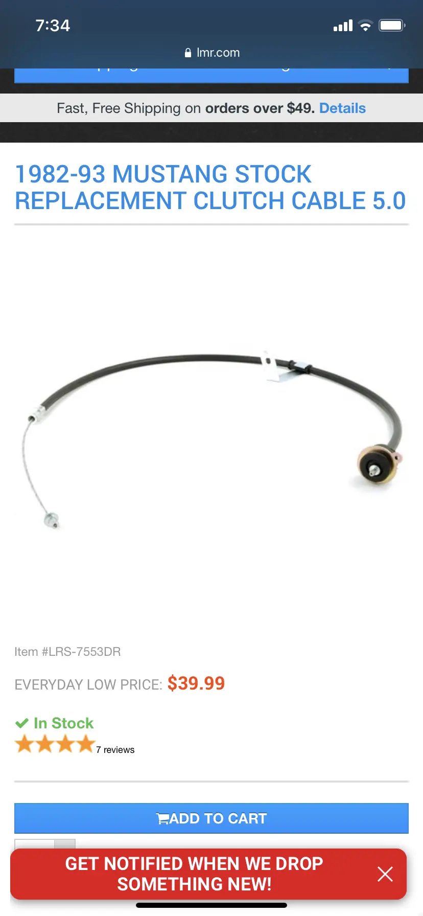

Is there a chance the cable in my car is too long? I bought a new one off LMR when I swapped out the old trans and installed a new McLeod clutch and Ztrans a few years back. I’m wondering if I go with what @Mustang5L5 is running, oem Ford cable and oem/stock quadrant, I might be happier with the clutch engagement??
I was driving it home from work last night, and the engagement is too damn high. Almost at the end of the pedal, but not quite. This is the cable I went with.
