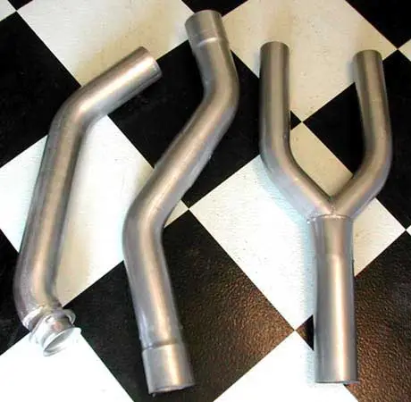

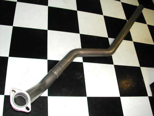

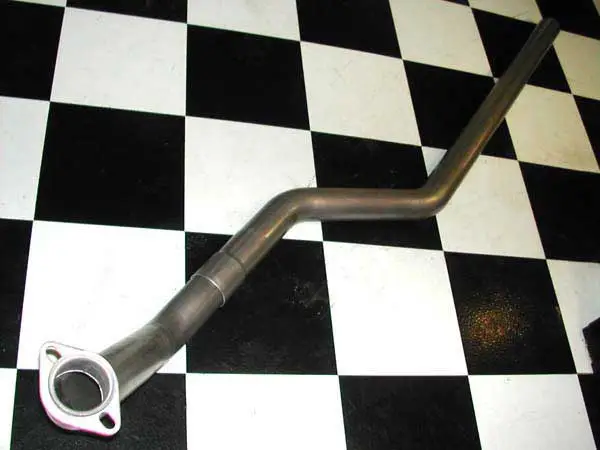

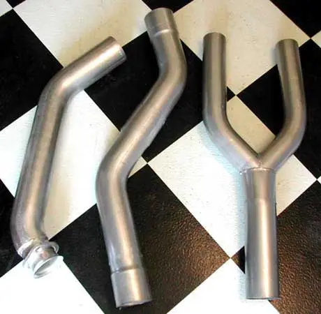

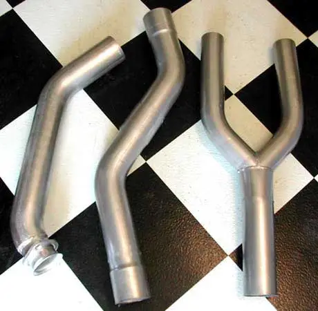

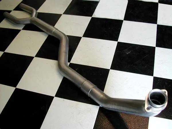

If you are going to do the turbo swap around xmas, I'd go 3" right now...no reason to compromise your future setup for 3 months worth of running time...

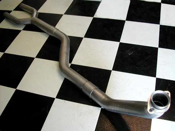

You ought to take a look at my exhaust systems, I think one of my 3" kits without the downpipe (or get the dp and hold onto it until the swap) would work really well for you...
stinger, what tail pipes bolt up to your y pipe setup? It looks nice, dose it bolt right up like a stocker? Im starting to gather the parts for my turbo swap and I am going to be in the market for a downpipe and exhust rather soon.
