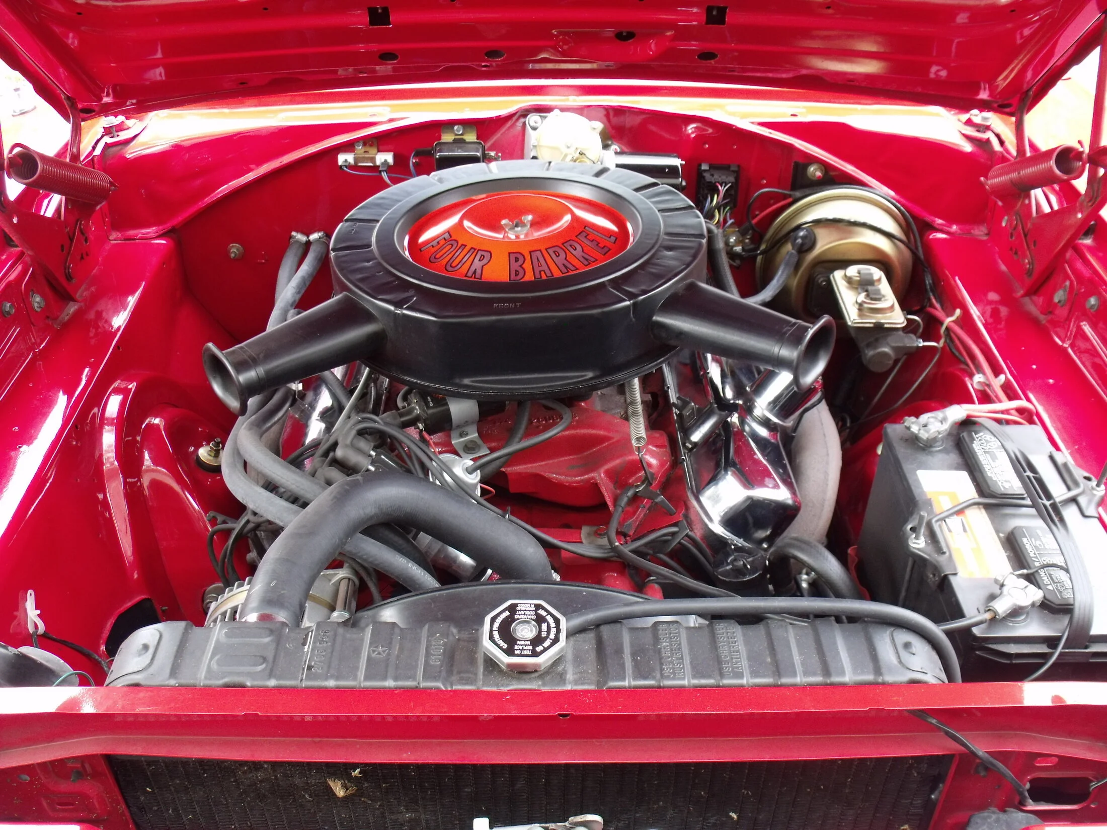

After the resto on my Dodge, it would not crank occasionally and I had charging problems...
Turned out to be a loose nut on the starter relay... took a new alternator and starter relay to figure it out...

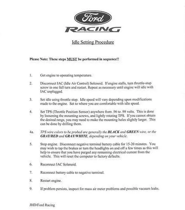

Try a base idle reset.
