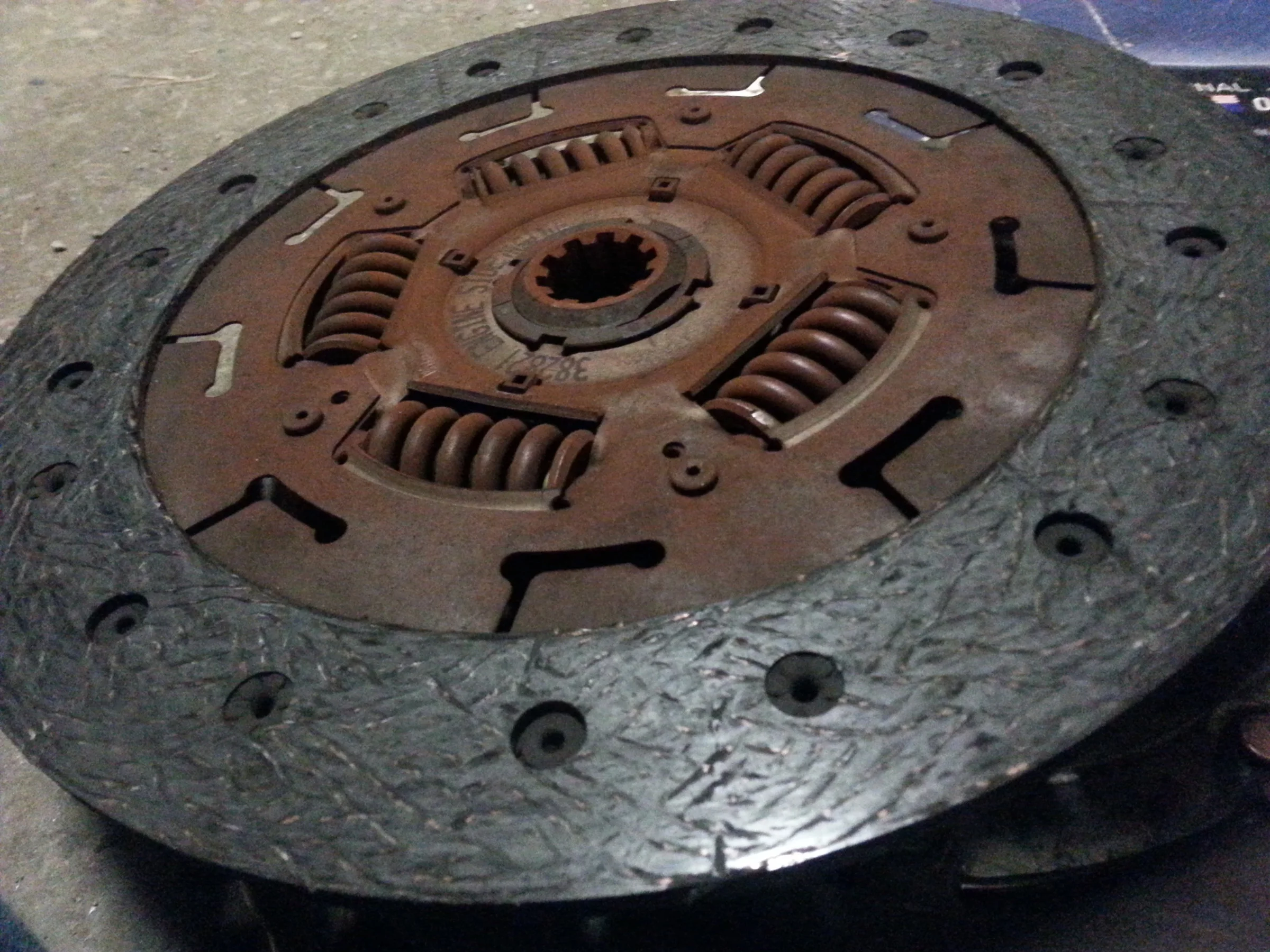

I'm still new to clutches and i believed my clutch to be slipping starting at mid-to-high first gear. i mean, a 4.56 gear ratio in a t5 should definitely get me to 60mph in less than 9seconds right?
I see there is two plates/discs and i'm thinking it is the friction material riveted to the metal :

. I was nearly 100% certain when i went into reverse up a slight incline the clutch was out now.
Here is the clutch:
its too bad we cant use 100% of it or at least send it in for a core.

and Yes that makes sense now why i was shifting but get no speed at all. it had me thinking o2 sensor, fuel injectors, the whole engine "works" . oh well, at least the new injectors are ethanol compatible hahahaha.
