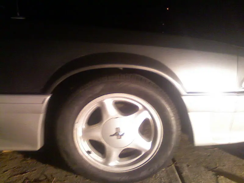

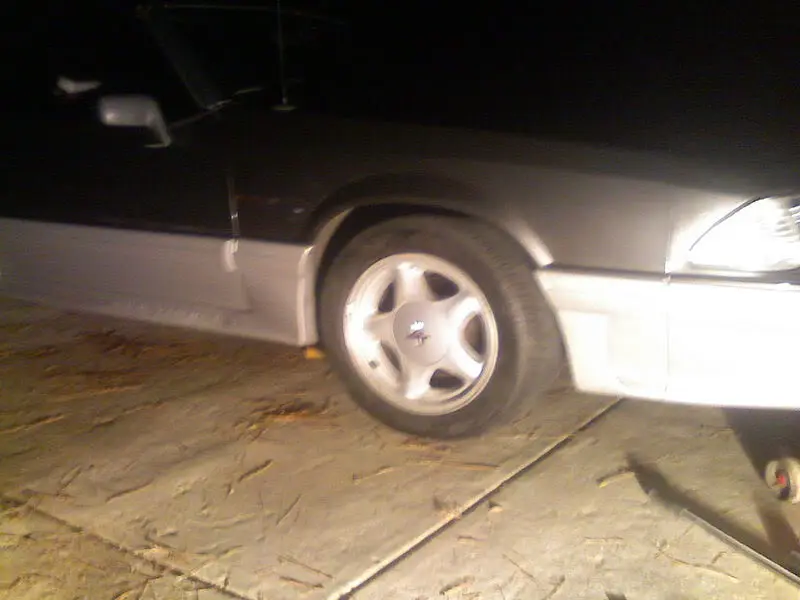

Ok here are some teasers at the request of BK and slow95
They should settle a little bit but I love the way it sits. There is a badass rake right now though lol. I didn't take off the wheels and I didn't even use compressors. It took about exactly 2 hours from start to finish. 1.5 for the first then I got the hang of it.
Basically I supported the arm at the kmember, unbolted the two bolts. Lowered it almost all the way, then unbolted the sway bar end and lowered the rest of the way. At that point I just swung around the A arm until the spring came loose, no pry \bars or anything just by hand and I jimmied the new spring and isolators in there. VERY easy.
