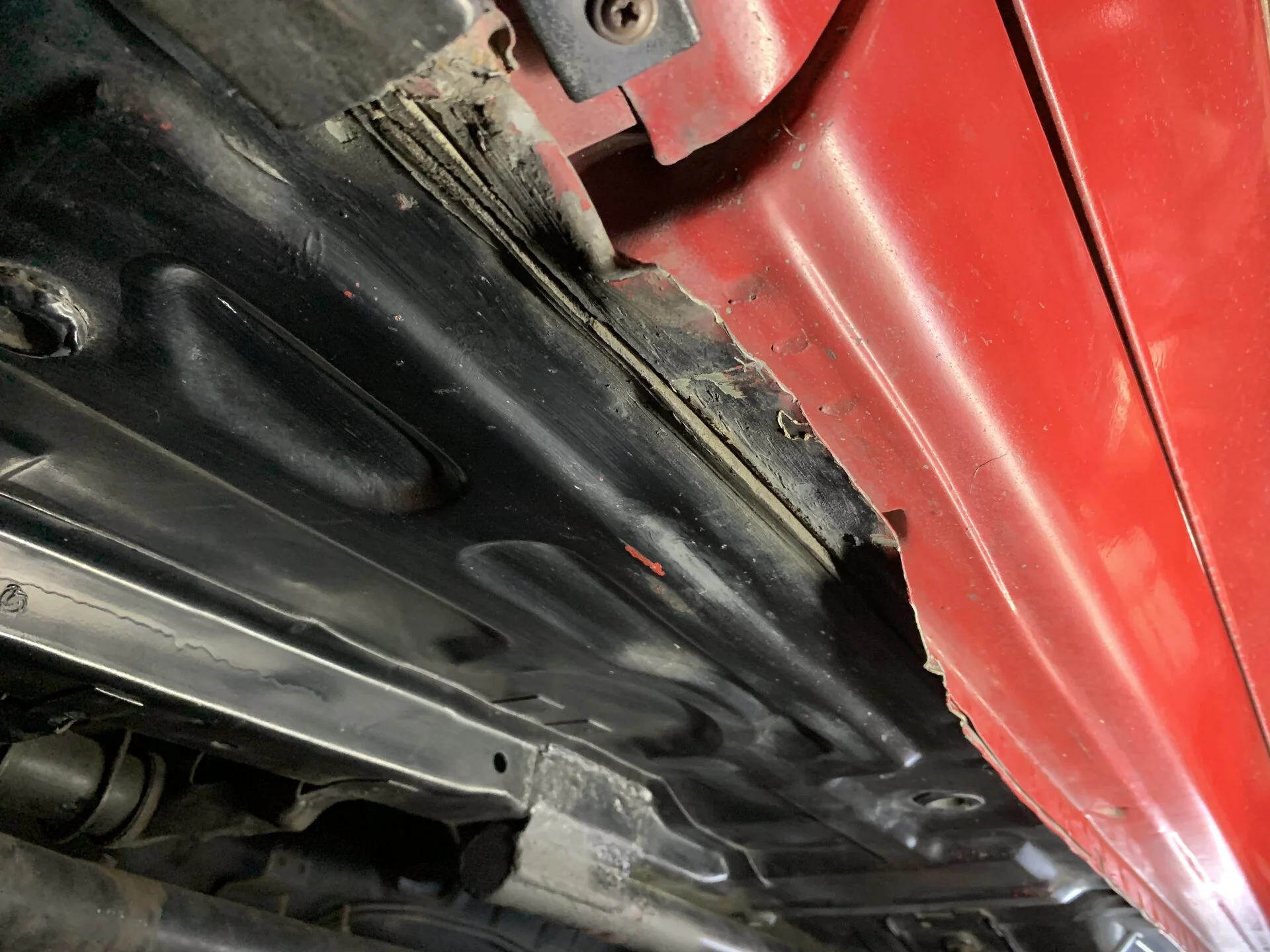

I point out the impressions made in the sheet metal of the torque boxes, with perfect 90* notches at the corners. He says it came that way f the factory.
I’m done.

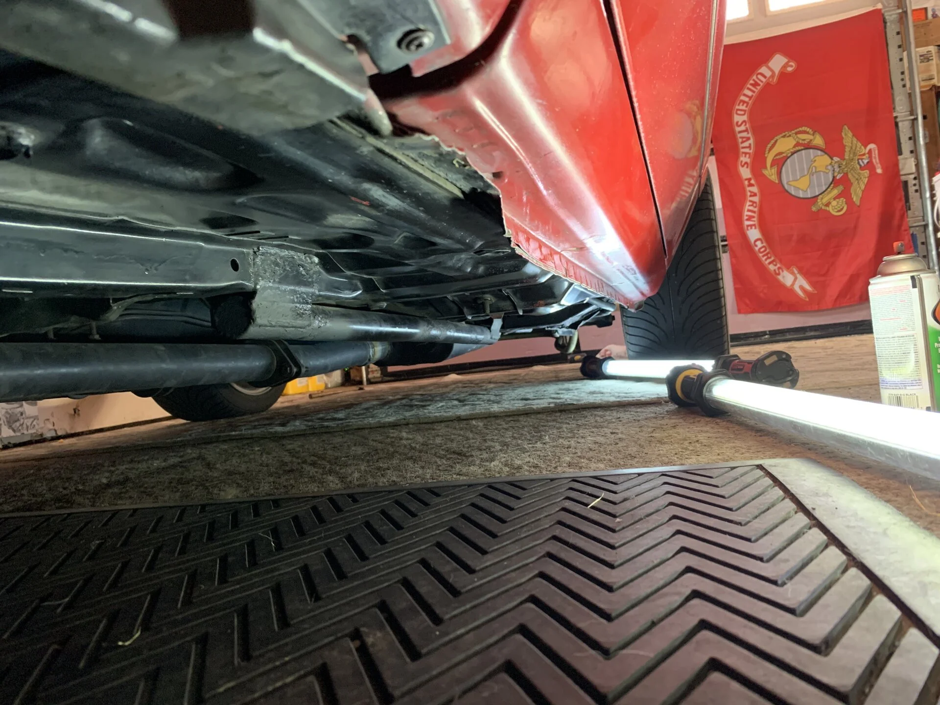

I ask him to get my car down please, he does, I leave. I didn’t get pictures while it was in the air, I was not thinking clearly. A lack of attention to detail on my behalf. I tried to get pictures in my garage, but the angle sucks and my motivation is not at peak, to say the least. I took pictures of the driver pinch weld. The driver torque box is worse than the passenger.

I'm interested in seeing the pad impression and where they are located, I think I know what happened but that depends on the location
Ill get better pics of the torque boxes soon.
I hope they go back and fix what was damaged and not try to get out of it.
See post above. I would love to hear your theory but if you would like to wait for better torque box pics, that’s cool.
Wow. Yeah, you don’t lift the car from there. The scissor jack that you use to lift one quarter up is a folded seam in which the strength is from the seam itself staying vertical and unfolded. The scissor jack is designed to keep it vertical. The minute that lip folded over, the structural integrity was lost and it bucked. A 4 post lift should NOT go there. The fact that sheet metal bent in doing so is a strong indicator that they were doing it wrong.
Yeah. I've never jacked mine up on the pinch welds. They will fold right back down for that part of it. Sometimes when putting on jacking rails you have to bend those back to 90 degrees before installing.
I never have either. I’ll do my best to bend it back pretty, but I just don’t have it in anytime soon. Honestly, my emotions were overwhelmed taking the simple pictures I did. I’m just a wreck right now and I miss my friend and I feel like I’ve dishonored him. :leghump:ing pity party bullsht. I gotta check out for awhile y’all. I’m sorry.
Never seen that from lifting or jacking a fox and I have jacked under the axles, torque boxes, pinch welds and some more.
Its aggravating but these things are pretty fixable.
They 100% did not use a pinch weld block when the lifted it, they used the flat square which I 100% know because when we lifted my son's car, we did the exact same thing to the pinch rail and now I have to fix it.

A thought not mentioned as to what caused the damage. Could they have dropped it or part of it (say back half) while they were beginning to lift?

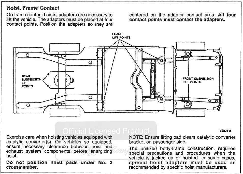

Being someone who has put dozens and dozens of cars on a lift, I only use pinch welds if it’s absolutely worst care scenario, or we’re pulling a body off to do bushings or something. There has only been one car I can remember we lifted from the pinch welds to actually do a fair bit of work on.
Also, the torque boxes should not buckle or leave any major indentation if you place a lift pad underneath. Not that I would recommend placing one there when there’s a perfectly good frame rail right next to it (or a sfc), but I haven’t ever seen one bend or warp. Not saying it isn’t possible, just never seen it done myself. I would really like to see what the torque box looks like.
Regardless, I’d never put a lift pad even close to A pinch weld on a fox. Had mine and friend’s foxes on our 2 post countless times and never had an instance where the arm goes anywhere but sfcs or subframe.
I concur with all saying the lift pads were placed in the wrong locations. I’ve owned a two post lift for 8 years and have lifted dozens of cars and I’ve always avoided lifting a car from the pinch welds. I always try to lift a car from the most structurally sound locations which in most cases is near the front and rear subframes where there’s the most material.
In this case, I would never lift a fox from the pinch welds. In the past, I’ve bent my pinch weld using the factory jack just on one corner. On my car I always put the lift pads on each end of the subframes. I have know idea why they didn’t lift this car from the subframes.
IMO, this car wasn’t lift correctly and that’s the cause of your damage.
I agree with the lift placement, or improper use of the lift causing this damage. I’ve followed his threads and posts in “how your Foxbody sits”. The car is immaculate. There’s no way he didn’t notice this, for those who think it was possibly there before.
