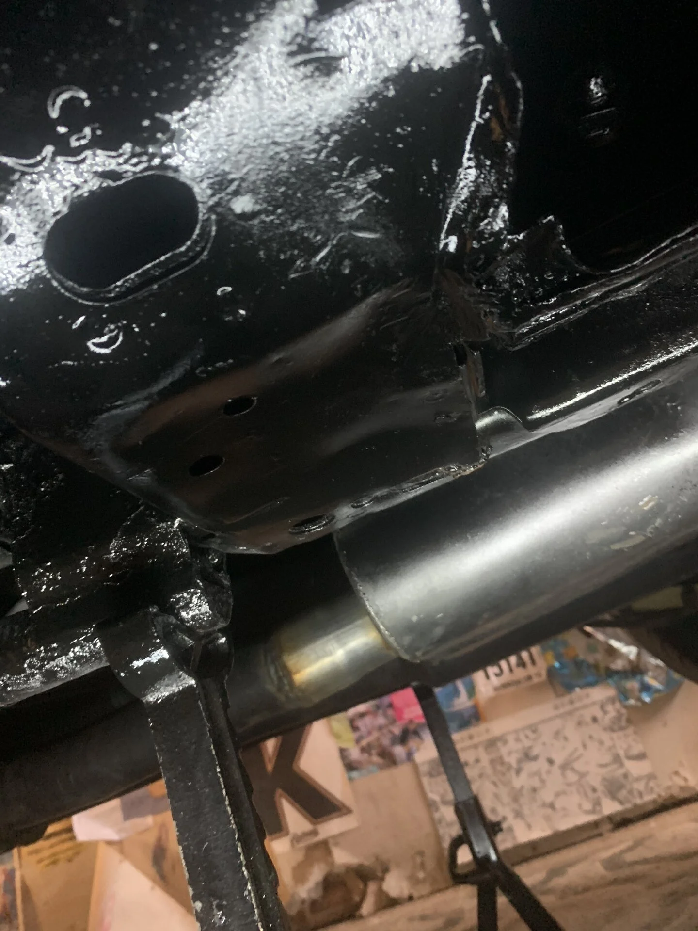

Well it’s obvious that they flattened the pinch weld, and I’m sure that the rear torque box is going to show evidence of improper placement, but I just don’t understand how the top seam joint would move without any other single piece of the rocker or floor deforming along the length of it. Especially now that there are SF connectors into the equation.
Its simple to see,..put a piece of thin wall tubing and pull it hard enough to bend. The one side buckles, and the other side stretches...both fatigue points are clearly visible.

To the OP, I would have a quote done by a body shop. I don't know what to tell you, that is just awful. However, there is a distinct chance that body is not worth fixing.

Once it's put on the machine, it's straight.
Weld, here, here, and there.
The welds were flattened. Insurance, small claims court, or both. Sometimes sub-frame connectors have to be removed either for the machine or because being put on the machine, indicates that the welded sub-frame connectors were/are part of the issue.
We recently had a discussion in another thread about how simple these cars are to check for and straighten on 'The Machine" (dun-dun-duhnn).
Just to be clear, I only know of one instance where sub-frame connectors had to be removed because the installation was botched.
Honestly, besides the obvious flattened pinch weld and torque box tweaking, there’s no way that should have caused the other problems you’ve got now.
I’m thinking they had a near catastrophic incident and were probably pretty happy that this was all the damage you had.

Hey all. I had my Mustang at the mechanic last week for a noise from the rear. This mechanic has always been honest with me and done really good work at reasonable prices. He’s a Ford guy, and in previous times he has worked on this car, he has shown it great respect. However, this last visit he told me he thought the axle needed an entire rebuild and the price he quoted was way beyond the estimate I had in my head. This was after taking 5 days longer than he said he would. Unusual, but whatever. I quickly decided I could buy a built axle and install it myself for much, much less. I tell him I’ll have to think on it and I’ll take the car home for now.
This car still has original paint minus the hood and deck lid and is in absolutely minty condition. No rust, dings, dents, scratches, you get the picture. However, I quickly noticed when I get out of the car in my garage that the door sill at the floor doesn’t look right. I can see the difference in paint color that it has moved about 1/16” back. I open the passenger door and gasp. The floor sill is about a 1/2” back and pulled away where the 2 seams meet. I go grab my creeper and on my way back I can see my trunk lid has two spots about 1” in length where I can see bare metal from the trunk rubbing against the body when I got my pack out of the trunk and closed it. Looking closer, the whole trunk lid is closing about 1/8” lower than it should. I look underneath the car and I literally shed a single tear.
My previously straight torque boxes are CRUSHED. This car is so minty the pinch welds have never been bent. Until now. Clearly the car was put on a post style lift improperly. I could have lived with that alone, but all of it together nearly pushes me to the edge of insanity. I purchased this car from my best friend’s family after he took his own life. Combat induced PTSD was too much for him to bear. We went to school together, we both enlisted in separate branches of the military around the same time, and we both got out on forced medical around the same time. Working on this car together was therapy for us in a lot of ways. A swimming pool of beer was drank between us with the car as the only witness. We spilled blood together on this car. A perfect, rare survivor and an embodiment of the only man I’ve ever loved that wasn’t blood to me. The mechanic wanted me to bring it back tomorrow, but I have other obligations so I’m supposed to take it back Friday. I really don’t even know what to do. My heart is breaking so I feel like I can’t think clearly right now. I couldn’t get clear pictures of the torque boxes. Other pics included. My daughter cried, I almost lost it in front of her.
How bad is this? Can lifting the car from the torque boxes as a lift point cause that much damage or did something else happen? All thoughts welcome, please. Rant over. Beer incoming. My precious....no.....God no....

A friend of a friend heard about what happened to my car. He owns a body shop not far from me. He asked me to bring it by Saturday and he would take a look, no charge, no obligation to let him work on it. I almost didn’t, but my friend that referred him is a car guy I trust and I was feeling fairly desperate He called me yesterday afternoon and said he had straightened the body lines out, smoothed out the pinch welds, got the door sills level and even banged out the torque boxes a bit. He told me the floor pan was still crack free, the frame was straight and there seemed to be no structural damage. He said he thought it looked as if perhaps it partially slipped off the lift because the driver side torque box was damaged more than the passenger side. Regardless, I’ll never know what really happened.
When I picked the car up, it looked like nothing had even happened. The sun was shining down on it, it was all cleaned up, and I was overcome with emotion. I asked what I owed, ready to pay absolutely anything he asked. He told me his brother had given his life in combat in 2009 and after what had been done to me, it didn’t feel right taking my money. I had brought $500 because that’s what my deductible is, any more and I would have just claimed it. He refused to take it. He said he didn’t use any supplies, just time and effort. The whole thing was so overwhelming. To have gone from the lowest of lows, to one of the most humbling events of my life was a lot to take.
My Mustang is back in the garage. I still have the issue with the noisy axle, but I’ll probably just buy a built rear end and swap out one for the other. At least it’s safe, at home and only slightly worse for the wear, I guess.
Oh and FWIW, insurance basically told me I was **** if the shop didn’t want to pay and I couldn’t prove they did the damage. That was definitely a shock.
Lastly, the money shot. I couldn’t get the passenger side to show up. It was much less pronounced and hard to get to show up in a pic.
