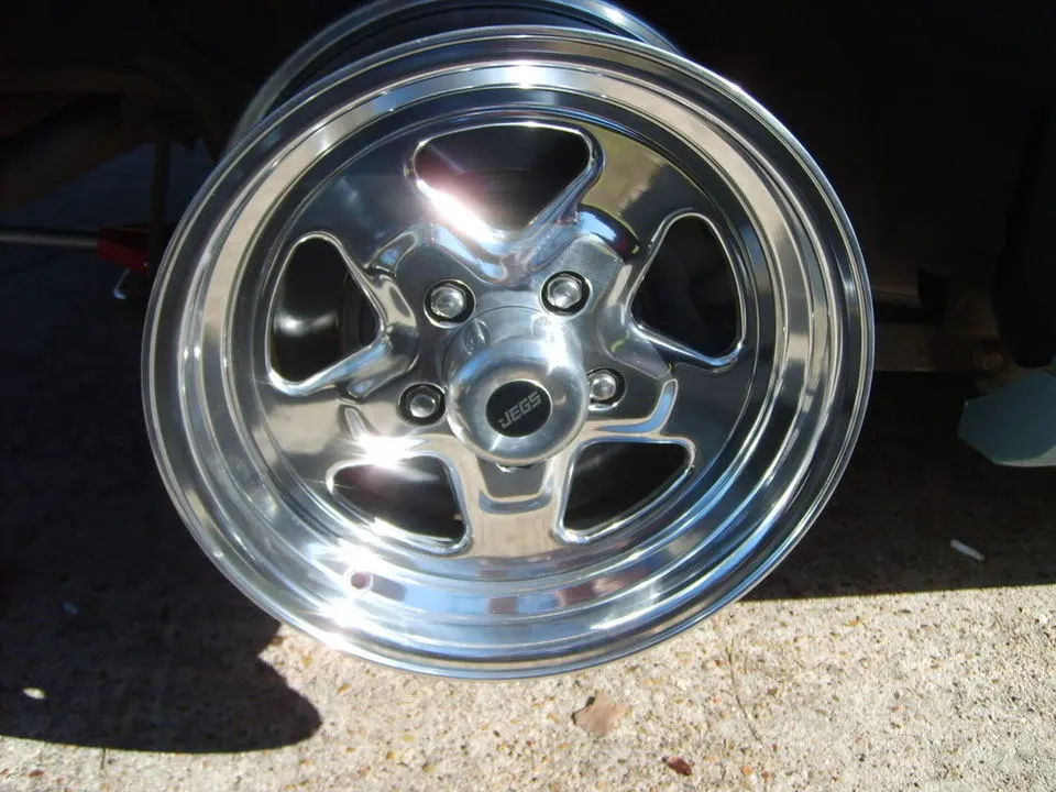

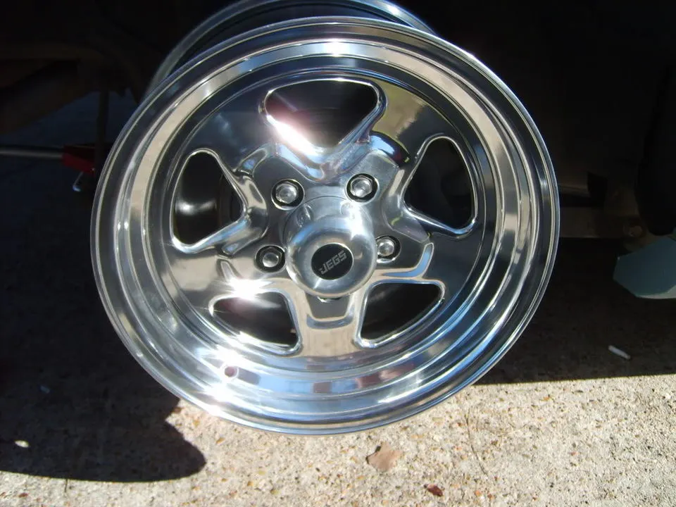

i ordered a set of jegs sport star wheels, 15x4. used a 3/8 spacer. and it fits no rubbing what so ever on my 2007 gt. it was stated before that the early 2005 stangs had smaller front brakes, so they would fit no problem like this, but i figure i'd try it out on my car.
no problems. gunna order the rear set, and try out some spacers next week.
tried my brothers drag lites instead, and it was rubbing.
so i guess however the design of the inside of the wheel is different, makes up for it.
pictures will be coming shortly, my phone was acting up so i couldn't get any pictures.

JEGS the 15x4 with the 1.75 backspacing with the 4.5 bolt pattern. then a 3/8 spacer. i ordered the billet ones like a moron, so i spent about 30 bucks more then i should of but oh well. hah.

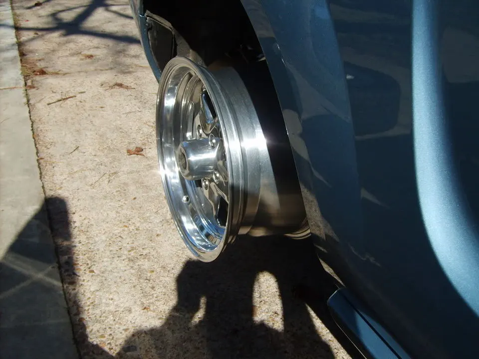

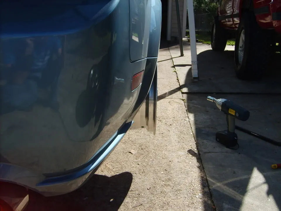

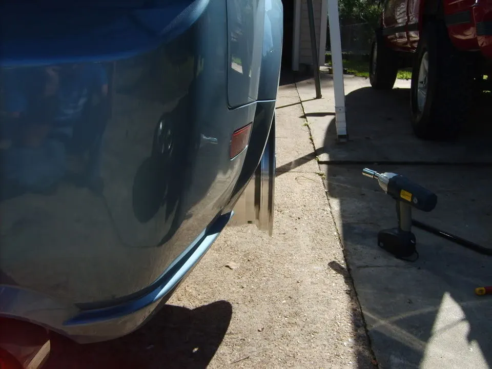

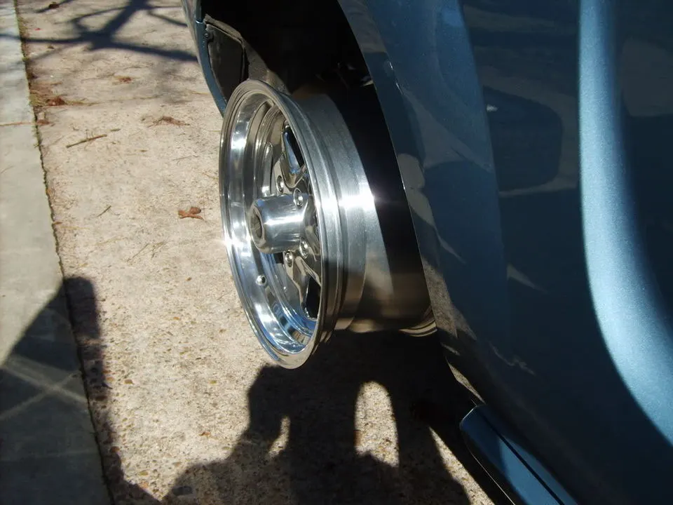

found out on another forum 15x8 jegs wheels with a 5.5 backspacing fit in the rear NO SPACER! or swaybar relocation! bolt right on!.
i'm ordering mine tomorrow night with tires. i was going to wait another 2 weeks or so but after seeing this i had to.
ordering these, a 275/60/15 m&h set of radials, and open ended lugs.
pictures are black05stxjts on s197 forum
