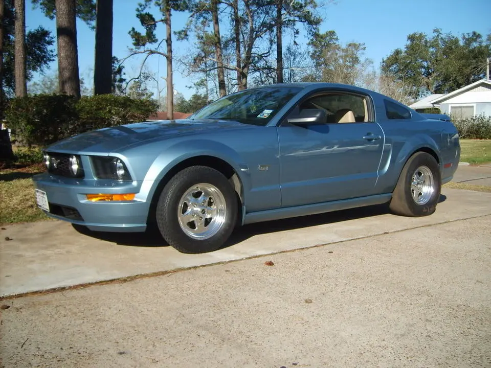

Here's someone with the fronts and rears.
