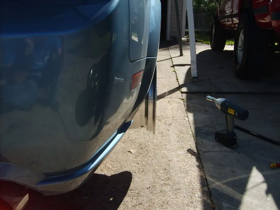

they do, but they take alot of messing with because of how the wheels fit with the stud. so i am grinding tomorrow and going to use a smaller spacer. i can get away with a 3/8. but i want to run smaller so it fits more flush with the back ones, which i don't think need any kind of spacer. edit just checked i guess they changed the rear and the front calipers. so the rear need a spacer, so i'l order 4 1/4 inch spacers, so i can run a smaller one up front and a small one in the rear so it brings it out more flush with the fender. since judging by the picture it'll be in a little.

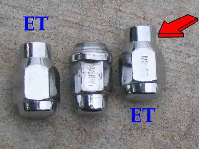

the ET style lugs should help prevent that, but they are a tight fit into the wheel so i am having trouble even getting them in the hole.
i definitely like the weld set up for lugs better, but what can i do for 90 bucks a rim. hah
those are ET style lugs if anyones wondering. i actually wish i could find a set of longer ET style lugs, because mine are probably only a 1/4 inch if that for that lip.

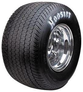

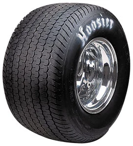

for a tire, i'm thinking of going with hoosier quick times. they are about 70 bucks cheaper then the M&Hs each. i'm thinking the white lettering may look pretty bad ass. what do you guys think?
if i had another 1/8th inch, the wheel would be perfect no matter if i threw it on and torqued it any which way. i dont know if i wanna run a half inch spacer though.
