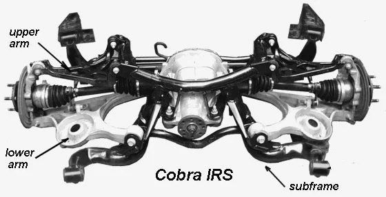

Ronald Jones said:
Griggs Racing and HP Motorsports both have a system out. When searching, try using SLA for Short Long Arm suspension. Also take a look at this site: http://www.miracerros.com/mustang/t_suspension.htm#Front
Dude, that is such an awesome link

I have the Maximum motorsport 3 link and torque arm setup on my 89 notch and it handles awesome. I would like an IRS its just too expensive to upgrade and Kenny Brown tubular parts take away 40% of the 75lbs added with the IRS. The problem is that you have to notch the rear frame which I think its alittle drastic.
