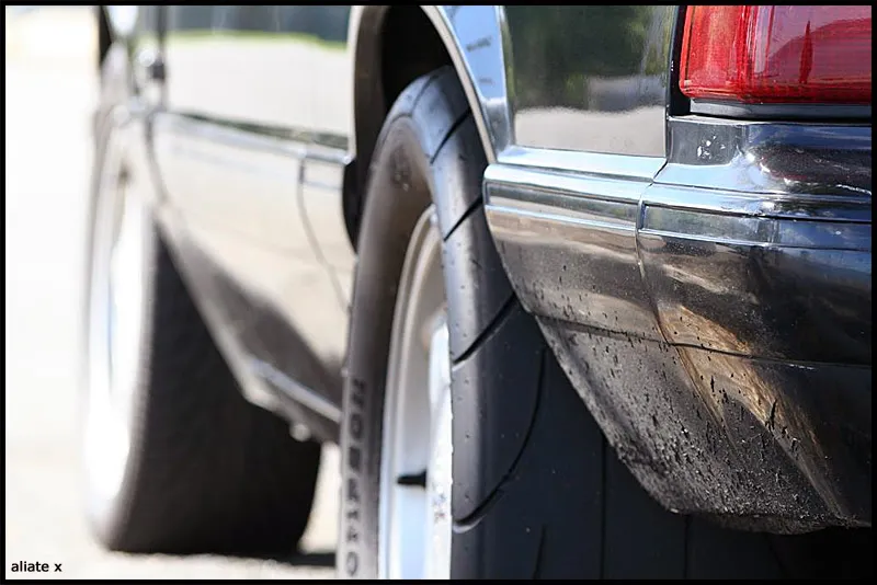

Ive had nothing but drag radials on my car for 3 years, and I daily drive it every day. I drove it through snow with MT ET radials, I put them on may of last year and they still have tread on them with burnouts here and there. The difference is night and day on the street, I will never put on a regular set of tires in the rear as long as I live. At the very least Ill put on nittos. Driving on regular tires is torture to me, nothing is worse than losing to a slower car just because of tires.
Ive never been able to blow the tires off without dumping the clutch on the street with the MT ET radials, it just chirps thats all, and yes, I murder people out of the hole with twice my power. My car was an animal out of the hole with just the 4.10s and a set of nittos. Traction is so much fun.

MT ET radials are wrinkle wall, and like I said its enough of a difference that you cannot force me to run regular tires on the street. Anyways tire pressure makes a big difference in wear pattern and traction obviously on drag radials more so than regular tires. I run mine at about 22-25psi on the street.

IMHO, the best overall drag radials your going to find that are capable in the rain are the Nitto's. They have far superior traction than any ordinary radial tire and will not be scary in the rain (and get decent mileage too). I'm currently on my 3rd set…and can't imagine the lack of traction I would have without them. I'm with Aliate X on this subject…never will she wear another pair of shoes out back other than a drag radial (for the street). :nice:
