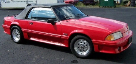

If you want the rear tires to be 100% under the car, but with maximum tire width you want 275/50R15's on 15x8" wheels with 5.5" backspacing. Quad shocks will have to come off. On convertibles (like mine) the inner fender had to be "messaged" a little and the tolerance was still too tight for my tastes, so I added a 3/16" spacer. Done. With regular radials it never rubs except for sharp, off camber driveways. 95% of the time it's fine. With DR's it rubbed going round corners at highway speed occasionally.
Up front I run a 15x4" wheel. Only comes in 1 backspacing. And I run 165R15 radial tires. The combo looks awesome. :nice:
Here's a pic....
