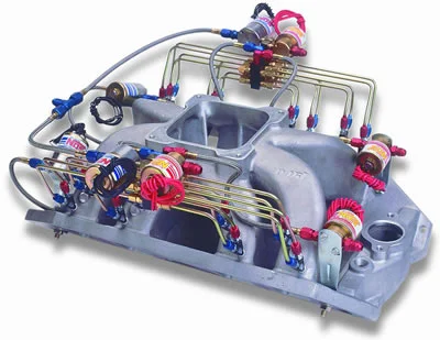

why go to the hassle of buying a new nos system + new intake when you can just get a direct port and skip all the puddling issues , thats what i did :D
Do you mean somthing like direct port fuel injection like the the old Camaros:shrug:, Please enlighten me? Seriously, I'm only familiar with having it put in from the top of the manifold:rolleyes:. Where else nearest the cylinders could it be injected:shrug:?
NOS used to have a system for the 4.6's, but I can't find it on Summit's website. But this is what he is referring to, but just picture the same setup on a 4.6 intake.
those direct port kits cost like $1000+...lol
yea but its complete with every safe feature there is and is cheaper than doing intake + nos because as far as i know , most complete nitrous run around 600ish and intakes aren't exactly the cheapest thing on earth , isnt your peace of mind worth that extra $100 ? just a thought :D
