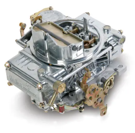

Starting at the top, as in too much CFM: Twin 1850's.....@ 600 CFM each. These are vacuum secondary carbs . Most of the time the engine will never demand more than the two primaries,..so in essence,...600 CFM.

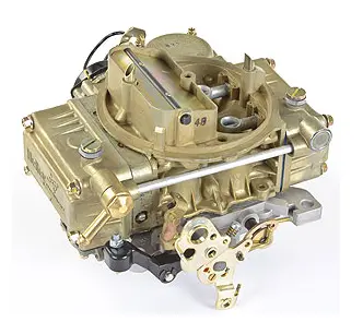

next,....8007 holleys 390 CFM....vacuum secondary,. x 2, running on primaries.....(guess how much total CFM) Just right CFM, but at 488.00 ea....too much money.
in reality, w/o the engine mods to back this up,...Multiple carburetors are gonna give the same vibe as a big giant crooked wing.
Buy a nice 4BBL Quickfuel carburetor, roughly a 650cfm. That'll be more than enough airflow and when people see it's a QF carb, they'll appreciate the aesthetics of that more than two dinky 2BBL's.
