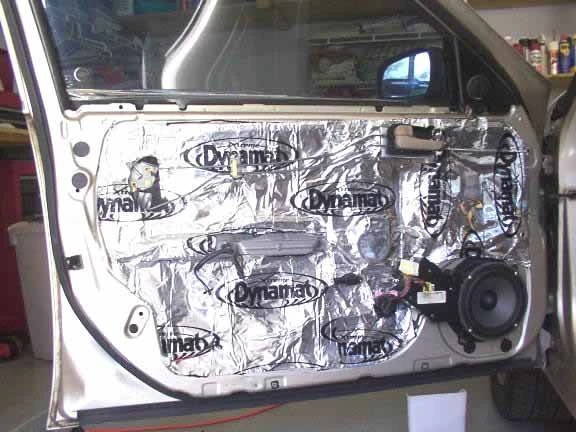

I covered it all...must have got something in the way, since my lock on the driver's side won't turn...see pic below, more on my webpage:
