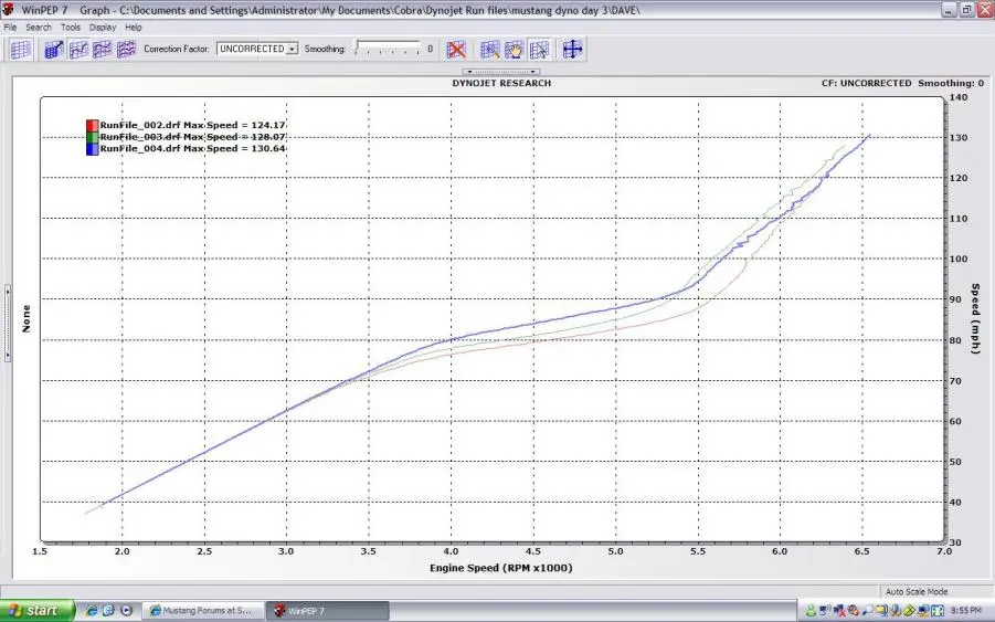

Sounds like a crappy dyno operator to me. I have seen cars with bald tires including mine have no problem "putting down the power" What was your final run?
William
Peak power was 630 @ 20psi which it should be making at 14-15psi. Dyno was done by Tim @ MPS in Bellingham, definitely not the operator. I knew getting onto the dyno tires were going to be an issue. Reviewing the run files I can see right at 4200 rpm where full boost comes on the rpm/speed curve gets really off course.
interesting about the tire spin :shrug: all 3 runs show the exact same thing, you would think with tire spin that the runs would differ from pull to pull where the tire spin starts and finishes at least some anyways:shrug:
Your tires completely bald?
William
They are pretty worn, it's definitely not the clutch as it is a new Spec 3+ and aluminum flywheel - about 1200 miles on that combo.
Boost comes on pretty hard around 4200-4500 and thats where the slippage is pronounced.
