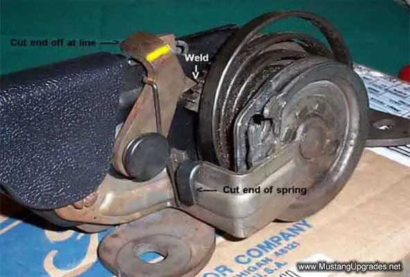

i seached and read a few thing's about this topic, but it didnt really help answer my q's?... my 1990 gt has a 5 lug swap all around... disc all around and cobra brakes all around... the e-brake handle is still intacted, but there is no cable... now that my car is put up for the winter i thought maybe if nothing else ill do that.. in a recent race at speeds of 125mph i realized i was having trouble stoping... so this question comes to mine, before i just go buy parts and try doin this, i figured i'd ask about what the complications are, difficulty level, tools needed.. and some basic input.. i know this fourm is good for that! i really want to do this my-self is that a good idea or leave it to someone that knows what there doin ?:shrug:

You need 3 Cables total, Ford Racing P/N
M2809A
M2810A
You aso need to pull the handbrake handle out so you can cut the spring, weld the Pawl, and fit the new Adjustable Center Cable. Instructions for the handbrake mod can be found on Ford Racings Web Site under the M2300K Kit.
M2810A is the center cable
