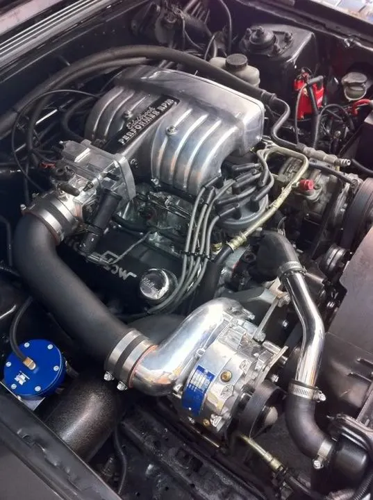

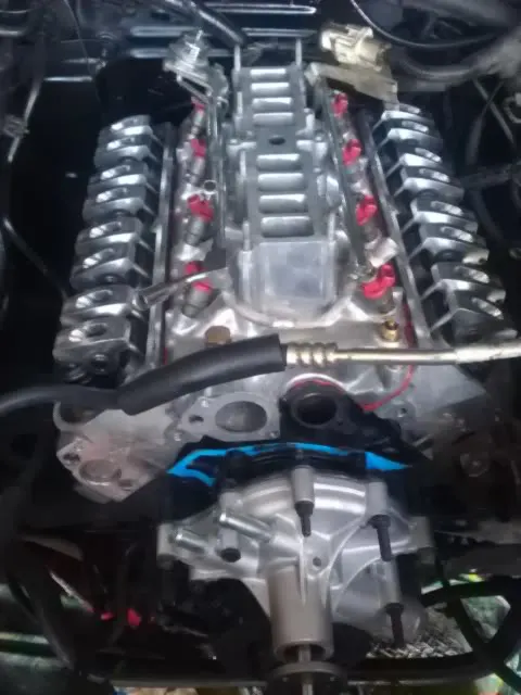

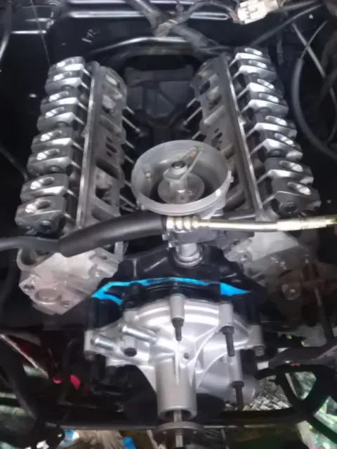

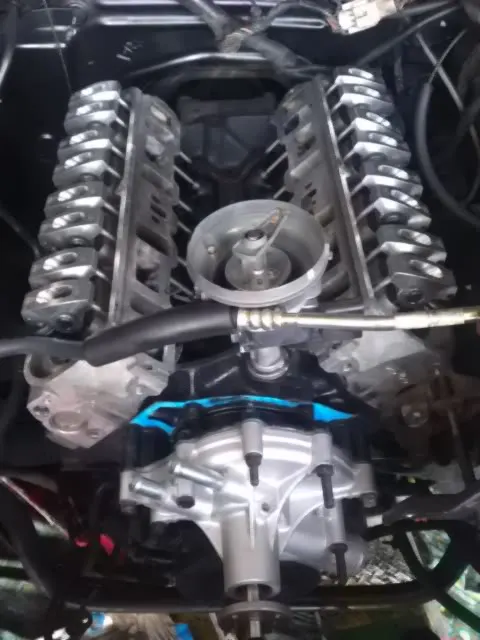

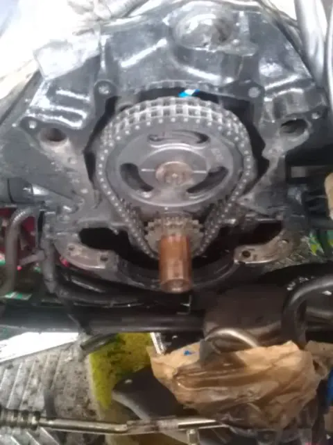

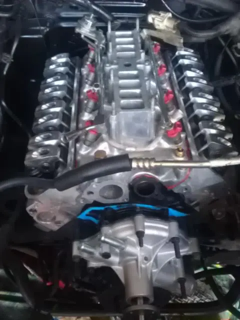

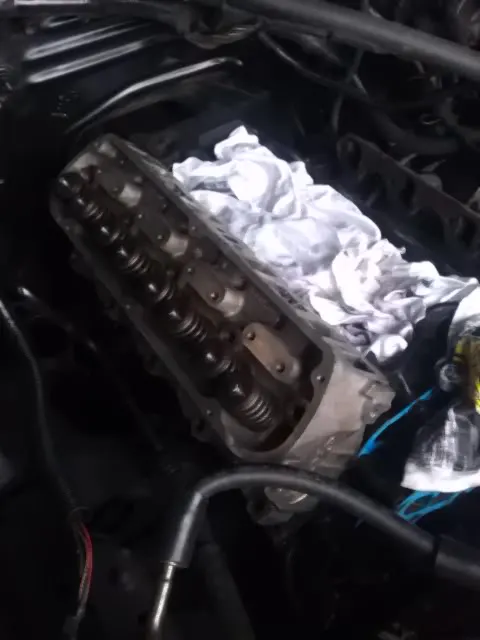

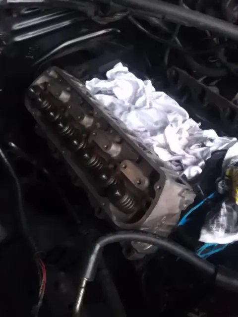

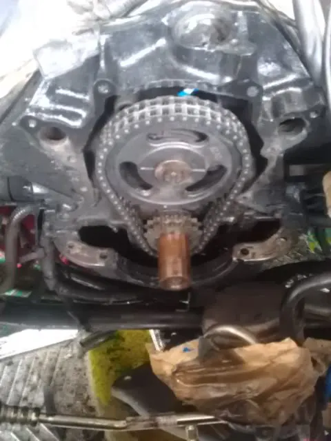

Here is whats on the 92:
GT40X Aluminum Heads upgraded to Ferrara Valves and Springs, $1000 new (can find these used for less).
Scorpion 1.6 Roller Rockers Pedestal, $219 new.
FRPP Pushrods, Under $100 new (can't remember).
FRPP Lifters, $119 new.
Rest of the combo:
TFS Stage 1 Cam
FRPP Double Roller Timing Chain
FRPP 30lb Injectors
Lightning 90MM MAF
Aeromotive Fuel Pressure Regulator
Walboro 340LPH Fuel Pump
RPM Intake
BBK 70MM TB
Vortech
