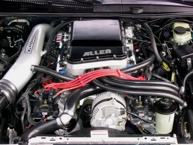

Don't let it's size fool you, the old Allen kits were giant killers. I used to have one on my bolt on PI engine '96 Mercury Cougar XR7 and it worked really well. Put down 343rwhp/389rwtq @9psi though a 4R70W and IRS rear end. At 4,200lbs, the car would run mid/high-12's all day long on drag radials. It also did so with stock PI cams.

Gearbanger 101 where did you get that intake tube, or is that a custom made one? If it is custom, what did you use?
