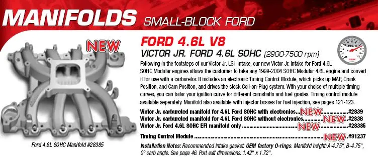

I FOUND A PICTURE!!!!
The picture is the EFI version. That means it's not a street piece. Carb version assumadly has no EFI provisions.
This is an edited screen shot from the 2006 catalog I downloaded from the Edelbrock website www.edelbrock.com

Looks like it needs one of edelbrock's competition 4 barrel throttle bodies.....along with their Pro-Tuner EFI system. I wonder if they are planning a stock replacement performance manifold.....in their performer or performer RPM series, instead of the Victor race series....
at the bottom it stated there are fuel injector bosses. hmm might be promising but it looks more built for carbs.
well they probably designed the carb intake first and then just did some slight modifying, with the addition of fuel injector bosses, and called it their EFI intake.
Hopefully this is just one of multiple products they will some out with.

I remember this now, It was mentioned in MMFF in one of the fall issues, hot new parts or SEMA coverage or something. Looks like its more of a street rod intake.
