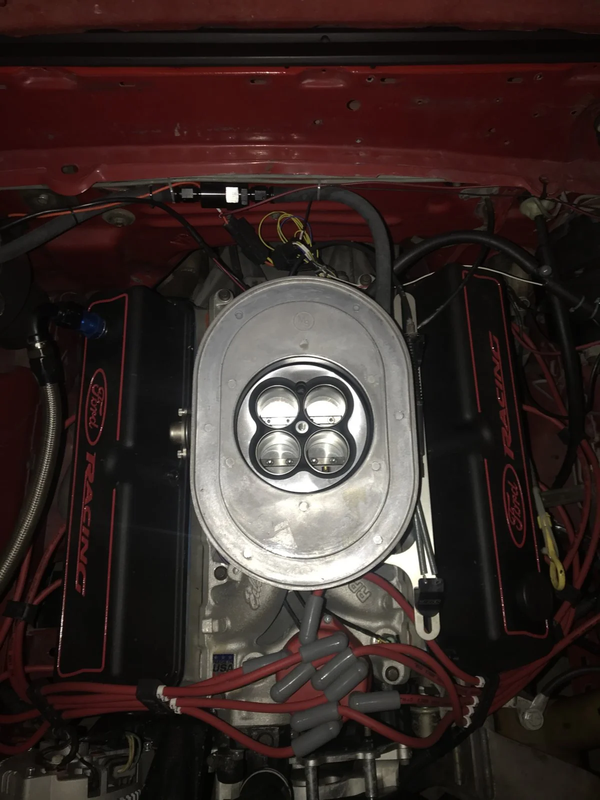

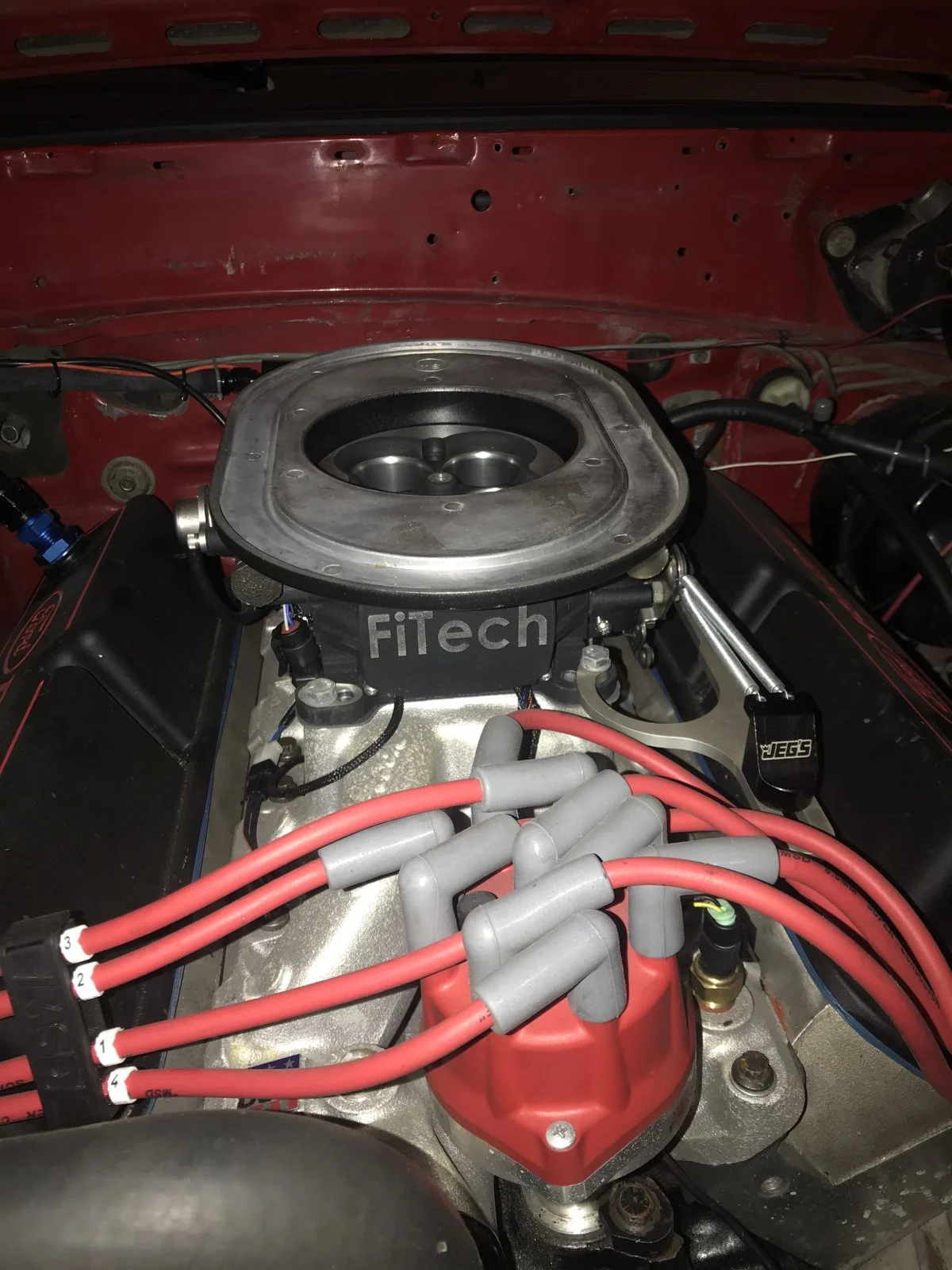

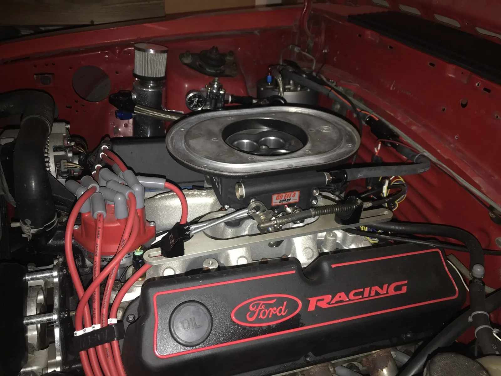

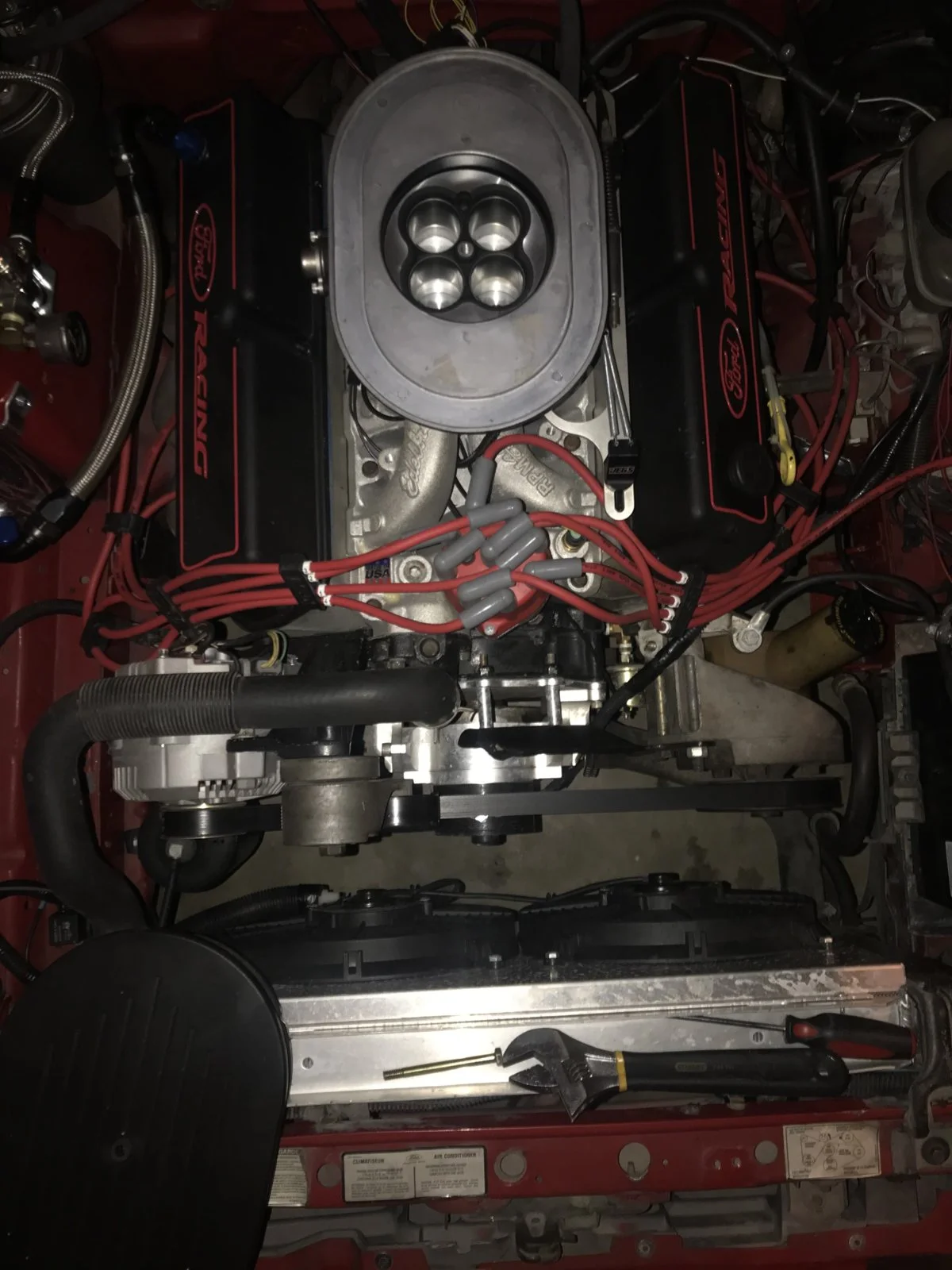

I currently have a Fitech efi setup, but I am wanting to get rid of it and go back to a true efi system with fuel rails, etc...What do you guys recommend? Looking for something that isn't too expensive, but will be a performer. I have pulled many gt40 intakes from salvage yards so I know that is always an option.
My current setup:
331cui stroker
Anderson N-91 Cam
Edelbrock RPM Air Gap
Ported Trick Flow Twisted Wedge heads
My grandfather built the engine and I remember him saying the compression was close to 11.5:1 compression. He has recently passed away so I am not too sure on what the internals actually are.
Any help is much appreciated!
pics have been posted just in case something grabs your eyes for recommendation and also some attention lol

That’s in Systemax, or RPM 2 territory. A gt40 would choke that combo a little bit unless it was ported. Why do you want to switch?
I really just want to get away from this Fitech, I have had nothing but problems with it. I have also seen so many problems from others about the system as well. If I was running this car at the track, I would have no problem throwing a carb back on it. I just want this to be a reliable street car and so far this Fitech hasn't been that.

Systemax intake is kind of top dog for a street-ish setup. Of course I know nothing About the car, but I’d guess it’s got some decent gear as the n-91 is a pretty stout cam, at least as far as ots stuff goes.
A victor efi intake would run well, but the box R is also very good for a semi high winding engine and requires no porting at all. The only problem some have is hood clearance.
