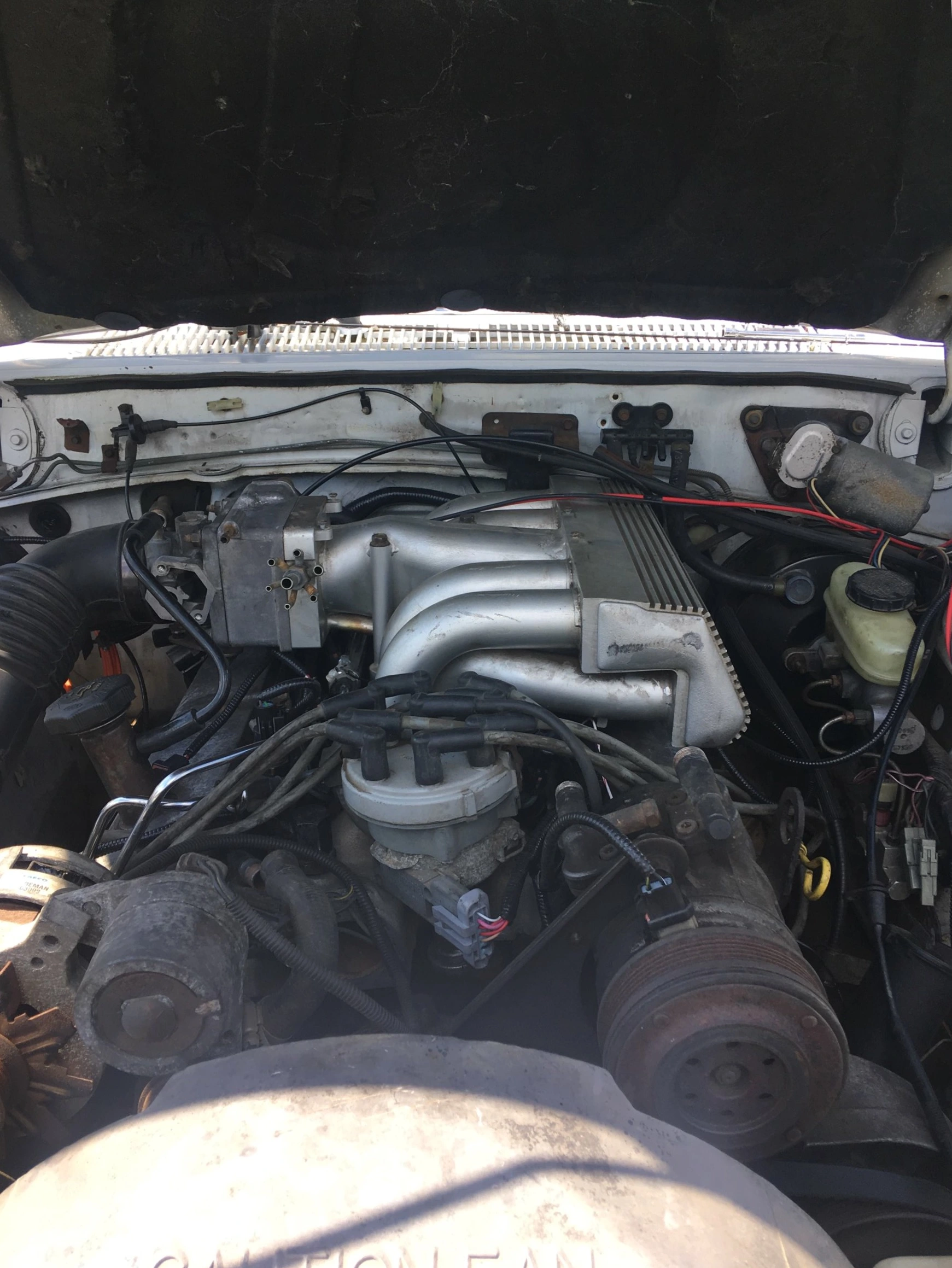

Alright. I am just trying to plan ahead. Who amongst us has successfully completed this swap? Chime in with any problems you ran into or parts you had to buy, etc. I ask because this is the next step for the Daddywagon. I just about completed the installation of an efi 302 from a 1986 mustang gt into a 1985 Ford LTD foxbody station wagon. I used Ford's M-12071-A50 harness. The computer is A9L. The meter is Pro Flow(?) calibrated to 24lb injectors. The car starts and runs. Now that I am so close to driving it the time has come to build and install a 351. Thoughts?

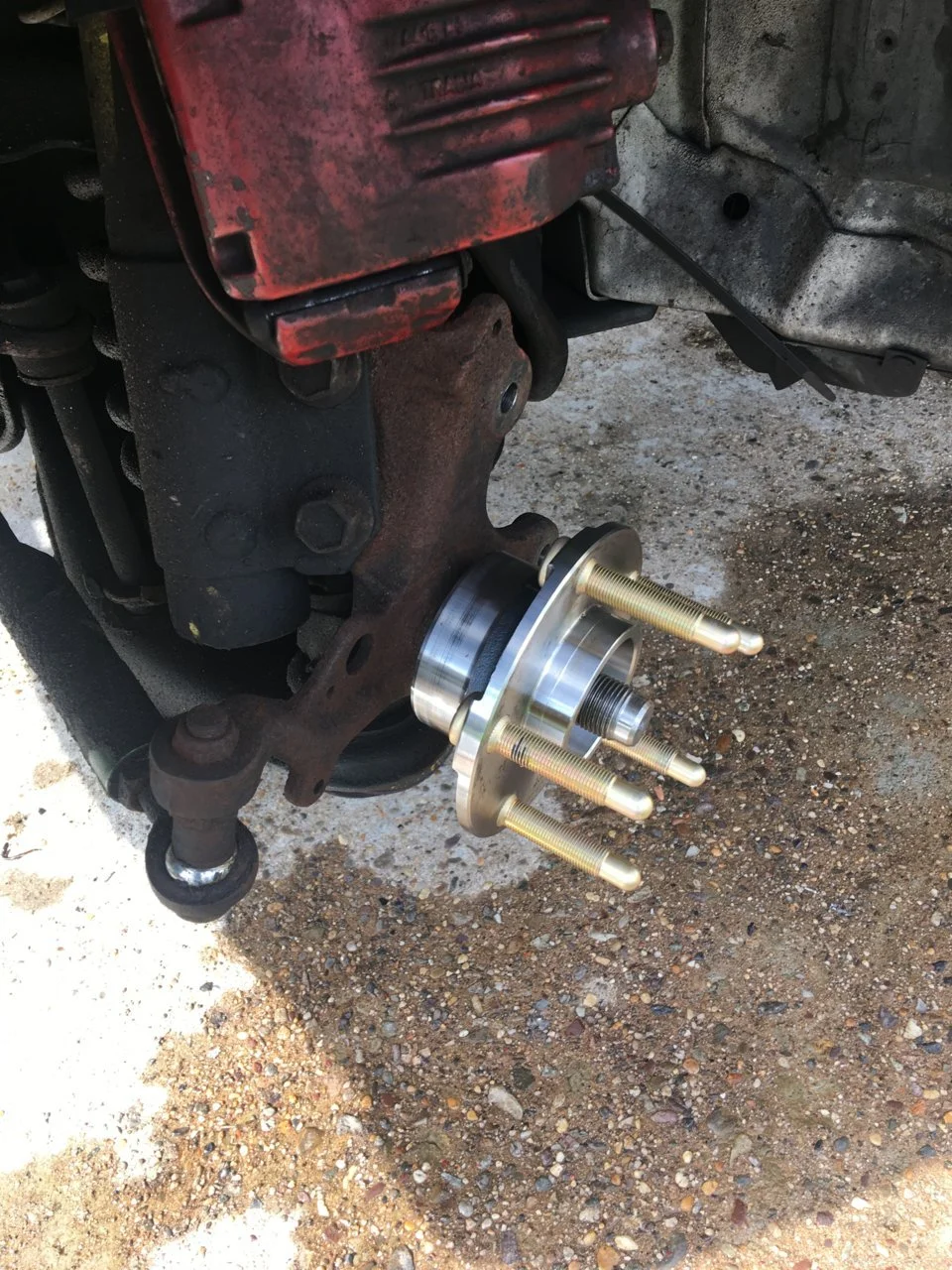

This will be my Stangnet Daddywagon thread. Latest, has the daddywagon needing a different mount setup for front wheels. Up until now I was running 25mm wheel spacers up front which bolt to hub face and have studs pressed into the spacers which mount the wheel. This was necessary because of the deep backspacing of crown vic steelies and clearance for cobra brakes. Studs are failing on both sides. I am going to reduce the spacer width to 1/2 inch and use longer studs.

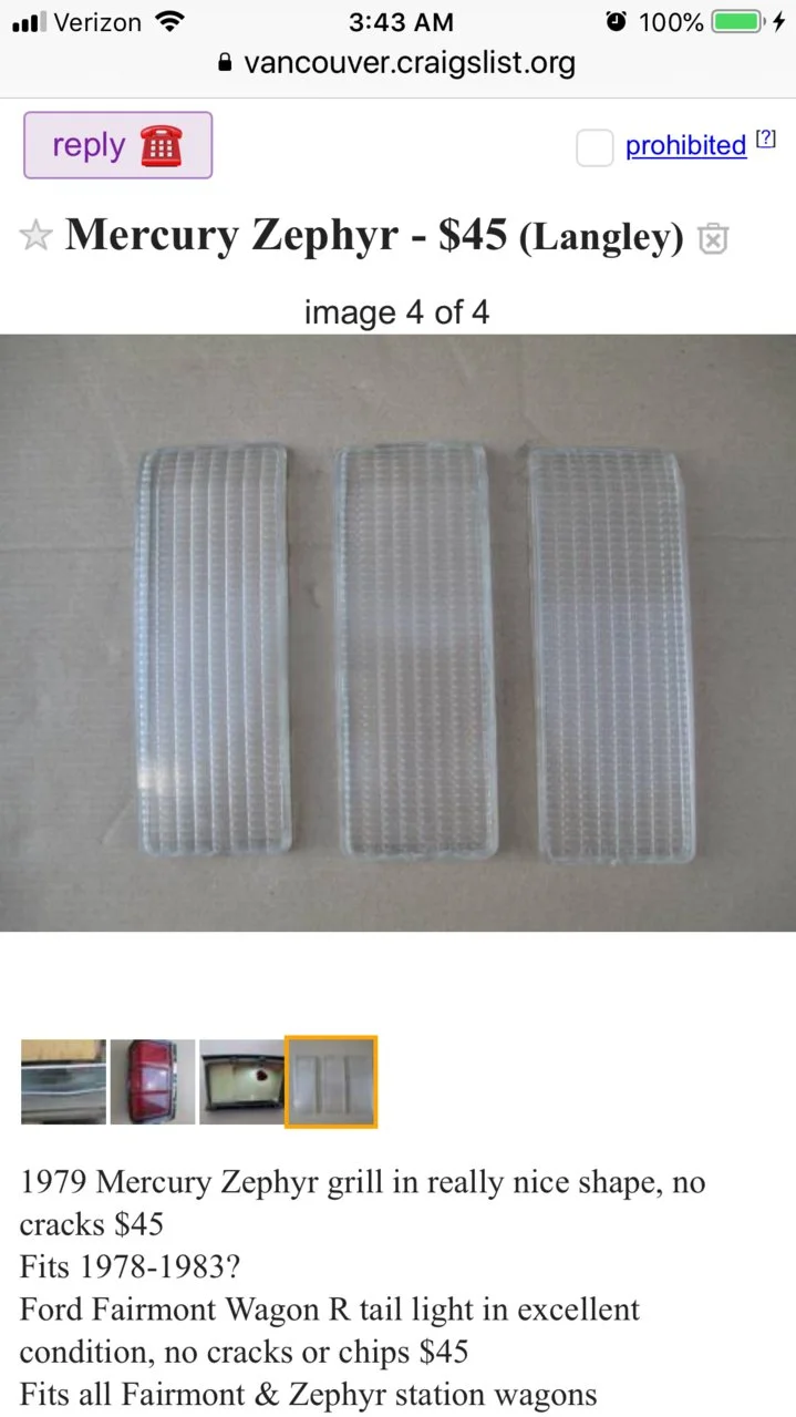

There are no reverse lenses on the wagon because they fell off a long time ago. But I found a craigslist ad from Canada and sent a postal international money order to Canada to buy someone’s stash of three reverse lenses! Thanks Doug!
