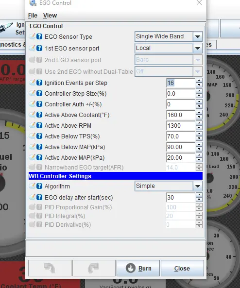

Looking for help/option with settings on megasquirt pnp ego control tab... The picture attached is default setting on my setup. Just surprised not adjustment below 160 degrees.
89 mustang 302 with b cam...

Set the adjustment so it coincides with the wue ending, 160* is normal as most efi engines run at 200* under running conditions.
Run 5-8% authority settings in advanced mode
P=45
I=20
D=3
Give this a try and see how it does.

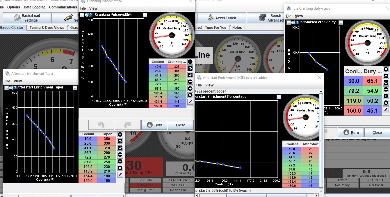

I am without a PC right now to look at logs. Bump the cranking pw slightly and see if it helps, if it persists slightly increase the ase% (3-8%) in the temp that the issue is occurring
Rinse repeat until you get the start you want.
sounds good... we actually reduced ASE a few test tunes ago thinking it was to rich. screen shot of a few settings.... thanks for your help and advice!!
We will keep you posted on next cold start.
