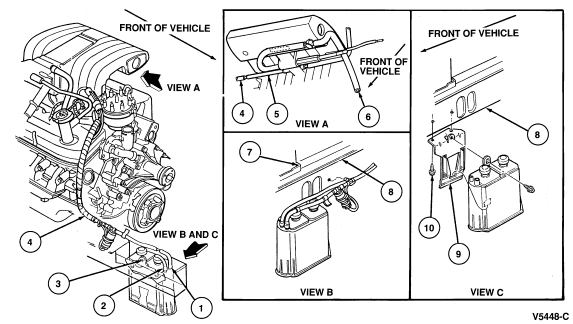

Mustang5L5 That is…until I whipped out my Bissell Mod Dude Feb 18, 2001 43,355 18,097 224 Massachusetts Apr 14, 2021 #21 Apr 14, 2021 #21 There is an extension harness that plugs into the plug next to the ECT and runs down to the purge solenoid on the fender.
79pace something stupid will fall out of my mouth Founding Member Jul 21, 2000 239 31 38 Tulsa, OK Apr 14, 2021 #22 Apr 14, 2021 #22 Ok, I found that diagram earlier. That makes more sense now. Must be missing the extension piece of the harness. May have it laying around somewhere. I will check. That is what was confusing me.
