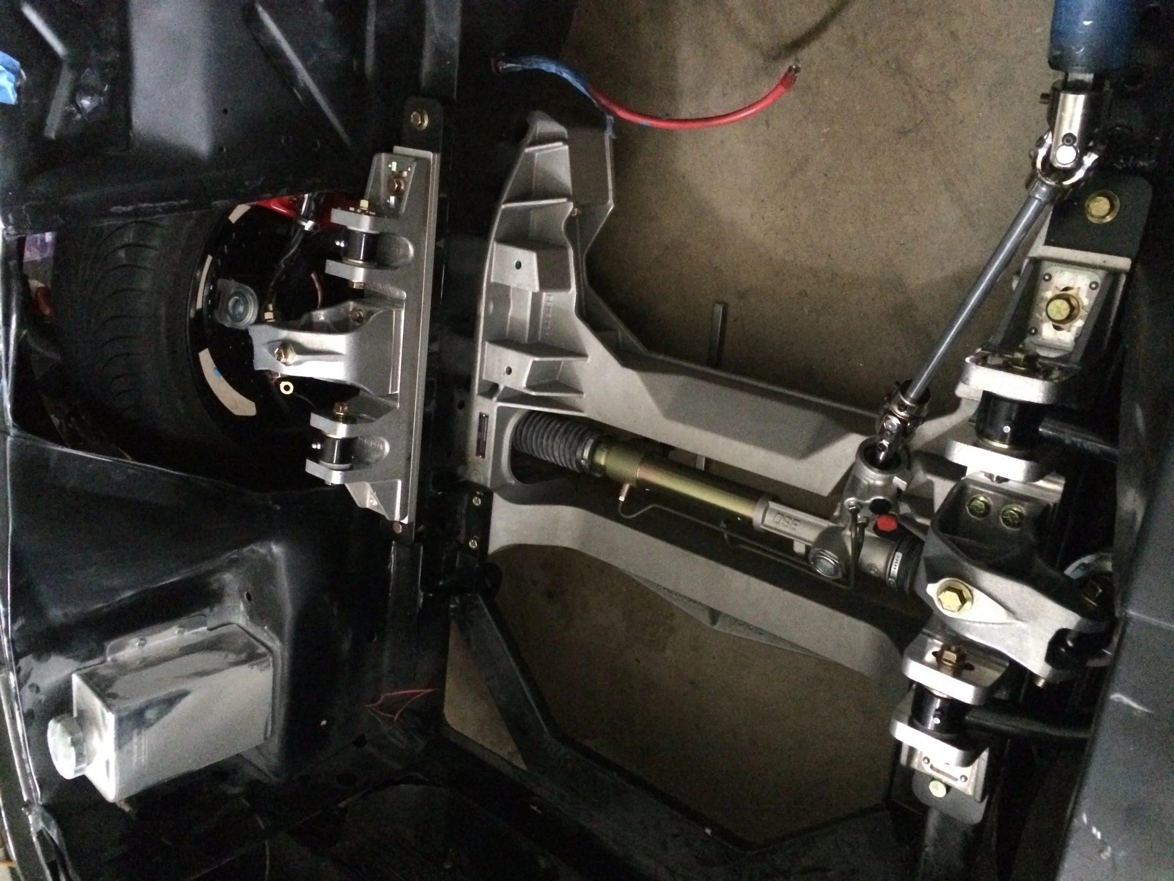

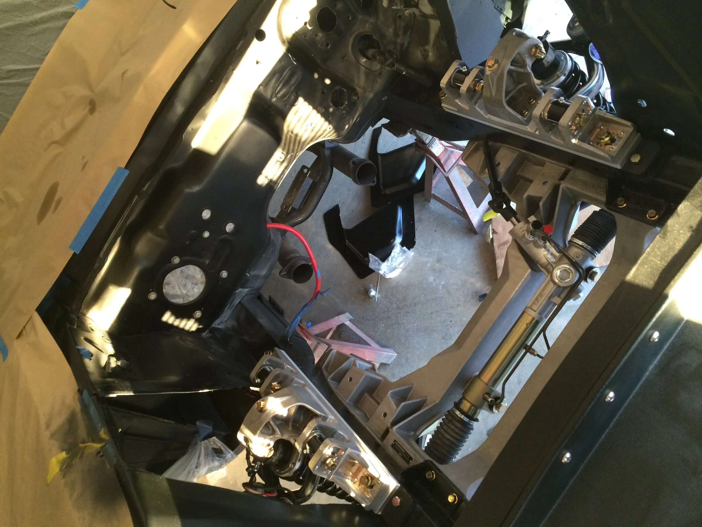

First attempt at loading up pictures . Do I want to choose thumbnail or full image guys?

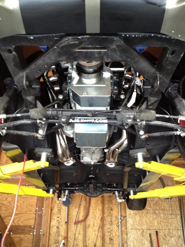

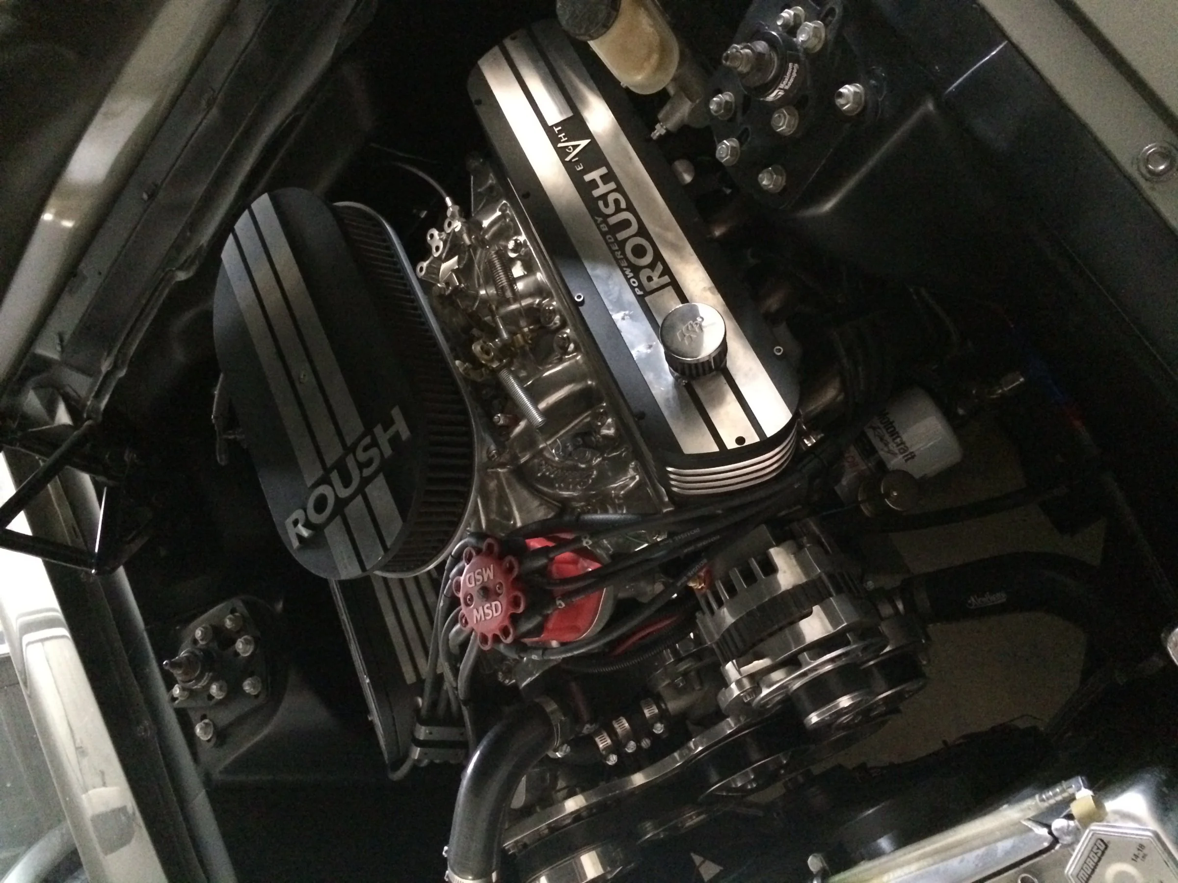

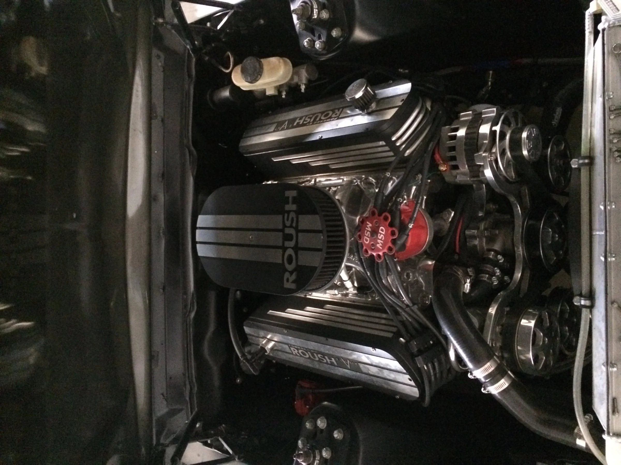

This is the old set up! I was happy with it but eventually you have the need for more. Then you will be able to how I eliminated the shock towers completely and installed the Alumaframe . Awesome piece!! This is where I currently stand.
Why are my pictures posting not upright??
Reactions: FoxMustangLvr
Cell phone pictures tend to post sideways sometimes. Your old set up was really nice!
