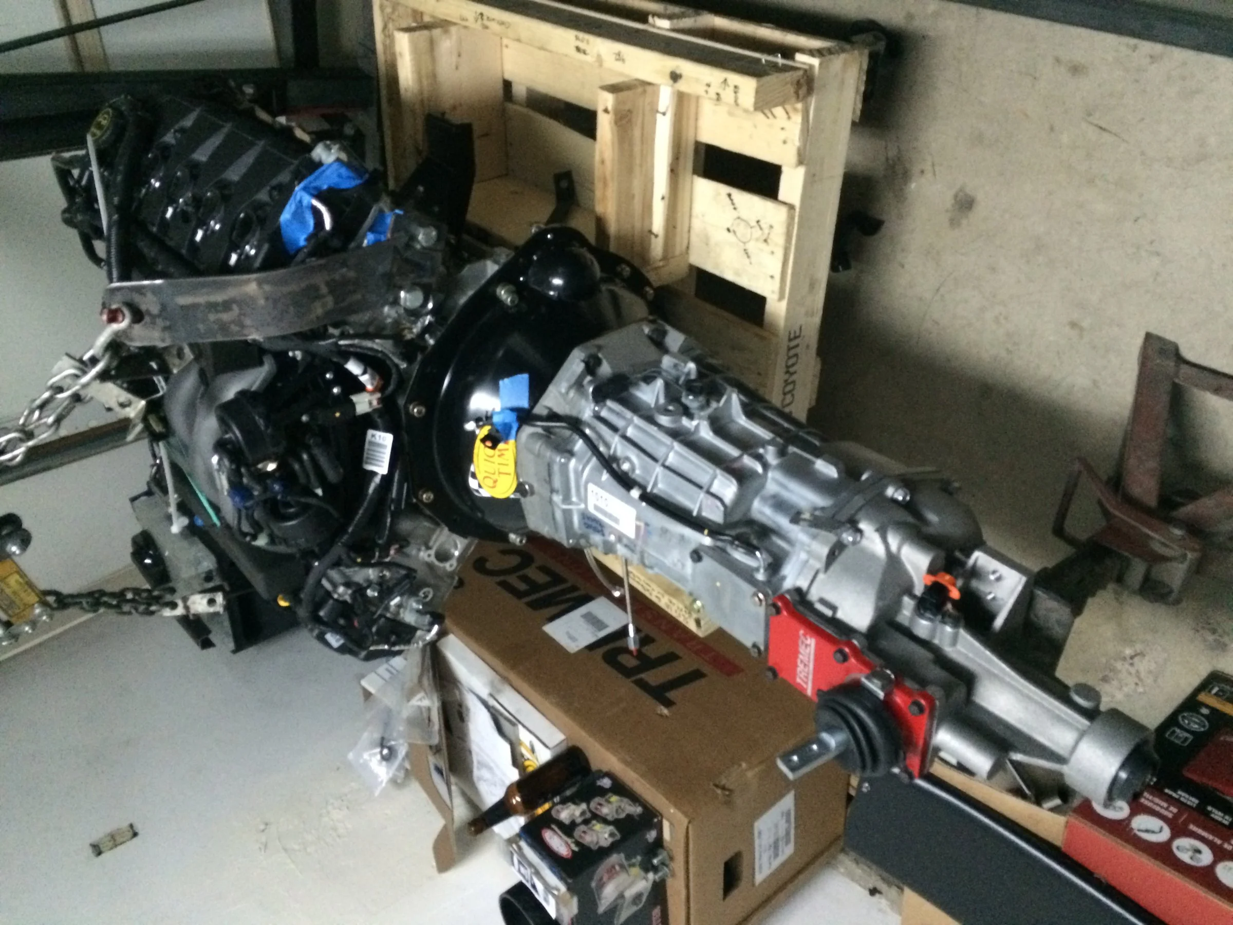

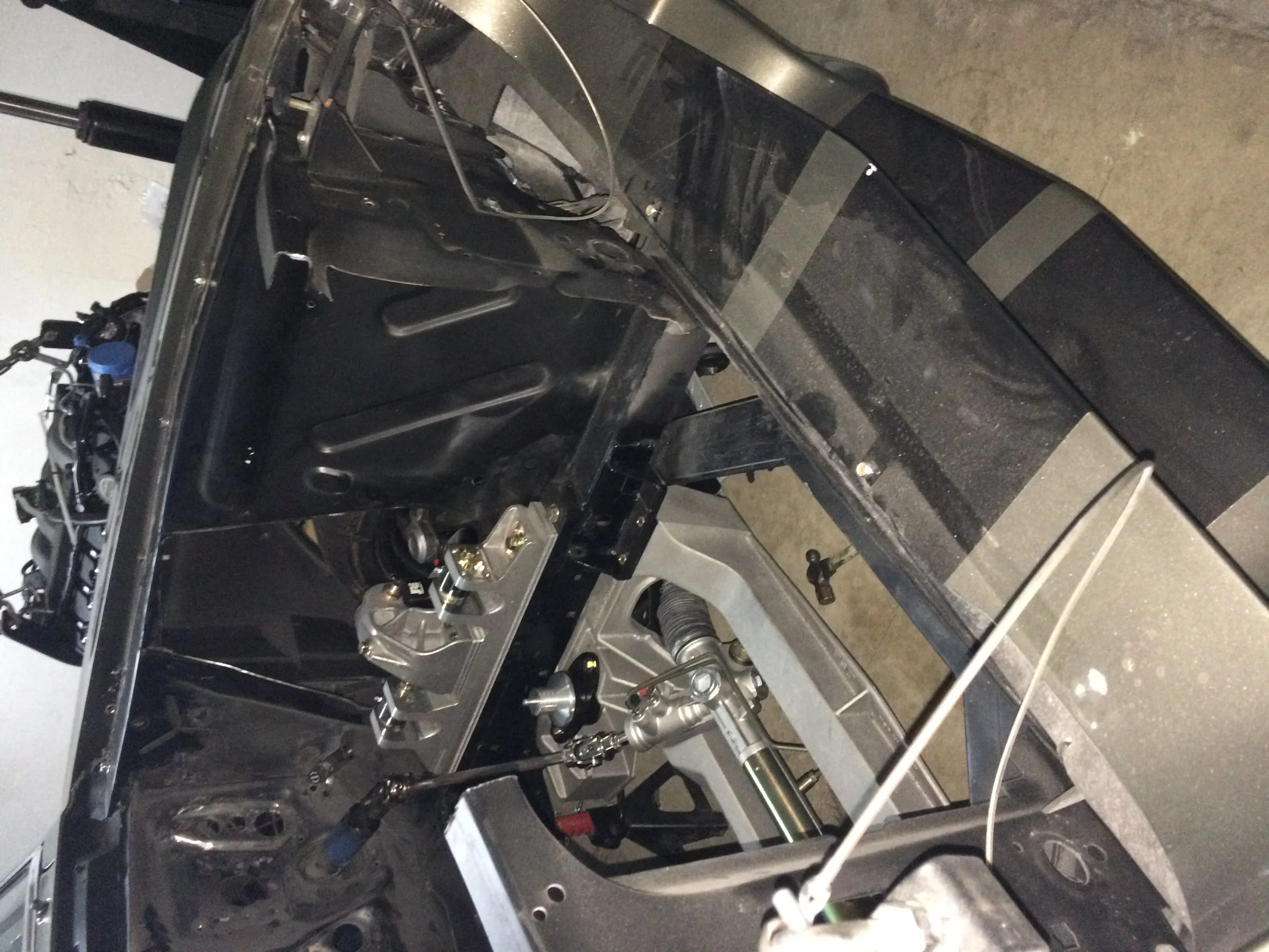

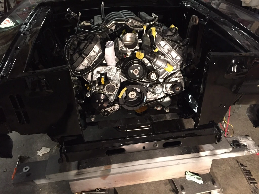

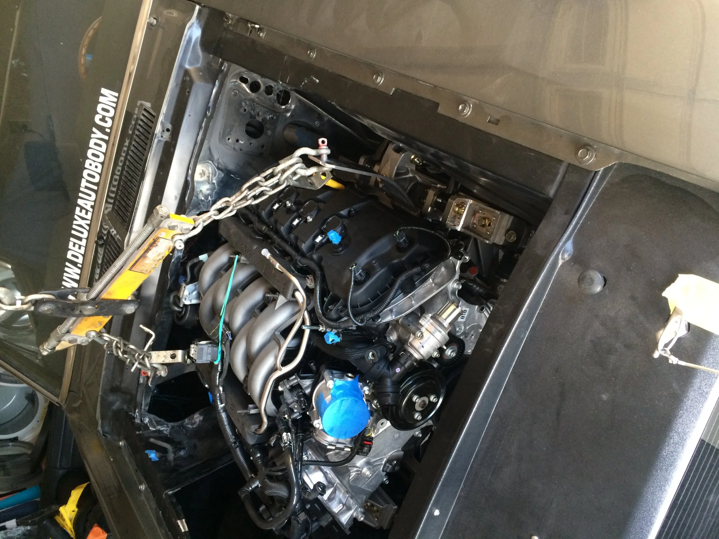

So just an update guys. I put my Trans and engine together and test for it. Good news is I didn't have to cut up my trans tunnel ...... That much. No extreme mods going to happen there. I had to cut the top part of the core support for easier install with the engine and trans complete. Which is ok I'll be making it a bolt on piece from now on. I also started installing the Morris Unicrossmember and the issue I'm having with this is the TCP x-brace I have is attached to the location that the crossmember goes too . So I have limited amount of room I can slide the crossmember . It's not THaT big of a deal BUT the crossmember touches very Little on the tranny. I hope this won't cause vibrations transferring over to me in the car. I'll have to figure something out. I'll get a picture as soon as I can so I can get some imput on what I'm talking about.

I do have one concern about adding this much power and my concern is where the trans crossmember bolts to the Torque boxes ..... If that's what they are called. I plan to have around 700HP to the crank . I wonder if those will hold.

Guys I'm curious if any of you would kno......... I have the Ron Morris crossmember and it bolts to the floor supports. I have plans to go around 700hp . Will these floor supports be able to handle that much torque?

I called 1800 fordSVT not sure if it's the same people @89oem ? These guys told me that the bolts that go to the block are 8mm x 1.25 thread. They also told me the ones for the Pump to the bracket should be the same but I very much think NOT as they clearly need to be longer. But I think that won't be to hard to figure out. As of now I'm looking for a good Reman- power steering pump . Any one have suggestion? I have found plenty but It would be ideal if I get one that someone had first hand experience with. I bought a rack before that was reman and it failed soo....
As for the floor support mounting location for trans crossmember . I talked to modern Driveline which by the way are good people to do business with! They are extremely helpful and I would recommend them. I digress ..... They said The Trans mount is for rotational torque and stability.
The body will twist before you see issues with the mount or crossmember.
Definitely recommend sub-frame connectors if you don't already have them.
Biggest thing is to make sure all bolts are torqued properly. also the motor mounts are going to limit twist as well. I assume.

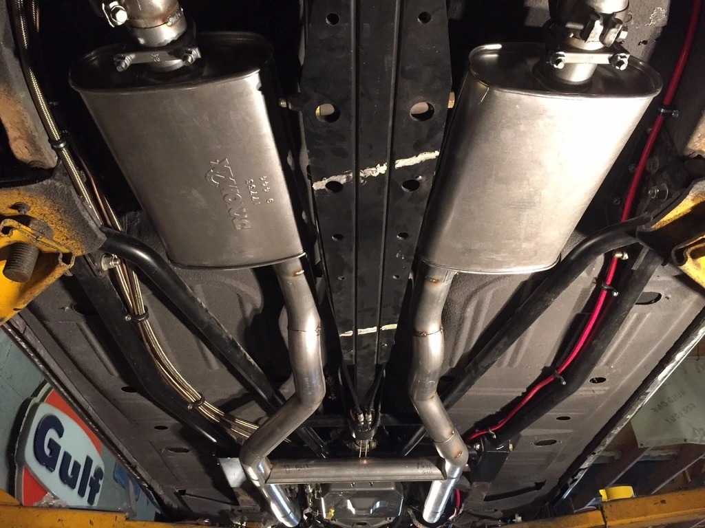

I run a QT bell, BBK LT for coyote, 3" Bbk X w/cats, Dynomax ultrafows 2.5" SS tails
We custom fit the 3" X pipe to the muffler by changing the lead side muffler knuckle connection to 3" Works great.
The BBK LT are tight around the QT Bell, Mount the bell before the headers and install setup into car as a unit. It was a bear getting it on after and we had to basically unbolt the headers to fit the bell in.

@89oem do you have a part number for those bbks? And I'm assuming the collectors are 3" ?simce u have 3" pipping . I was looking at a set of bbks but it seems like they come with some other bolts so I'm not sure if I'm suppose to remove the threaded studs on the engine now.. Also thanks for letting me know to install them the way you did. Save me a headache. I should have enough room in there to install the motor/trans and headers all intact . I had to cut the top part of my radiator core support to do so but man is it a easier install this way.

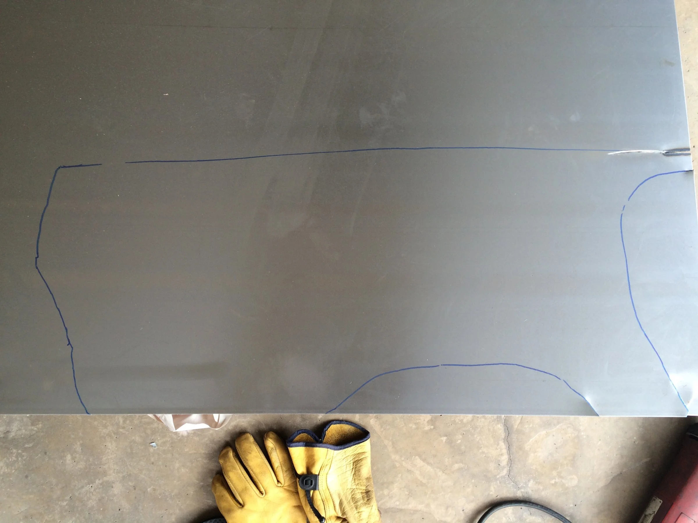

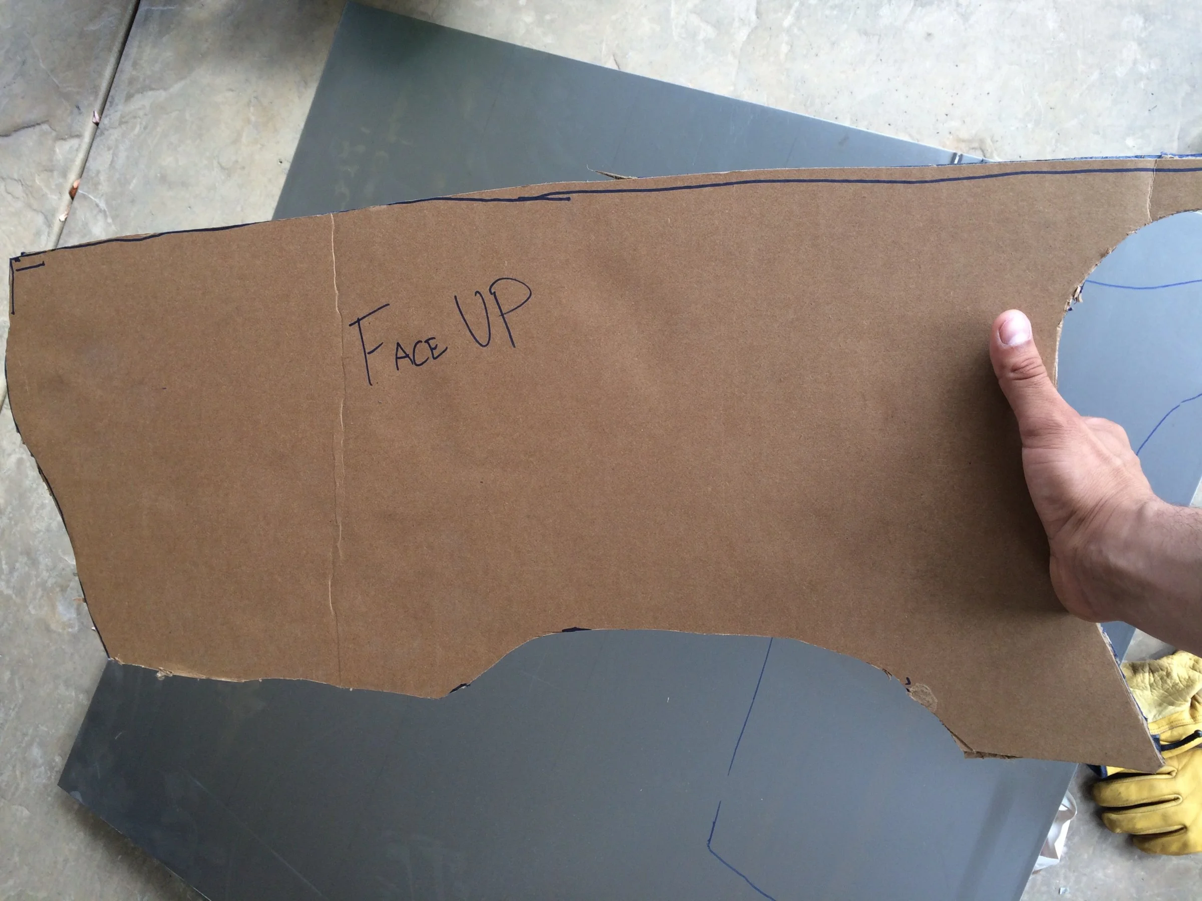

Last night I started to make a template for the sheet metal I needed for my firewall. I started to cut it with a die grinder with hopes it would cut it decently and I didn't like the way it started to come out. So I took out the tin snips . Didn't like it either. I'll be taking it to the metal shop where I bought it to have it trimmed .
