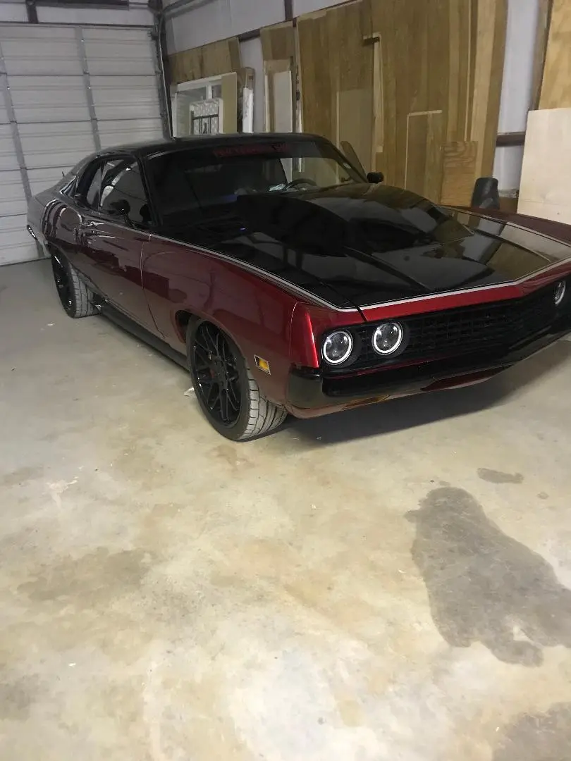

As of right now I have managed to get everything mocked up and fitted. I never was able to find a smaller Alternator so if anyone has a site in mind it would be very much appreciated if you can post a link. So it's at a shop getting Custom headers made for the time being. Sorry haven't done much to it since I moved and had some other things in my plate. So that's where I'm at right now. I got the whole wording done with quick releases so the trans and engine can be pulled out with out any wiring making it complicated. Happy holidays and New Years to all! I will post more pictures when I get the ball rolling again .
Ok guys after so much time passing due to personal issues I finally got to the part here I turn the engine over and hear this baby start..... problem is ..... it cranks but doesn't fire. Hooked the computer up and it doesn't seem to be reading RPMS or reading the accelerator pedal. Also when we go to crank it it starts to dump fuel thru the headers on both sides. This is a coyote crate engine with a Ford power pack system. Have any of you guys had this issue? I'm thinking for some reason the injectors are stuck open? Maybe they are dirty? It's a brand new engine .
