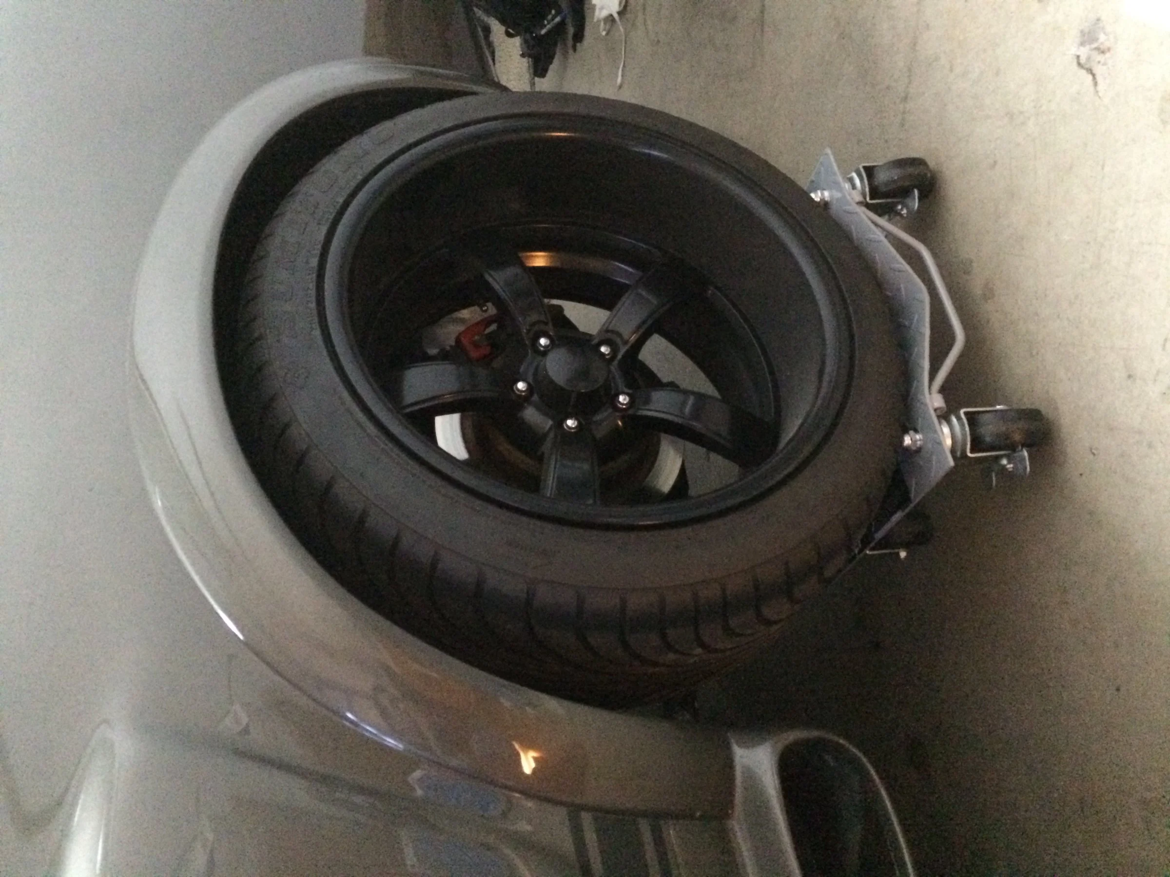

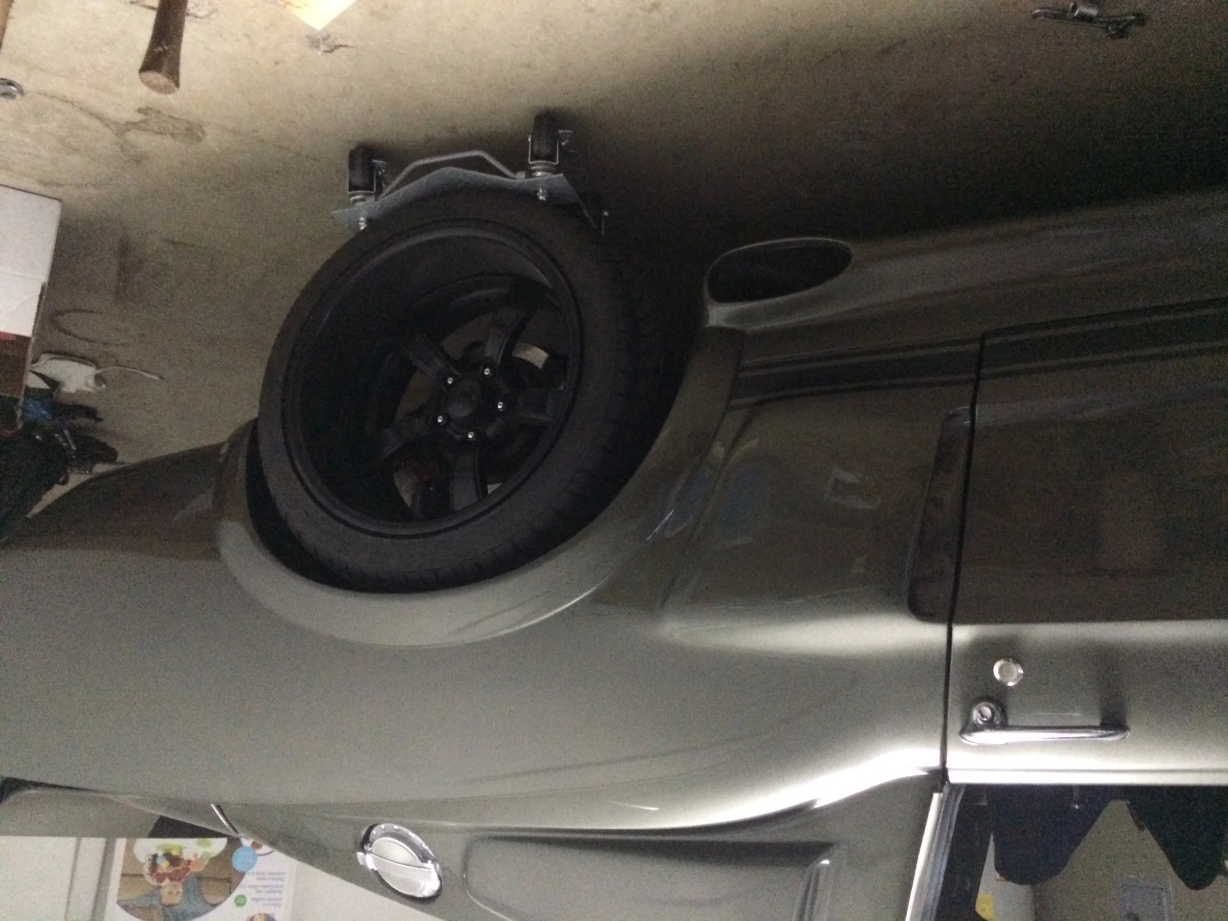

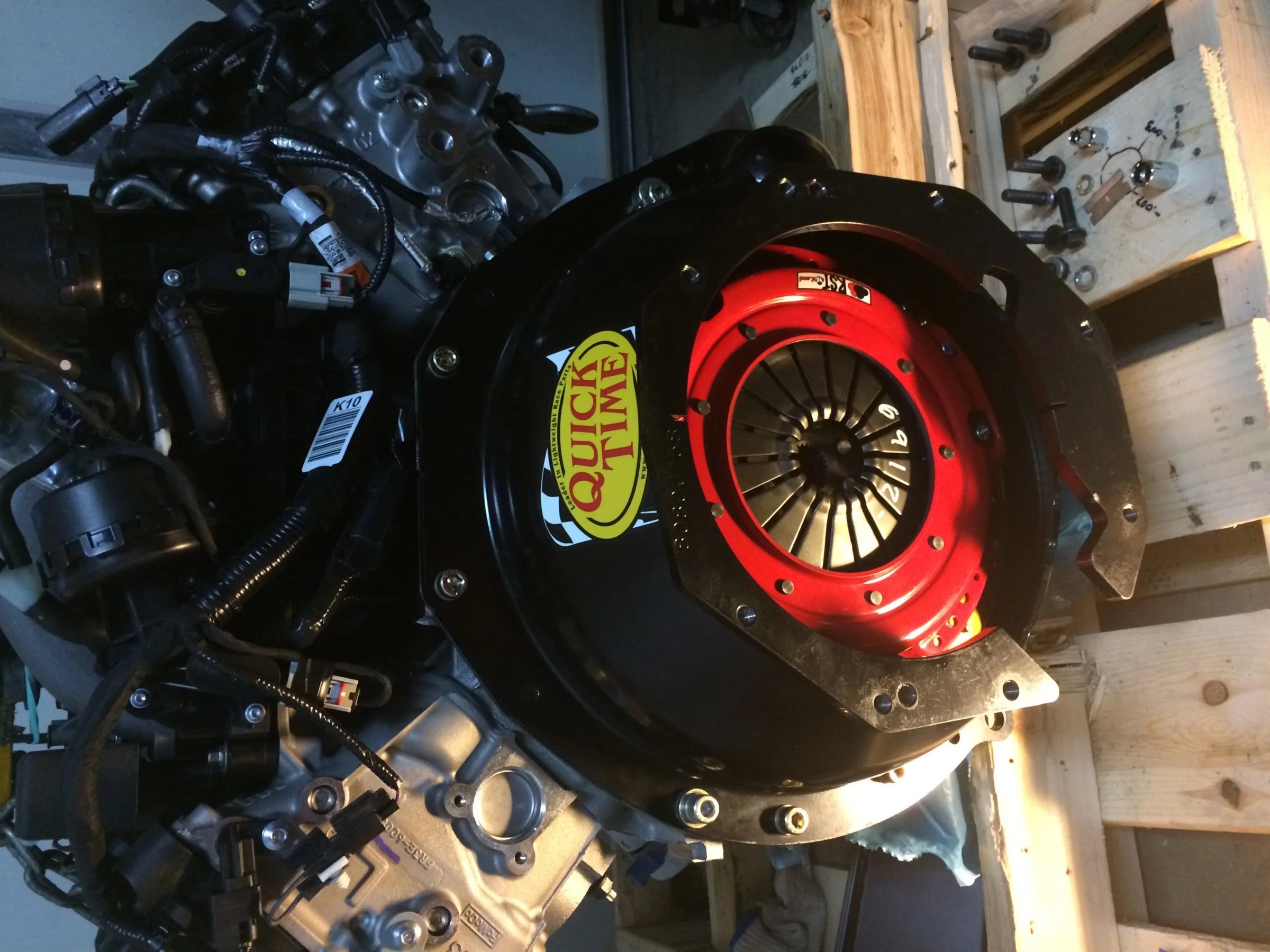

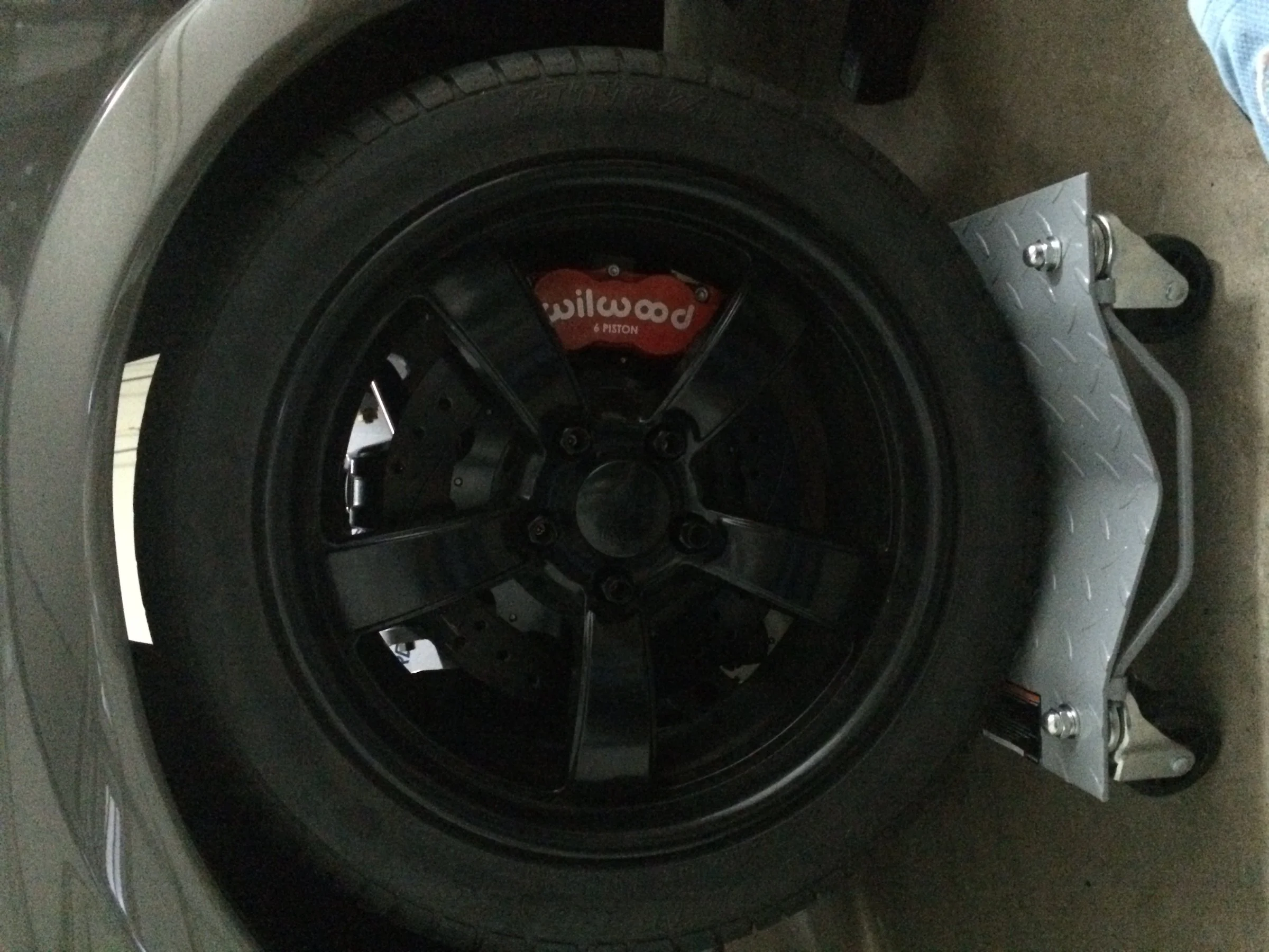

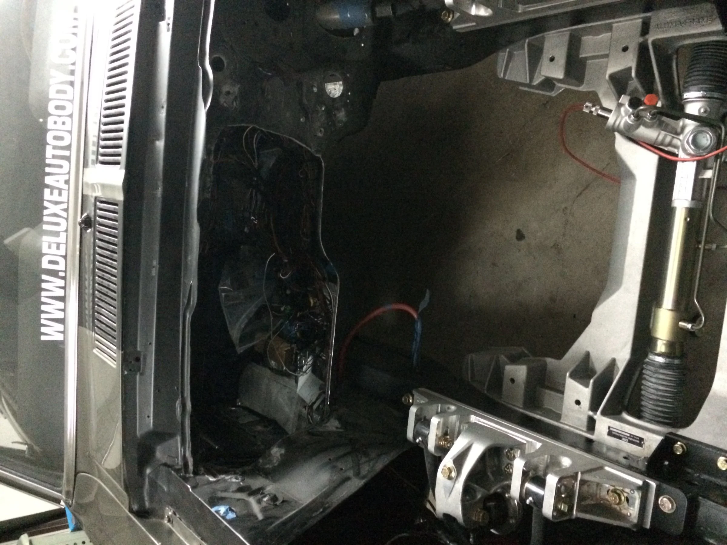

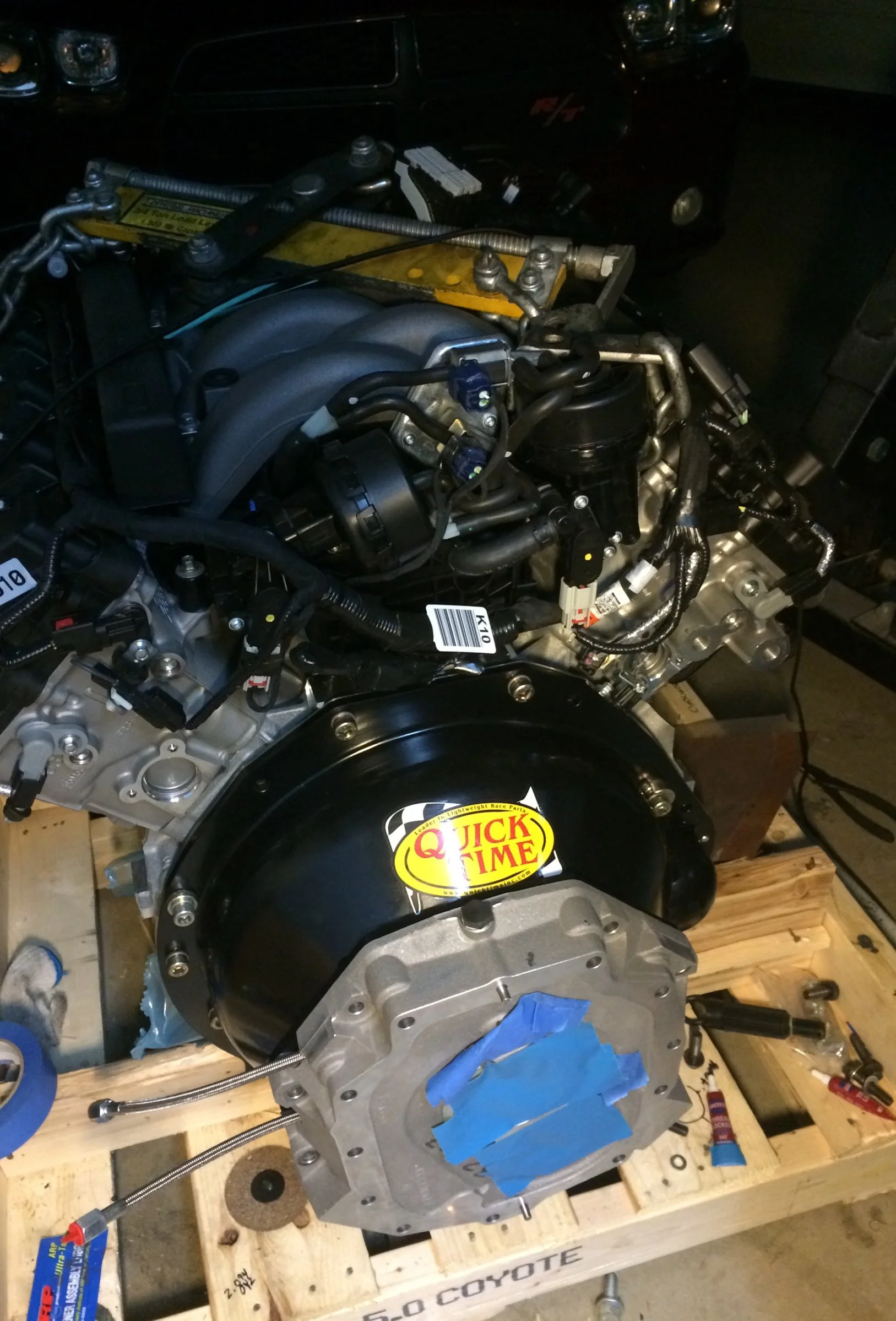

So guys I managed to get my clutch in ,bellhousing ended up torque to 35ft lb as per QuickTime instruction , finished up the Wilwood big brake kit in the front..... Matching rears in the future . Had a busy day but I finally stopped procrastinating and bough my self some wheel dollies and I love them! My garage isn't all that big so it helps . Due to my new front suspension I'm using spacers for now because the wheels hit the bump steer and way to close to the calipers. Sooooo I will be getting same wheels but with a 3" lip and 18s to help clear any issues. Currently I'm running 17x8.5 front and 18x11 rear. I wish I would have just gone bigger in the front with a wider lip for the more aggressive look but hey we live and learn. A couple pics . I wished I would have started this thread when I first got my shell on wheels.

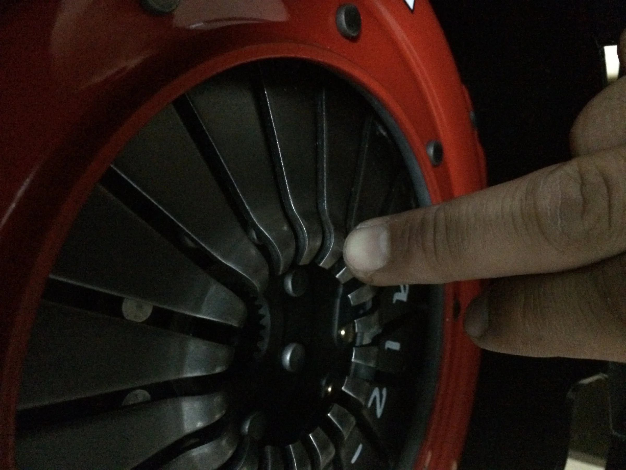

I was going to proceed and install mate my trans to the engine BUT I hit a bump! :bang:Once again! I'm measuring from the face of the bellhousing to the fingers of the pressure plate. It seemed like I couldn't get an accurate reading because when I would measure a different finger it would give me a different reading. Fluctuation between .012 thru .090 . So am I measuring wrong here?!! I'm using the highest point of the finger. I'll attach a picture showing where I'm measuring from. I thought maybe I torqued the pressure plate bolts wrong somehow so I re did them. Star pattern with first being tightening them till they where all evenly snug then I started to torque @25ftlb then star pattern once again to @35ftlb as instructed on the McLeod instruction sheet. This did nothing different . Again!! Numbers where not the same. On top of this I have to machine the chamfered spacer I got because it's too tall and it makes the Throwoutbearing touch the face of the pressure plate fingers . I need to trim it down so I can get the recommended .125 space. I'm done for the day I believe I need to feed my body.... I get to into it sometimes and forget :nonono:

I'm using a Tiltin TOB 6000. So I think I have it figured out. So it sounds like it's normal for the fingers to vary in height which mine weren't extremes . I'm talking with in 78 thousands . not very much I'll say.

I wouldn't worry much at all about the pressure plate fingers not all being in the exact same spot. Once the smallest amount of pressure is put on them by the TOB, they will all be lined up properly.

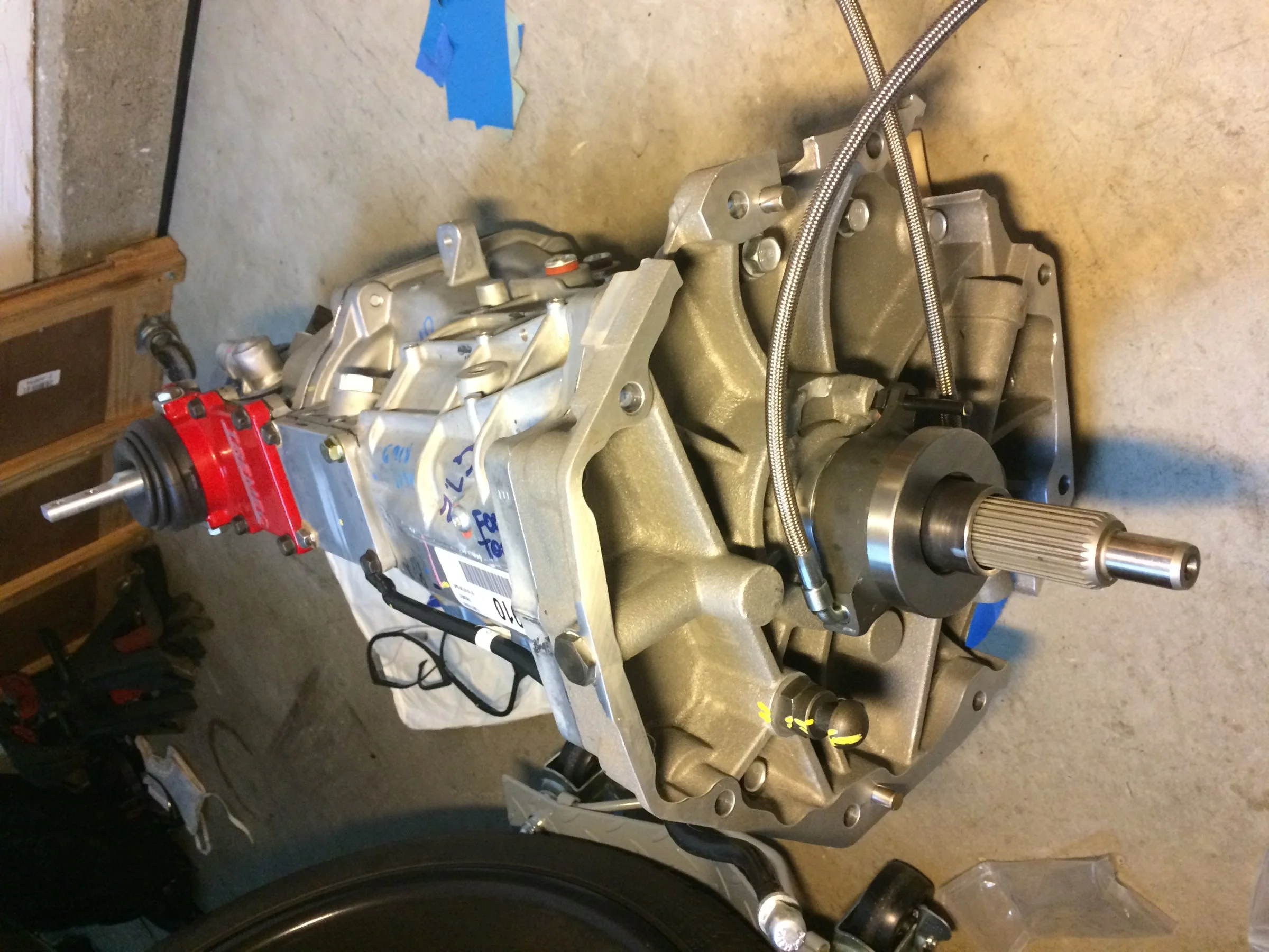

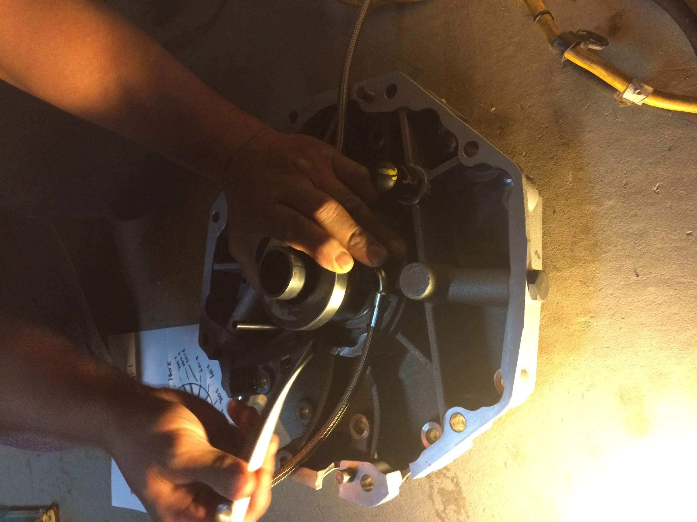

Moving along this Friday ! I got my clearance needed for my Throwout bearing and I'm good to go! What I did was average out my pressure plate finger measurements to the face of the bell and subtracted the .125" clearance needed . Then measured from the face of the front cover off my T-56 and that's my 1/8" gap !! . Let me tell you .... Getting that throwout bearing over that sleeve was a B****! Even with lube. Its nice getting help from my Dad. He's been helping me machine things since I started my build and also getting me out of potential headaches. With years of experience he's still teaching me. As we speak he's fabing up some engine lift brackets! More dollars in my pocket for the Turbos or Supercharger funds jar! :nice:. Now I'm reassembling the front cover to the T-56. Next step will be test fitting the engine and tranny! Guys pray for me that I won't have to modify my Trans tunnel!!! Hopefully the mounts I have will lower the engine enough and not cause me more work so I can move on to installing my Hydraulic clutch pedal set up from modern driveline.
