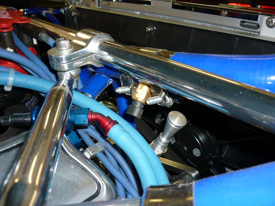

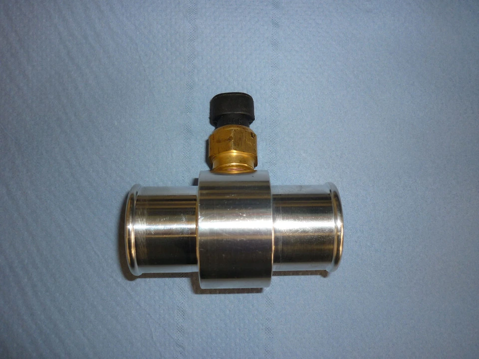

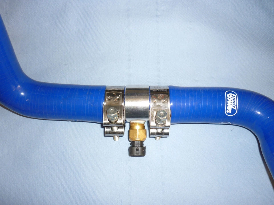

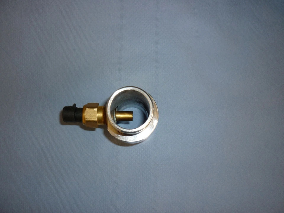

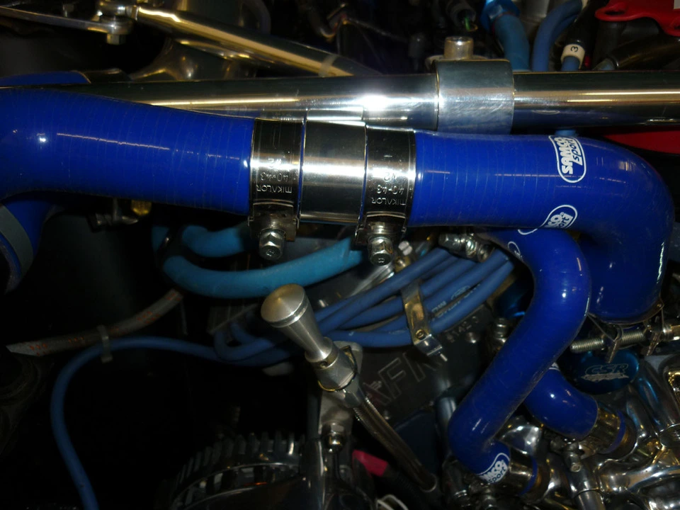

The drawing I posted shows how to put the thermostat switch in the ECT coolant path.

Markus, that looks like a good solution to me. Where did you get it and how much did it cost? What's the part # and price for the temp sensor/switch?
