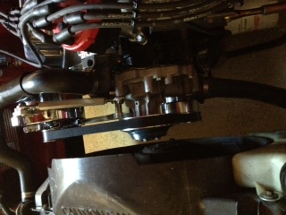

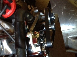

So my car has been running real hot in light traffic today it went up to 240 degrees and seems to run around 190 200/200 on open high way on a 75 degree day. Flushed out the radiator, all new hoses, replaced the already new tstat, and checked the electric fan. Now the water pump isn't a standard 5.0 it's actually a new Chevy water pump that can spin in either direction (so im told). Now I didn't install this pump so I'm pretty convinced this is the issue. I want to install an electric pump and wanted to here opinions on the mater. I'm looking at either a CSR or a Meziere, but I'm open for options. Also I don't have power steering, A/c, or smog so by eliminating the pump pulley I will only have the ALT and Crank. Is this a problem?

I'd like to see a picture of said "Chevy Water pump" on the car.....maybe a part number too? Sounds like he's either snowing you, or doesn't know what he's talking about?

yea id like to see this chevy water pump set up....

Here are 2 pics of the water pump. He said he installed the chevy one because it is a universal rotation and thats what he needed. From what I can tell the pump is spinning clockwise which correct me if Im wrong is the standard rotation?? I have spent the past 2 months correcting everything this jack @$$ has done, the pump doesn't seem to fit right it leaks a little and isnt cooling jack. I want to install the electric pump because I like the look, and thought just 2 pulleys would be a clean look. This isnt a horse power driven change. Im changing out the radiator and electric fan set up. I want to ditch the stock shroud and put a nicer over flow. I may just put a polished mechanical water pump in and call it day.
doesnt look like any pump ive seen for a chevy... id question the timing cover also at that point. id get everything new for a ford and start over.
