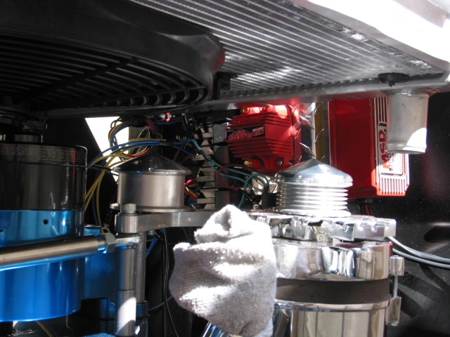

I have the Mezziere too, with a 2400cfm fan (I do not remember who makes it). All I had to do was mount the center of the fan motor about 1.75 inches lower than the center of the pump motor. Here's an outdated pic that sort shows it...
