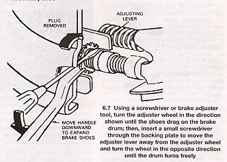

If the rear drums are still locked: The brake backing plates have a small plug used to access the self adjuster mechanism. Remove it and you can see the star wheel adjuster. You need to stick a screwdriver in the hole to lift the ratchet arm off the star wheel and another screwdriver to turn the starwheel. The ratchet arm prevents the starwheel from being turned in a reverse direction and loosening the brakes.

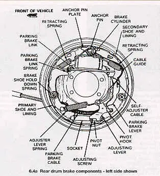

Typical setup
