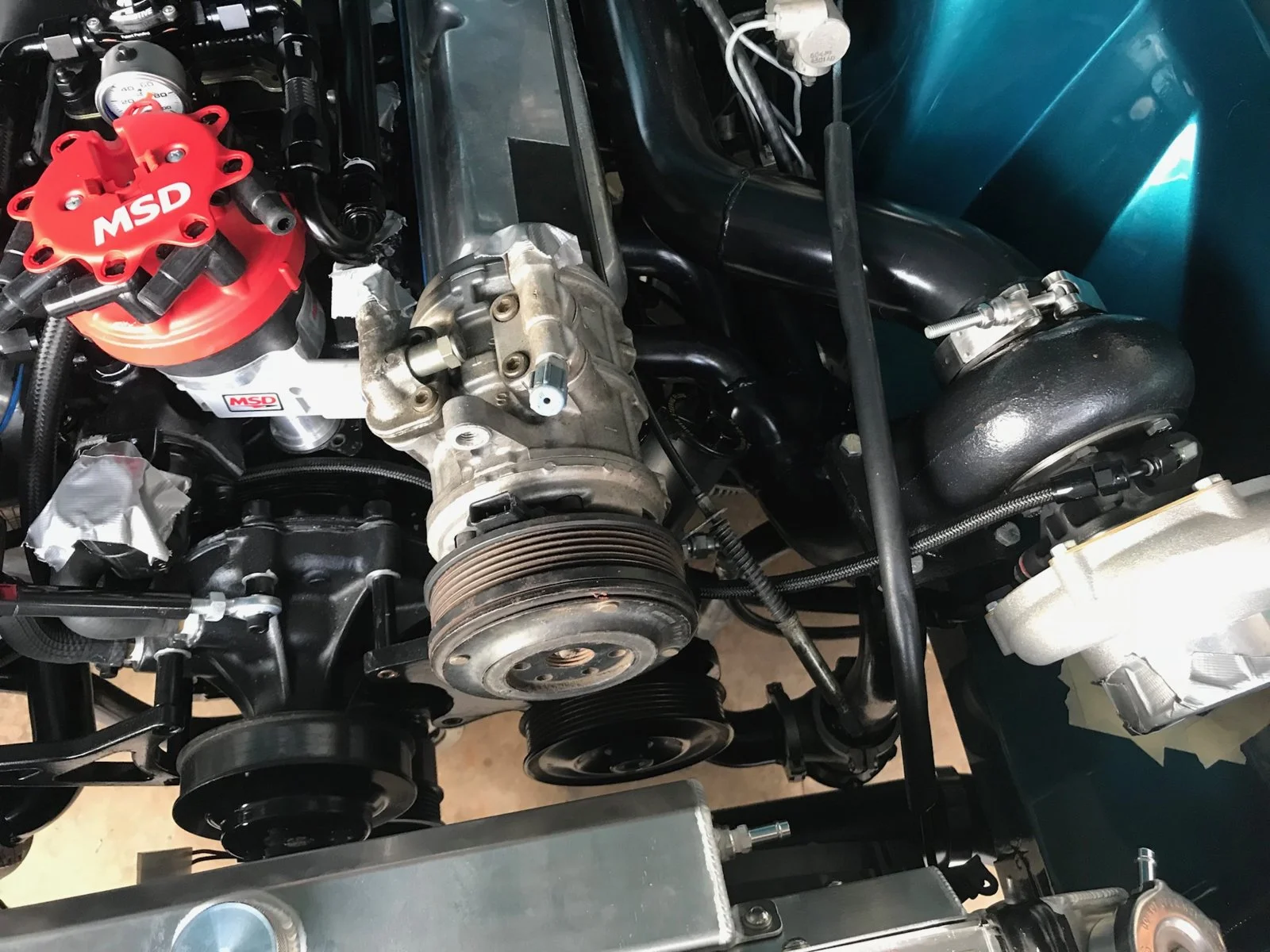

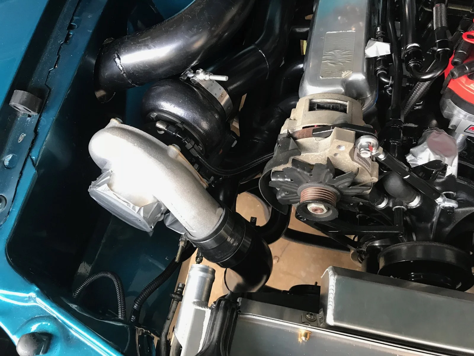

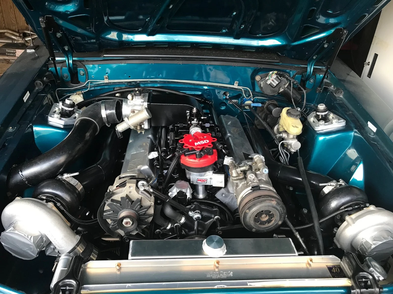

Here is my engine bay. Think about fabing something so I can put it near the ac compressor

Seems to me, it's right in front of your face. There's gonna be 10 different opinions from 10 different people. So that said,...I'd make a bkt that stands the coil off of the WP. It'll keep it close to the dist and eliminate the stupid looking 40 mile long coli wire, and depending on how the bkt is built will isolate the thing from heat and vibration.
I relocated all my wiring behind the left fender.... but my coil is still in the factory location.
I'm single turbo but space is still limited.
With that intake is there enough room to hide the coil on the other side of the elbow ? Back there no one would notice it.
With my intercooler piping and crossover theres just about nowhere for me too hide mine. My intake is a Systemax...so....
Im going EDIS eventually but plan on putting the coils where the distributor is now.... or down by the oil pan.
