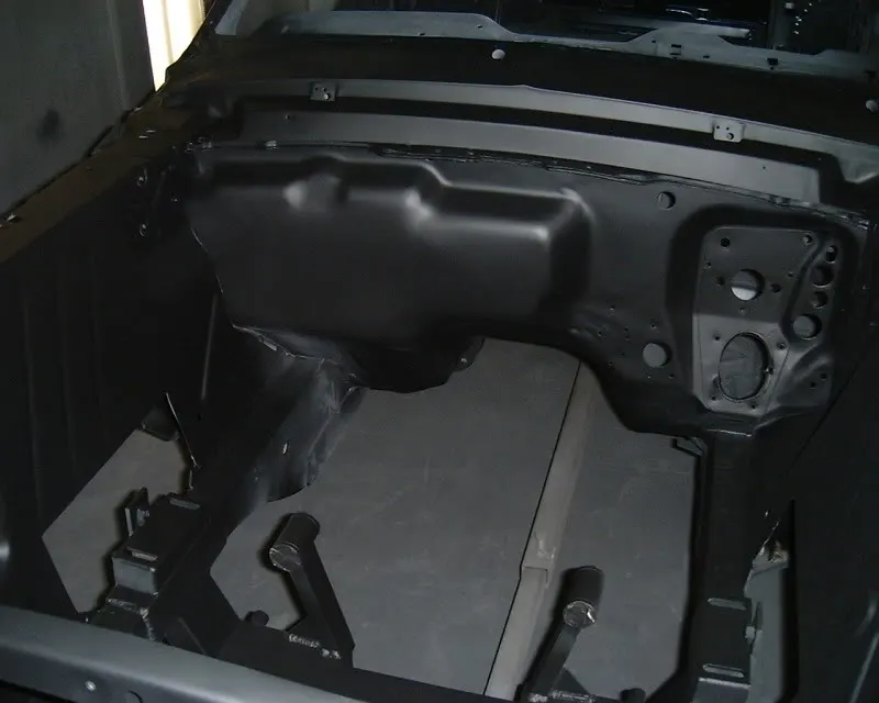

You have to make the mounts on the engine and crosmember so we used a bare 390 block bolted to a transmission to line up where we had to weld in the motor mounts on the crossmember instead of a heavy complete engine. We welded the mounts with the block down 3 dregrees.
You have to make the mounts on the engine and crossmember so we used a bare 390 block bolted to a transmission to line up where we had to weld in the motor mounts on the crossmember instead of a heavy complete engine. We welded the mounts with the block down 3 degrees.
