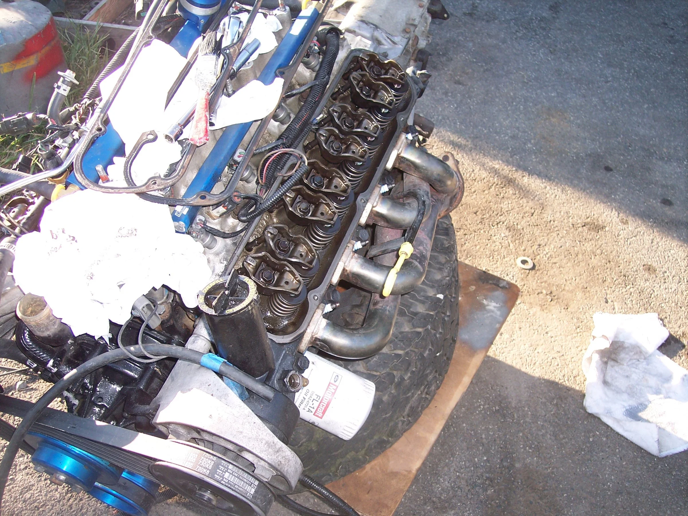

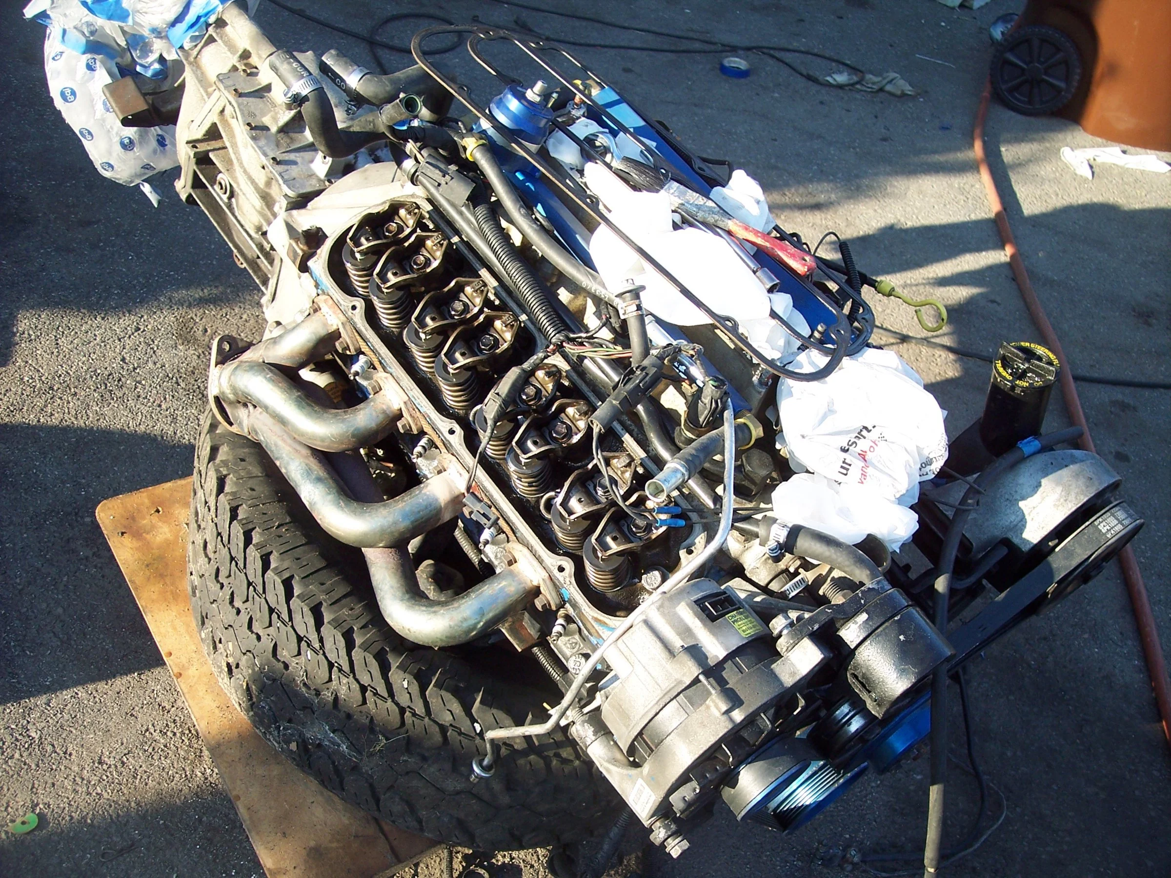

Yea the date code is for a 1985 engine E5AE C3B
I'm a little confused because the firing order is connected like an HO engine, some where I read if the cam is changed the firing order will have to be changed also. ???? Not sure about that.
These are the only 2 photos I took with the valve covers off, not sure you can see much detail.

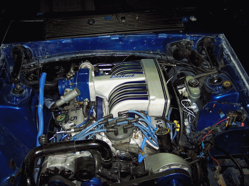

Well I took some more pics of the engine finally in place and it's looking good. most all wiring and hoses are connected, need to install drive shaft and rehang the exhaust. Hoping to get this thing drivable tomorrow but I have some running to do and not sure if I will have enough time.
