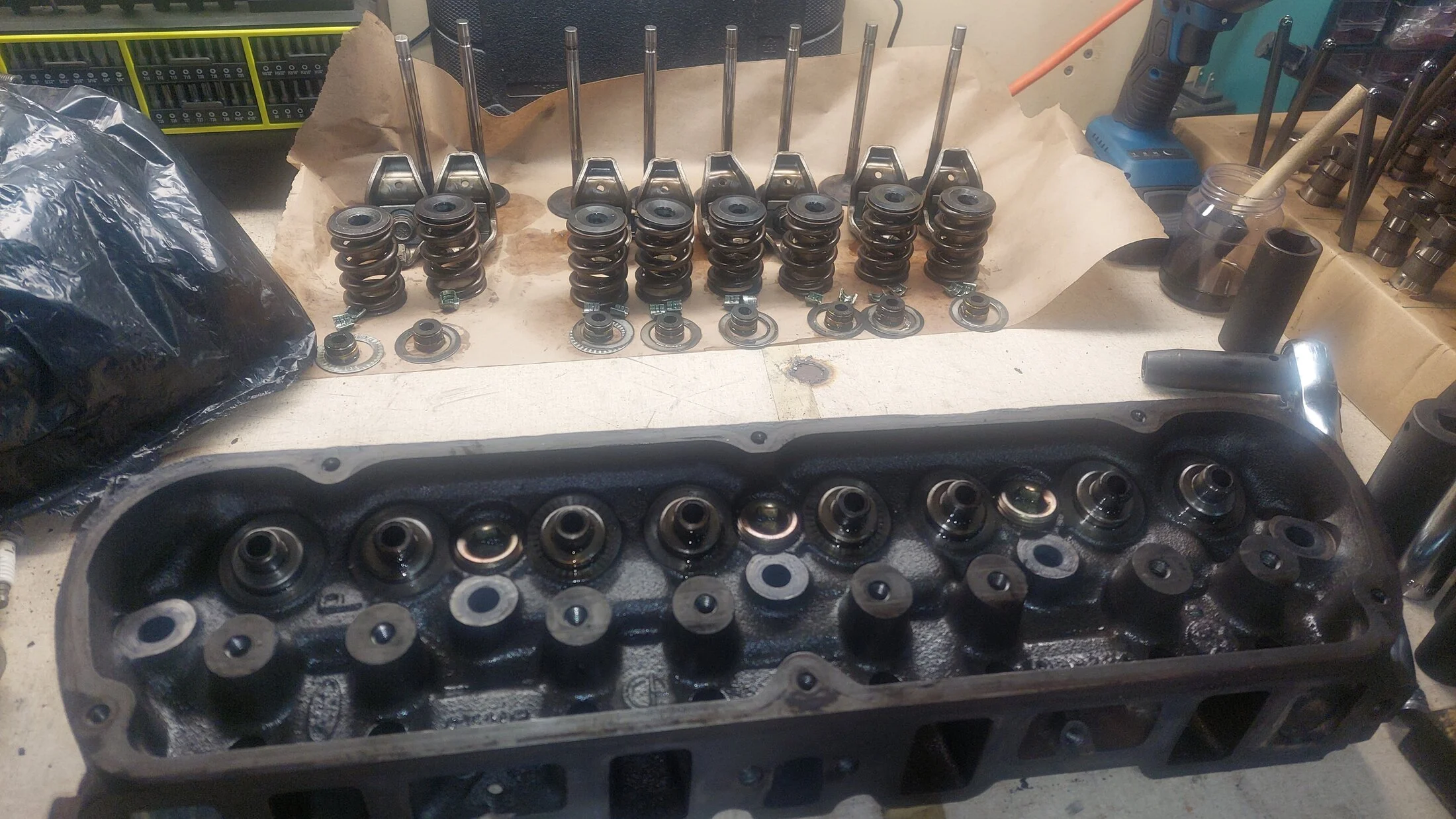

Finally, after gaining some confidence and upgrading to a 5lb hammer, the springs came off. Thank you all for your help.

Guides look good. Just finished cleaning one head and valves. Lapping-in valves is next. Also, 2 shims were for some reason damaged, need to replace them-- so I'm glad I took the heads apart. Other than that, things seem to be in pretty good shape.
