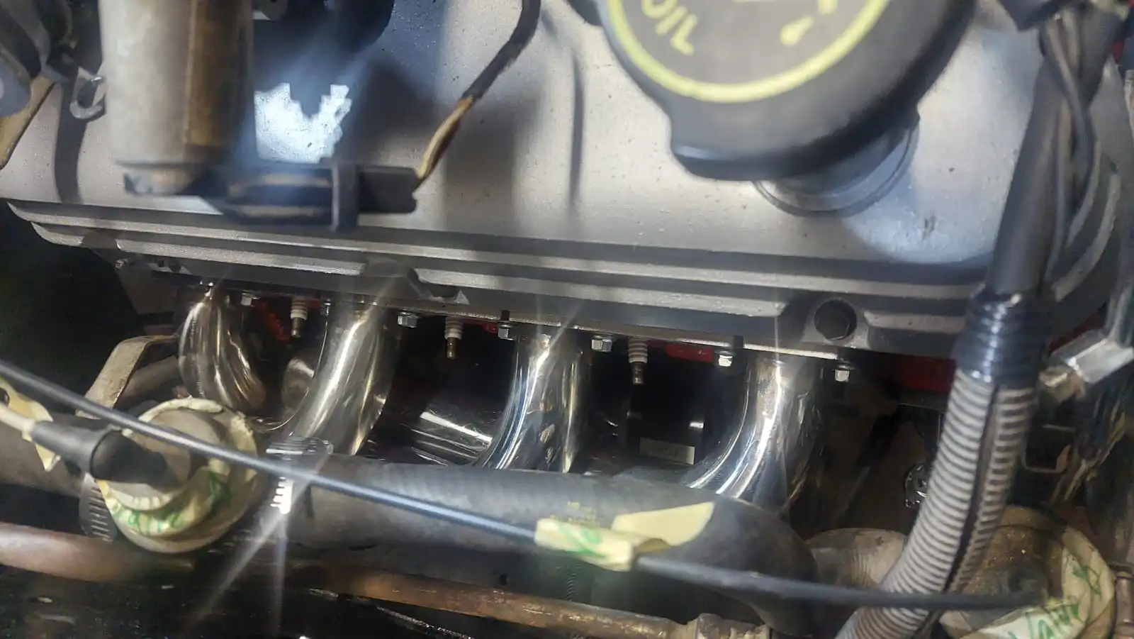

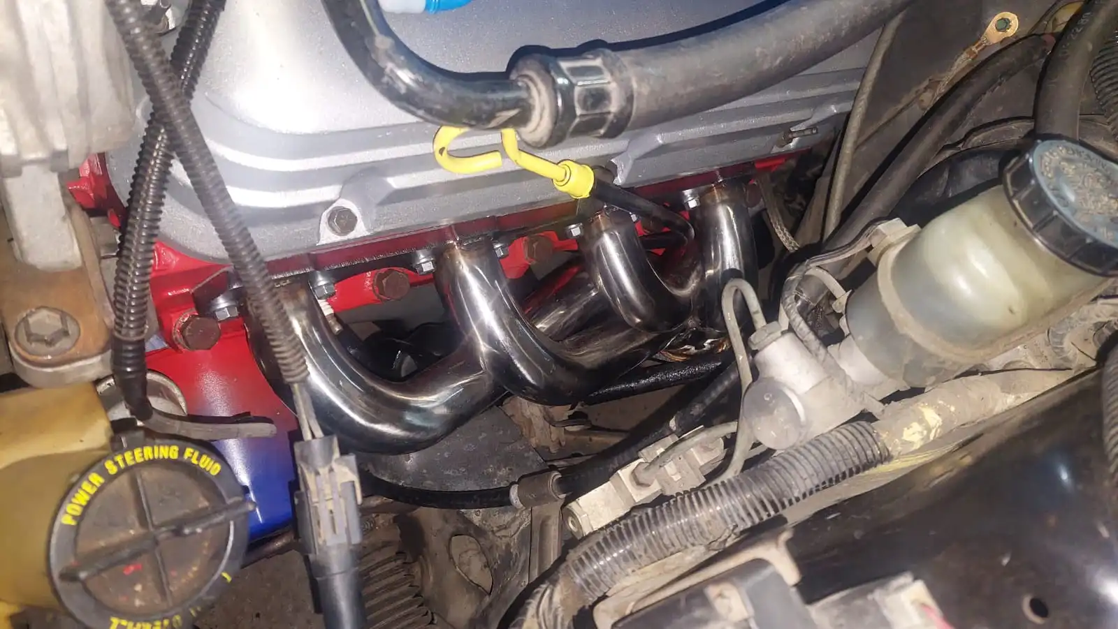

just ordered Flashark headers as mine didn't fit. Supposedly they're equal length and fit the gt40p. Coming in from China for $148
Fit perfect. Pretty happy for the price. We'll see how they sound

Those are unequal length but side by side on the dyno and there is not much difference. Look great and better yet they look like the spark plug access is good and the plug wires should fit well.
Reactions: JulianR

You're right! Good catch. I must have started my research with equal length and decided on the cheaper option. Yea, for street fun, the difference for me is negligible.

Honestly, you're better off. The engine dynos I've seen with only swaps between equal and unequal shorties, always leans a hair toward the unequals.
IMO, it's the [only] way to do shorties and if you're boosted, it's a no-brainer.

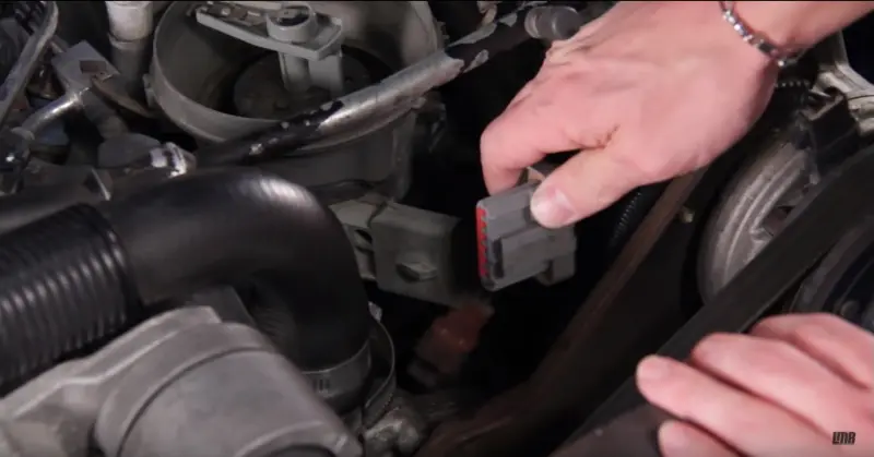

You are going to have all kinds of smoke when firing a new motor or even one that you have done a HCI swap on. New paint, oil residue, antifreeze residue, header coating, etc.
You really need to quit F’ing around with trying to time the car by ear or guessing.
1) Go get a timing light
2) Get the motor up on TDC compression stroke
3) Set the dizzy pointing to #1 cylinder on the cap (put cap on dizzy transfer mark to body of dizzy)
4) Most of the ones I have seen (including mine) the plug on the TFI is at about the 4:00 to 5:00. This allows for timing room as the chip can fowl on the lower intake.
