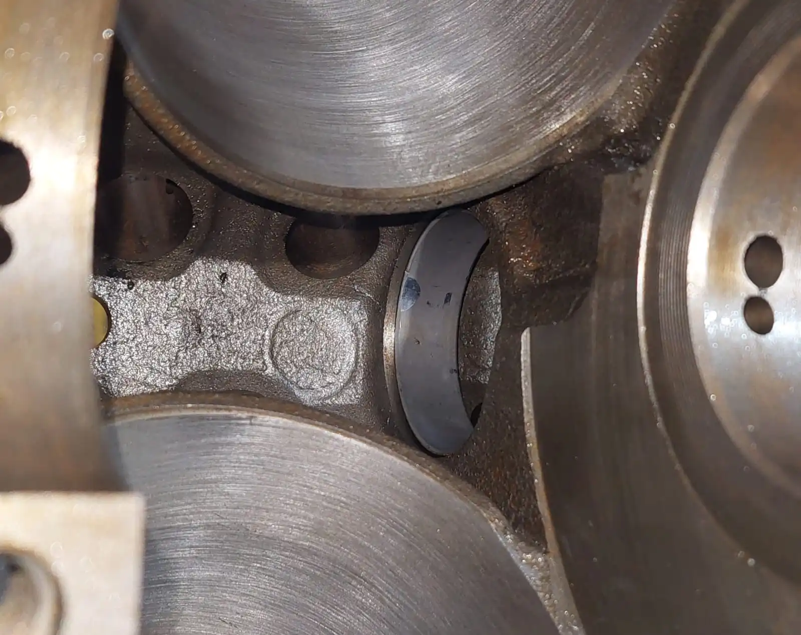

I think I may need cam bearings after all. Only 1 looks like that-- 2nd or 3rd. What do you think?

Appears to me that one of the cam lobes whacked the bearing during an installation or disassembly. Definitely not normal wear. Not really sure if that needs to be replaced since cams don't really bear much load and the load that they do bear would be on the opposite side of the damage since the lifters would be pushing down on it. Plus the oiling hole is also on the opposite side.
Personally, I would install the cam and as long as it rotates nicely still, I would just run it. At least where I live, the hourly rate at machine shops just aren't really worth it for such a low cost and low performance engine like a mostly stock SBF. I doubt that ding will have much of an effect on anything anyway.
Try installing/uninstalling the cam when the rotating assembly is out so that you can reach down into that area and support both ends of it it while it slides through the block to avoid damage like that.

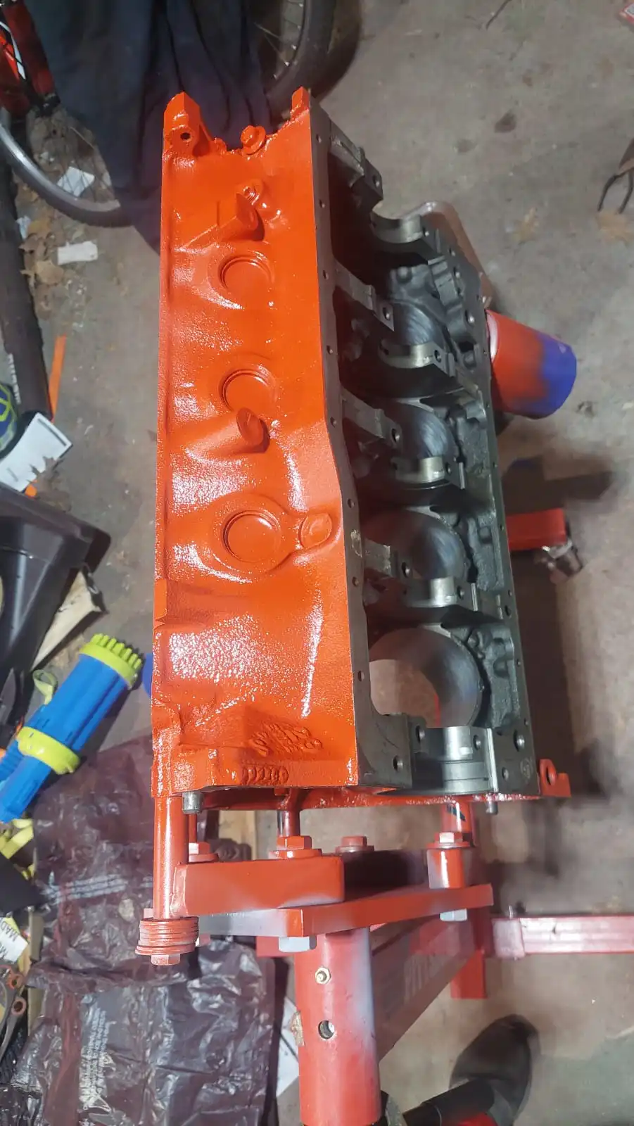

Progress photos for motivation:

You rotated the block on the engine stand?
And is that Chevy orange?
jk
Reactions: JulianR

heh, the cap on the paint was red, it's supposed to be red

Early Mustangs had blue blocks and later models have black...just saying.

yea, I saw the blue, didn't really like it. The black would be good, but won't see anything leaking until it's too late. I'm building this more as a toy than OEM, so red/orange I think will look great with a black car. I am thinking of leaving the valve covers stock. Originally, thought I paint them gray, but I cleaned them up pretty well and aluminum should be better than gray paint.

I have been using black for the blocks for over 20 years. You can see a leak on a black block with good (read LED or the like) lighting but in all honestly even small leaks hit the floor. Your car and red and/or orange does look good with black but not too much of it.
