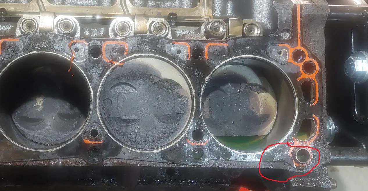

I did look closer at the gaskets today and found the part of the gasket circled in the photo below bubbled up. Also, the antifreeze in the cylinder I thought came from removing the head not that it burned antifreeze. I don't recall it blowing white smoke out the pipe, or having cloudy oil. Glad I'm tearing it apart.

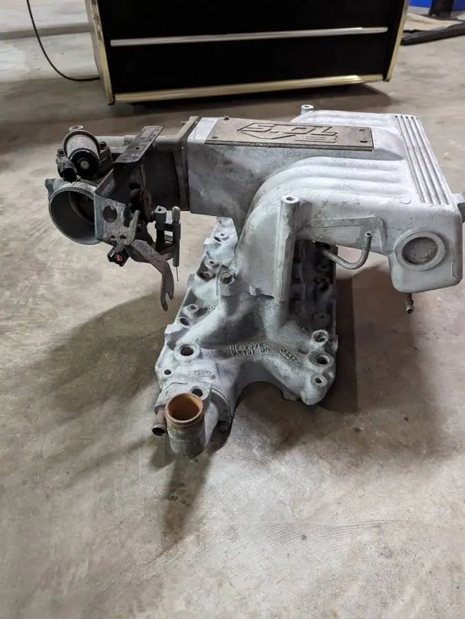

So, if you recall, I bought a Stage 1 Cam (new), found some used GT40P heads. Now I see an ad for an explorer intake-- upper/lower for $110. Should I get it? Will it work? Also, there's a cobra lower and upper for sale for $350, but can probably get it lower. One better than the other?
For ~$100 - I would. It'll be an improvement over the stock HO intake. You can always swap it out with a better intake when funds allow.
Just my 2 cents and probably not even worth that.... :shrug:
Reactions: JulianR
I'm a little concerned about drilling bosses and such on the explorer setup. Is the Cobra direct bolt on? If so, maybe worth the $100 extra or so.
About the only thing the Cobra setup has over the Explorer is the ACT sensor location in the lower intake on the #5 cylinder runner is already there. You can drill and tap the Explorer lower. The other thing is whether or not you want an EGR as early Explorer (96 and some 97's) uppers had them and later on they do not. Cobra upper has the EGR provision cast into it.

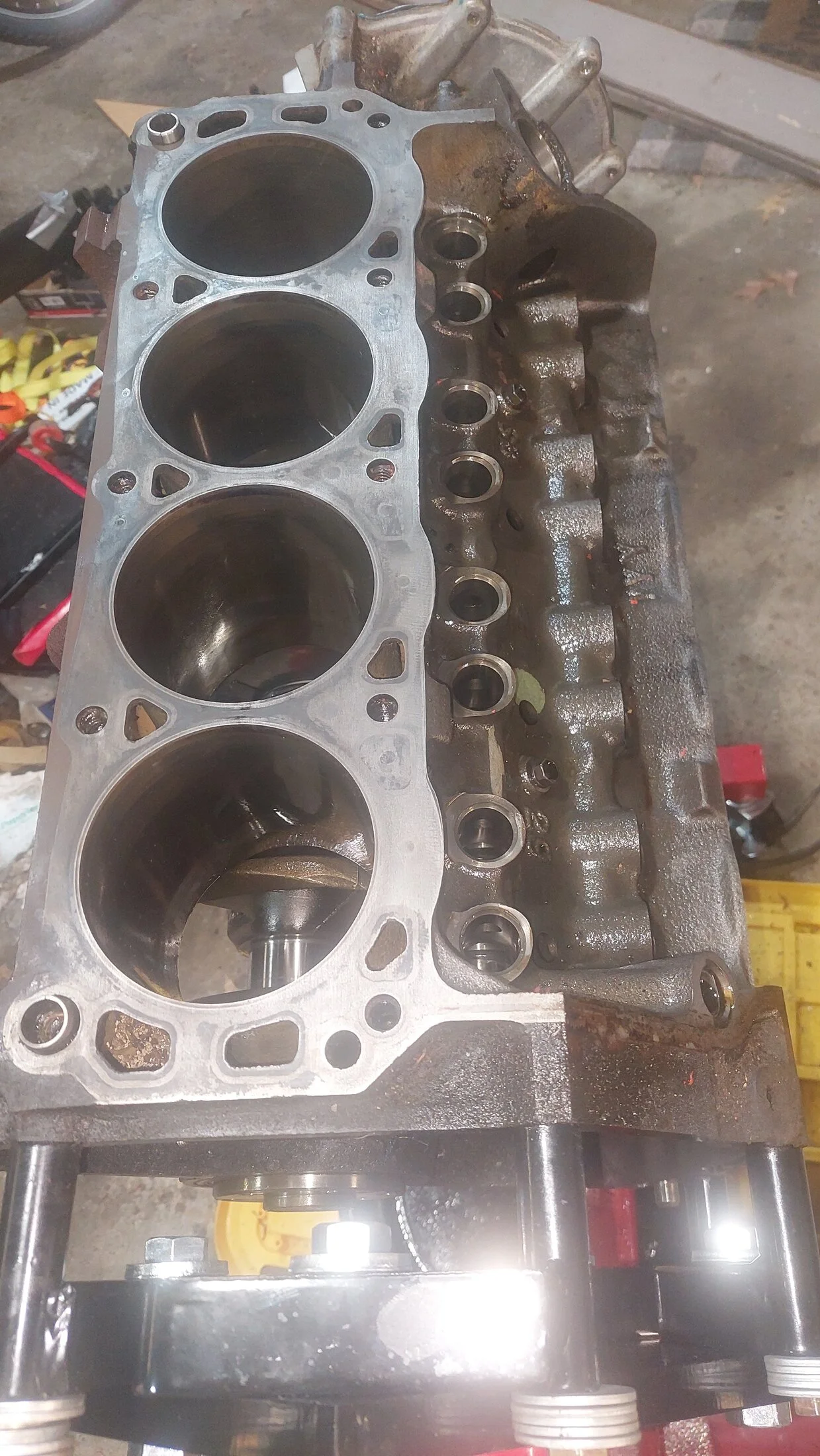

One more question. When I took off the lower intake manifold, the 2 first passages on the left side of the photo looked yellow. Is that the antifreeze mixing with oil? What would cause it?
Just to clarify this photo for other newbies reading this in the future, the far left passage and far right passage in the photo, on both heads, is actually a "water passage" I thought they were intake passages.:doh:

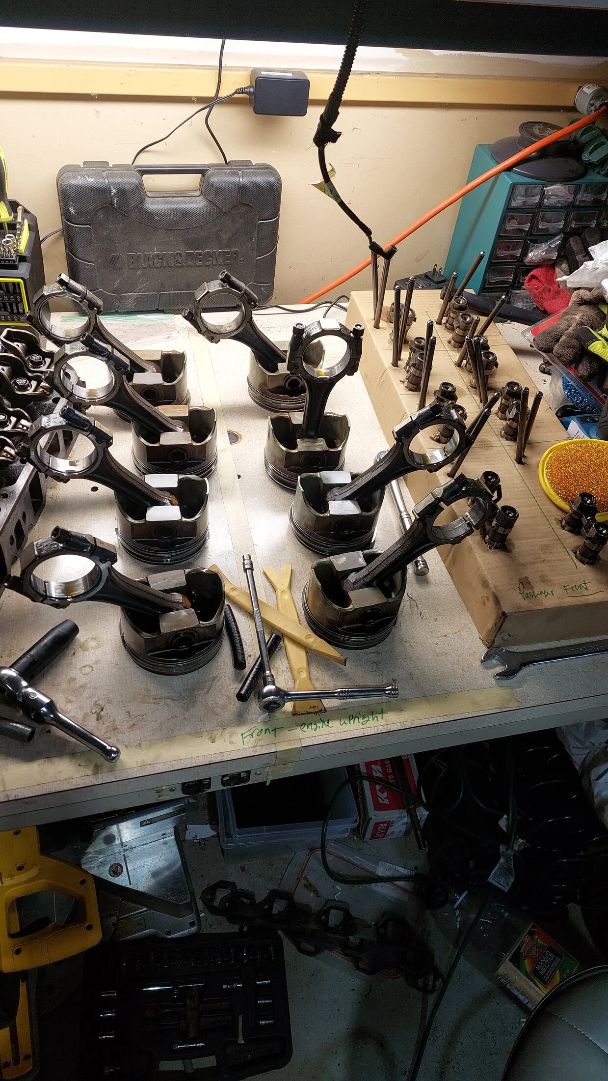

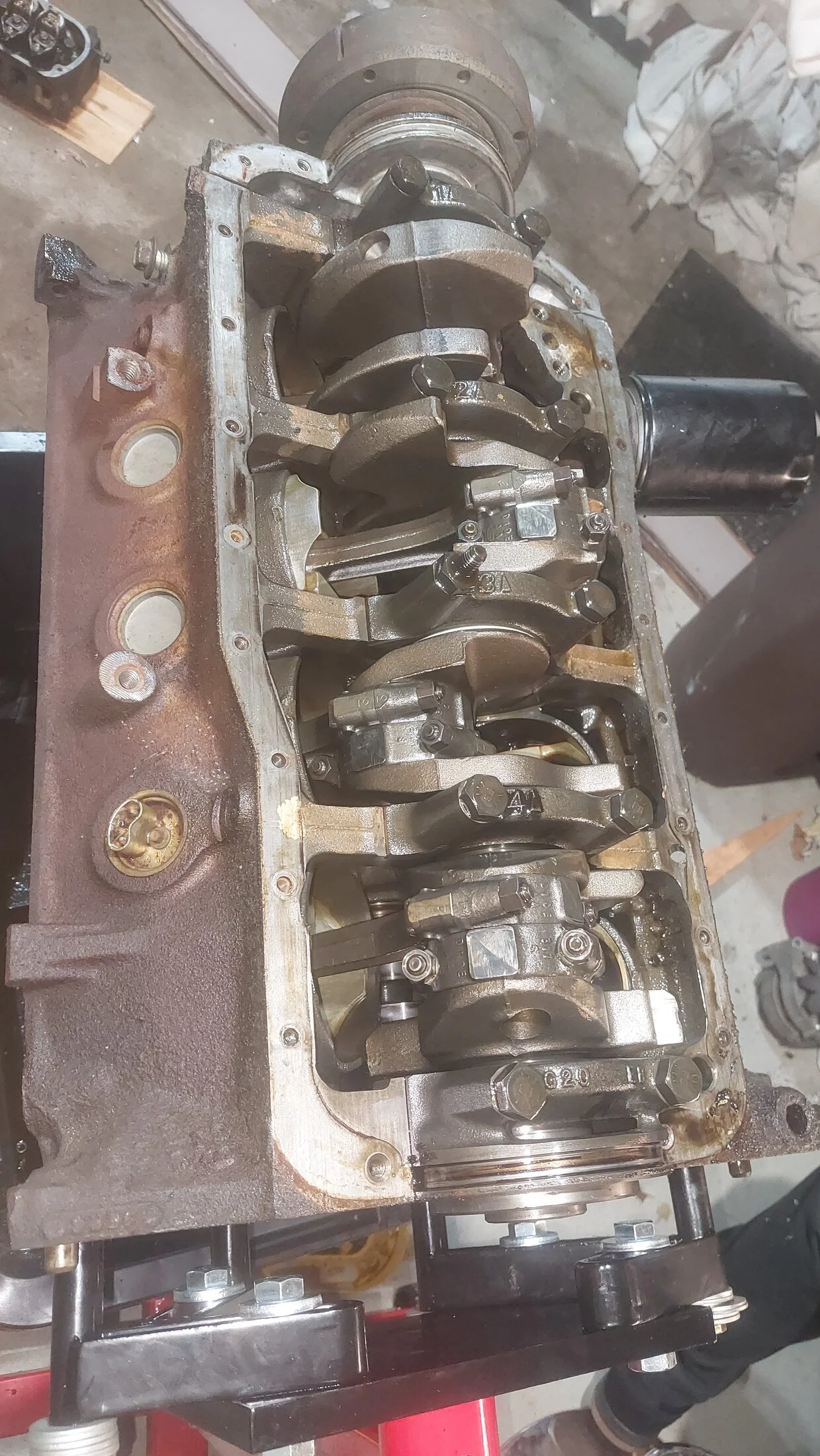

Things are progressing well! I found out that the caps and rods had cylinder numbers already stamped in to them which was very helpful. Not sure if it's from the factory or someone already dug in to the engine. Main caps are numbered too-- but that's factory.
The hydraulic lifter bores all look great. All the lifters came out smooth, no problem.
Haven't opened the main caps yet, but the piston cap and rod bearings all look great-- there's one or two where the copper color is showing slightly, but no gauges, or scrapes that I can feel with my nail.
The pistons all look uniformly worn with some wears on the sides, but no cracks/chips. The piston heads tilt easily on the rod. All the rings move freely.
The journals on the crank shaft look perfect.
The oil pan gasket was torn though-- perhaps over torqued or something. It was a black rubber gasket-- not sure if that was original from the factory.
All the gasket mating places look good and need minimal cleaning.

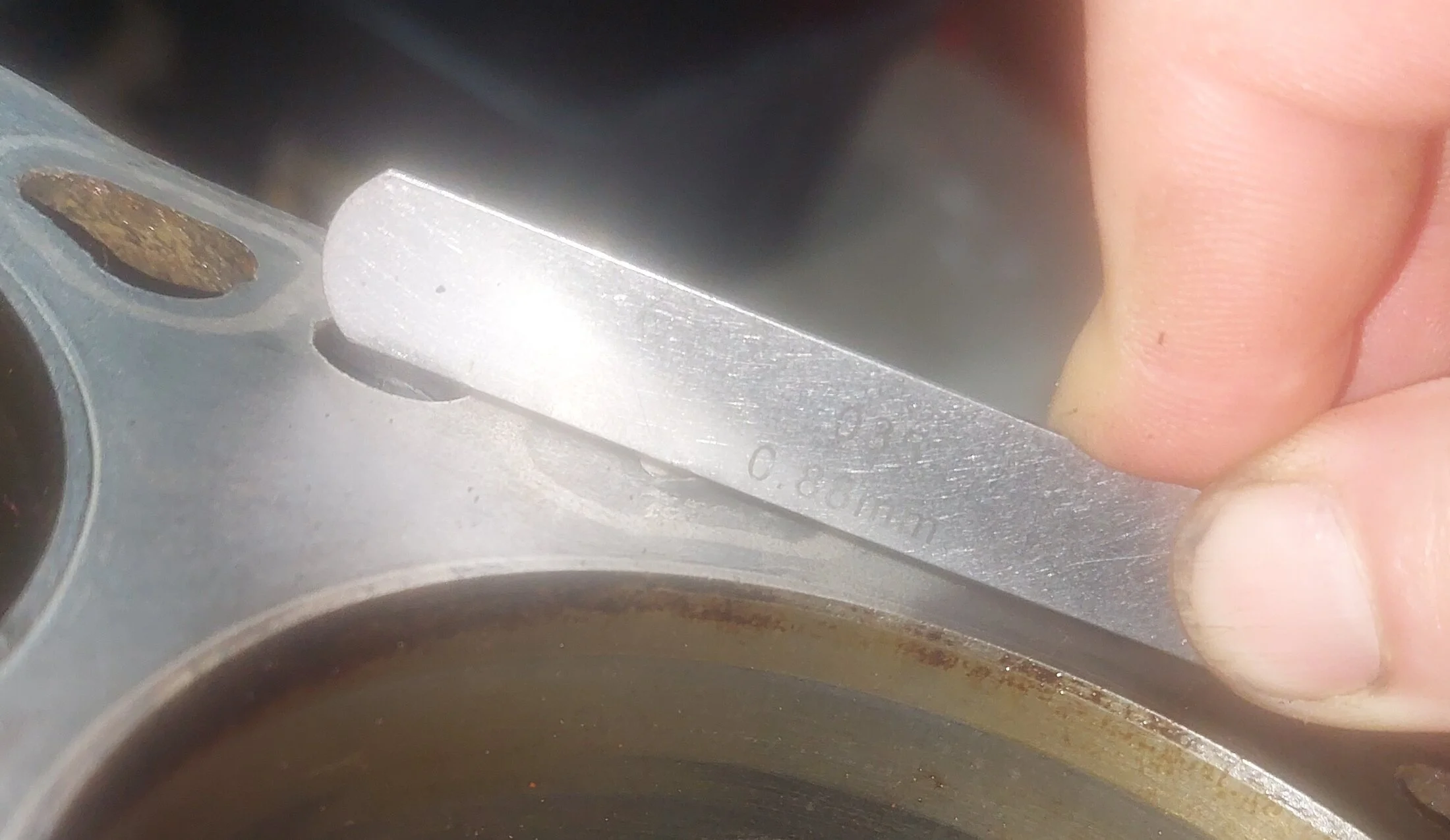

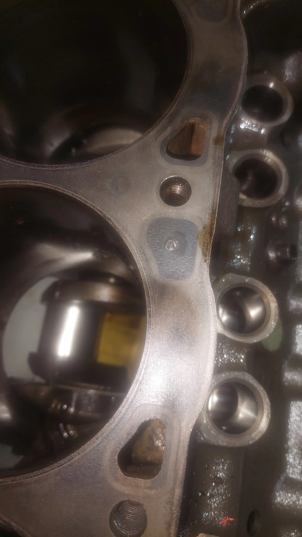

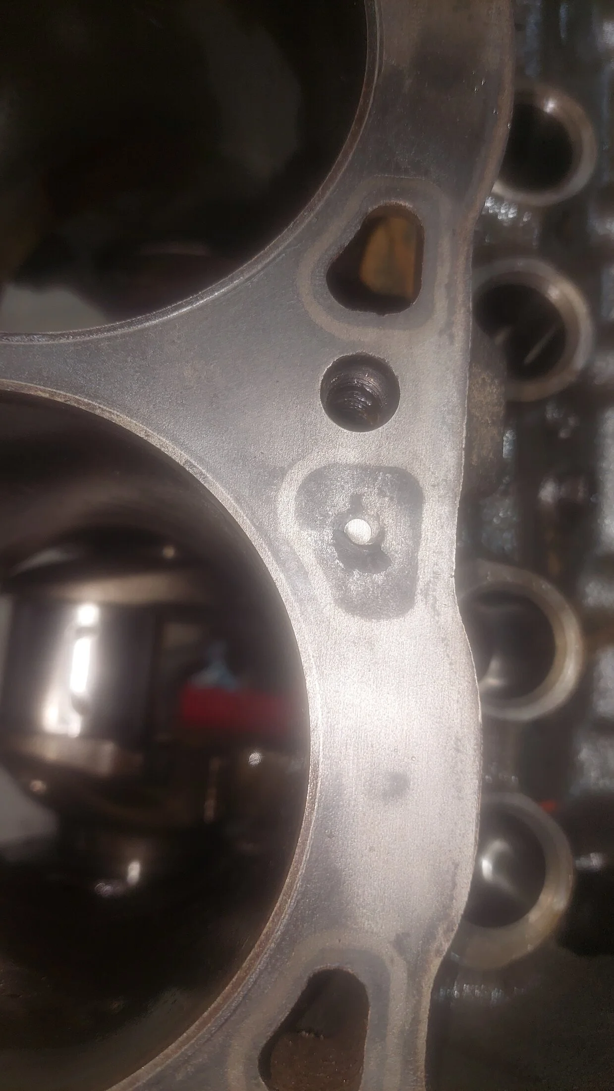

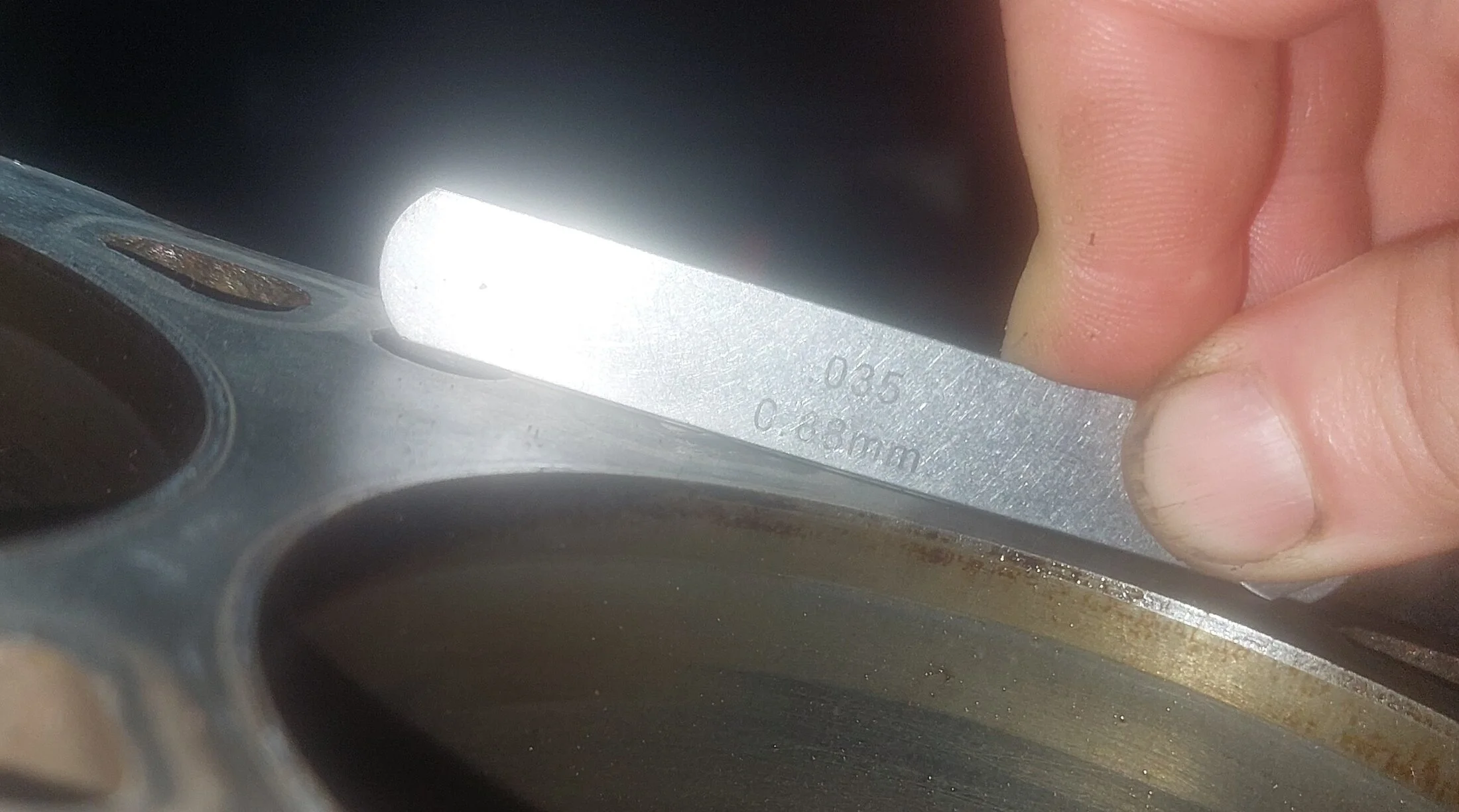

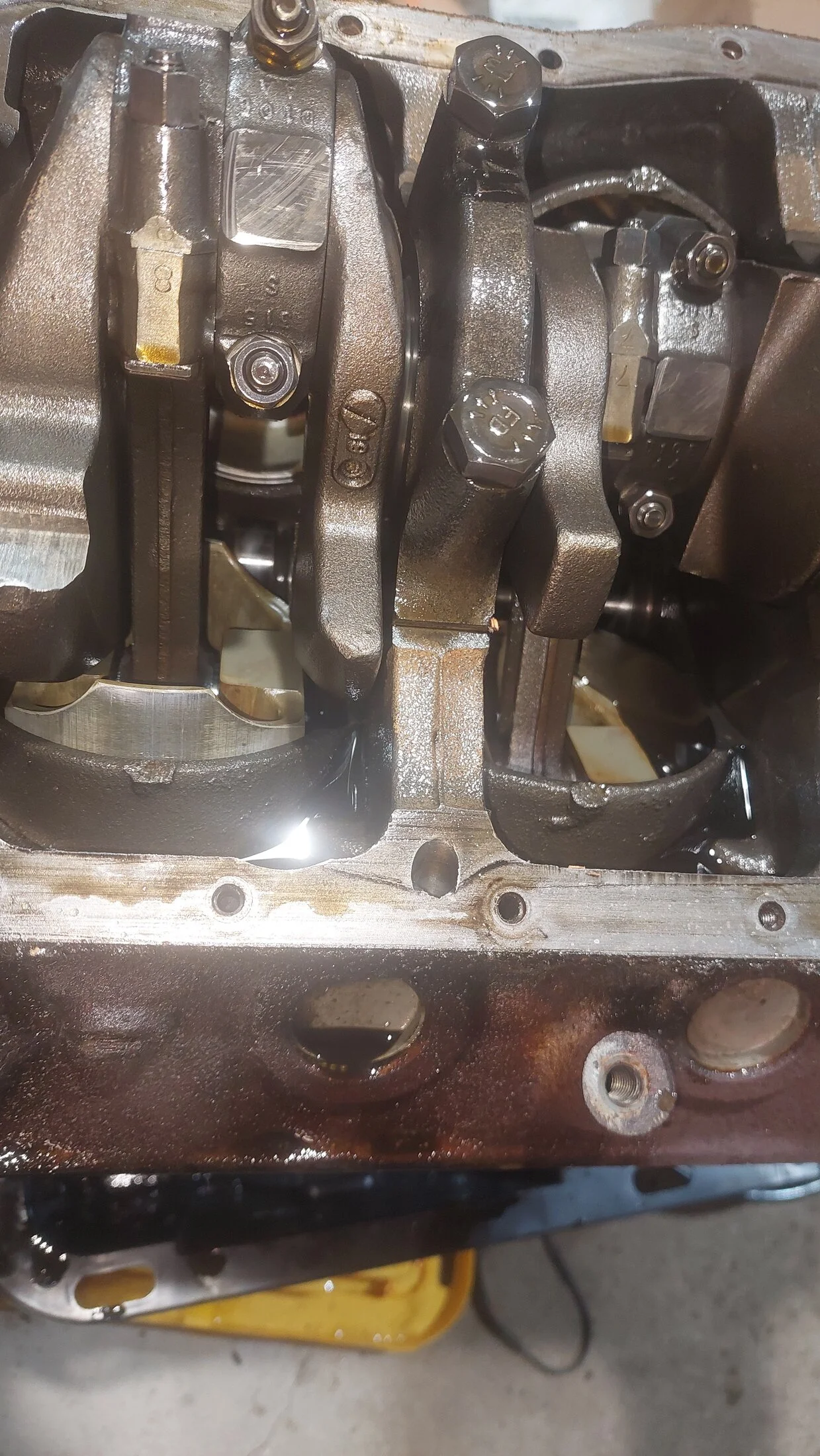

Only issue I see is on the passenger side of the block where the head goes, on the top side where I asked the question about the gasket 9 and 12 o'clock holes being blocked-- it looks like a casting defect. On one of the cylinders, there's an irregular area that's protruding cast iron-- not carbon. Almost looks like there was a hole there but was filled with a different material and not cleaned up. Doesn't look like a home job. Hole corresponds to the gasket hole. I was thinking of cleaning it up with a Dremmel to make it more flat with the rest of the surface. Thoughts?
Would want to see a picture of the protrusion on the deck of the block before making any recommendations.
While taking photos, I tried using the feeler gauge to remove that spot and it seemed to work, so maybe there's hope for it yet- yesterday, break cleaner and nylon scraper didn't put a dent in it. However, you can still see the holes, on the one side of the block, look like they were filled with something at the factory.
