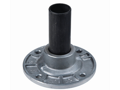

Now... if your transmission is BONE STOCK... then this would be great time to replace INPUT BEARING RETAINER
The OEM retainer is aluminum and is crap.
