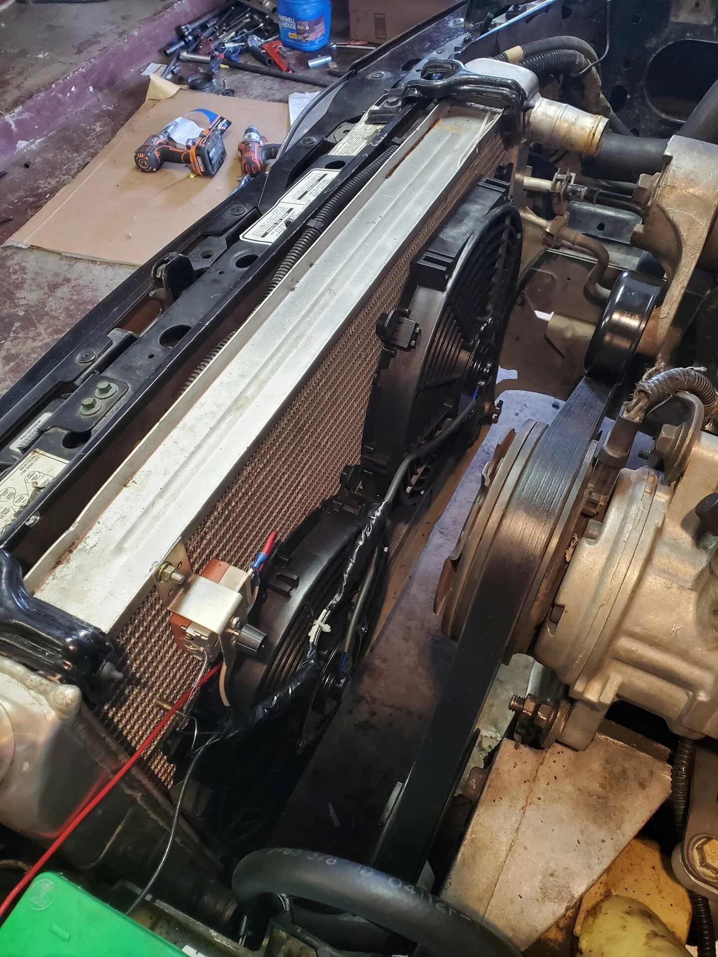

Again, Yes the cooling system was working great with the other engine. Nothing in that system changed except for the fans themselves. I dont have a shroud on the back side of the radiator because its dual fans but that wont matter on the highway. I have seen too many other cars with the same fan setup and plenty of cars run without even a shroud and not have issues. Has to be something to do with the engine itself or something. I should be able to run no fan or shroud at all if I stay on the road with the car moving. That is why i am confused. Maybe heads ported too much and thin ports? Head gaskets in backwards? I dont want to just start ripping into it but I am about to. Here is the fan setup.

Before I tore into the engine i'd put the factory fan and shroud back on and see what happens.
It will at least eliminate one of the variables.
And it's not much work.
I too have never seen a foxbody work with that style fan setup without a shroud. Is it your problem here? Not really sure, but regardless it's certainly not how i would run it especially with summer approaching.
Its more work than you might think. I will have to remove the radiator, cut the tabs holding the fans and it will have the same results. Again if I am at speed doing 65 on the highway in 5th how would the fans have anything at all to do with airflow? I am not trying to argue but cars have ran with fans like this forever. Heck look at any any non v8 mustang fan setup. I am looking guesses of other things that could cause this. If it were the fans it would overheat sitting in the driveway idling or just at stoplights. This is a consistent climb while driving. I may rip it apart and put the factory fan back on and try to get the shroud back in there since it was not in great condition but it will require taking everything apart in the front to get all of the fan stuff back out.

Those fans won't keep it cool at idle or in traffic.
This one will.

Just because your doing 65 mph doesn't mean the air is being evenly distributed over the entire surface area of the radiator. Which is the job of the fan/fans & shroud. Those look like the same crap fans I've seen anywhere from LMR to Ebay. They don't move anywhere near 1550 cfm. And no shroud. Not saying something else can't be wrong as well, but that ain't going to work.

I will order some of the Contour fans and give it a shot. I have nothing to lose. It does not seem to matter if its moving or stopped. It just starts getting hot and has trouble cooling back down but if you stay sitting it will cool back down. If you can keep the engine rpms down it helps it come down but it just wont come down very fast. If the fans dont help it will move on to something else. If they do then so be it. Maybe LX1993 is right and the fans dont move the air they are suppose to but from past experience this setup "should" be able to handle this. The car is not a daily driver, just a weekend car.
