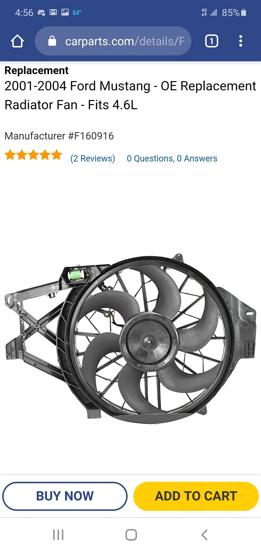

Sorry maybe it's just the 99-04 cars. I assumed the 96 to 98 were set up the same. Not sure i would call this a shroud. I ordered the contour fan though.

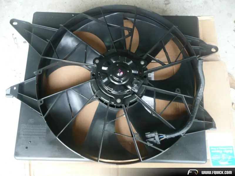

Here's what the OEM SN95 fan looks like. Notice how it's offset to one side. You can turn it upside down to clear the water pump pulley.

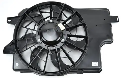

Here's what the Mark VIII fan look like.
