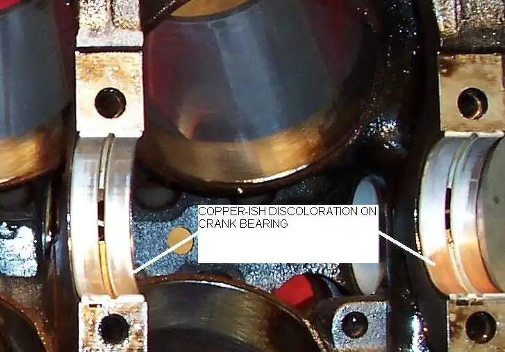

Hi all,
I just finished tearing my engine apart today (85 302, 100k miles). The crank bearings have me a bit worried. I am attaching a picture so you can see the discoloration. I thought I heard/read somewhere that the copperish color was a bad thing...

Dude, how often is the oil changed in that motor?? it sure doesnt look good.
I can't really tell if it is the way your picture was taken or if the copper really only showing on one side of the bearing. If this is the case, you should have your crankshaft checked for straightness by a machine shop.
-Other than that, no need to be worred about copper showing after 100k, I've seen bearings from a 302 with 80k that were worn far worse than yours. Have your crank checked out by a shop, polished/turned, and get yourself a rebuild kit.

I agree if it is just the side it could mean a few things, main alignment, crank, etc... I would have the block tanked and checked, and if the bores are OK just hone and re-ring it. Have the crank checked, polished and but all new bearings in the motor and put it back together.
Now if you plan to race it hard it is time to make some decisons while it is all apart...

Copper showing through at those miles is typical- lucky it's not down tho the base (steel) material. The crank should be polished B4 you re-assemble anyway, but a re-grind and line honing the mains would be best. As they were worn on one side only, this is a sure sign of mis-aligned mains, again typical of production machine work+age. The block will move a lot with heat cycles, but if you fix it now it should stay good for the life of the block.
IF (Big IF) you choose not to have the block align honed/bored, I would use a Babbit/Copper alloy bearing like a Child&Albert race bearing as they will conform much better and do not have a steel shell to damage the crank.

I don't plan on racing it but I do want a healthy engine that can withstand an occasional romping or two. I would like to keep it mostly stock (well, partly)...was thinking of new pistons, maybe an overbore....there are so many possibilities! I am new at this so it is going to take me some time to figure out what all I want to do.
BTW, do you need special tools to get those bearings out?
