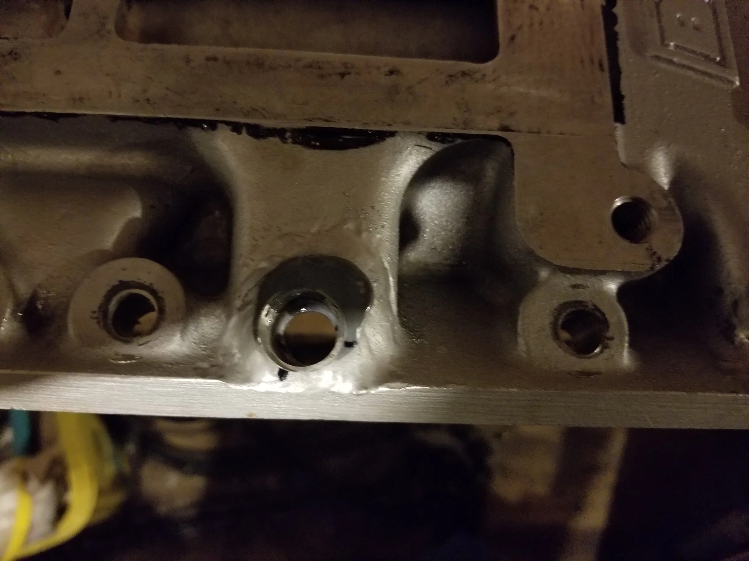

Let's change terminology here and say port opening not wall. They will be centered just .25inches closer to the port opening allowing them to be installed at a better angle.
Now the injector holes have a three step taper to them so I highly doubt the epoxy is going to get sucked into the port. Pictures tomorrow.
Little progress working on the new fuel rail mounts since the injector location was changed.
you can see the epoxy held up very well. Injector location was moved a bit over .3 inches outboard and no longer have a negative angle inward of the plenum. Fuel should spray down into the cylinder head port only.

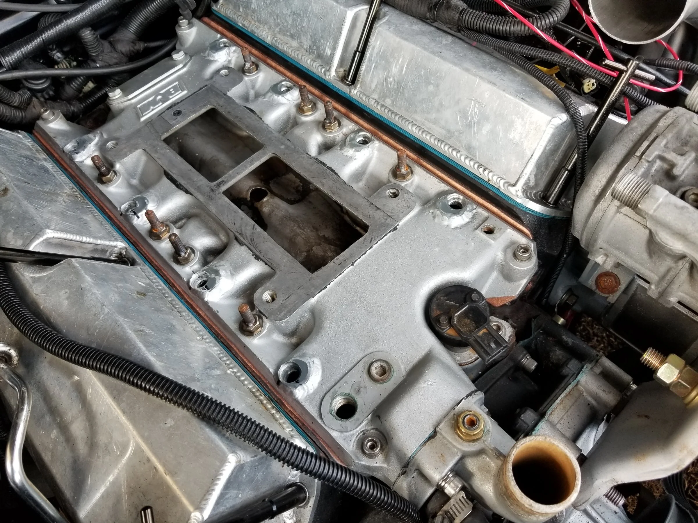

I made a small amount of progress and went ahead and installed the manifold and blower. I did not have time to retest the injector rain was moving in fast.
with the .120 gaskets I still have a lip at the bottom but it is very minimal, .130 gaskets would have made it perfect but they don't make those.

The intake is on, the new plugs are in....
I added a front crossover to the fuel rail while I had it on the work bench. So that's a bonus.
Just have to route spark plug wires and put the belt on.
