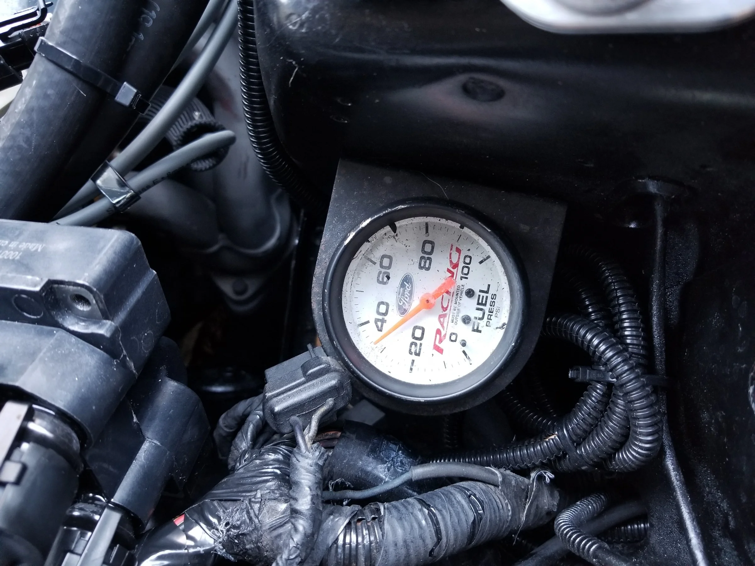

Almost 24hrs later still have 37psi on the fuel rail.

This is the method used for diesel fuel rail repairs, they run alot higher pressure than I do.
Sweated together like copper pipe
As for the injectors, people jb weld bungs in all the time it's in the instructions in thepacage the bungs came in. I am just being slightly more creative is all.
