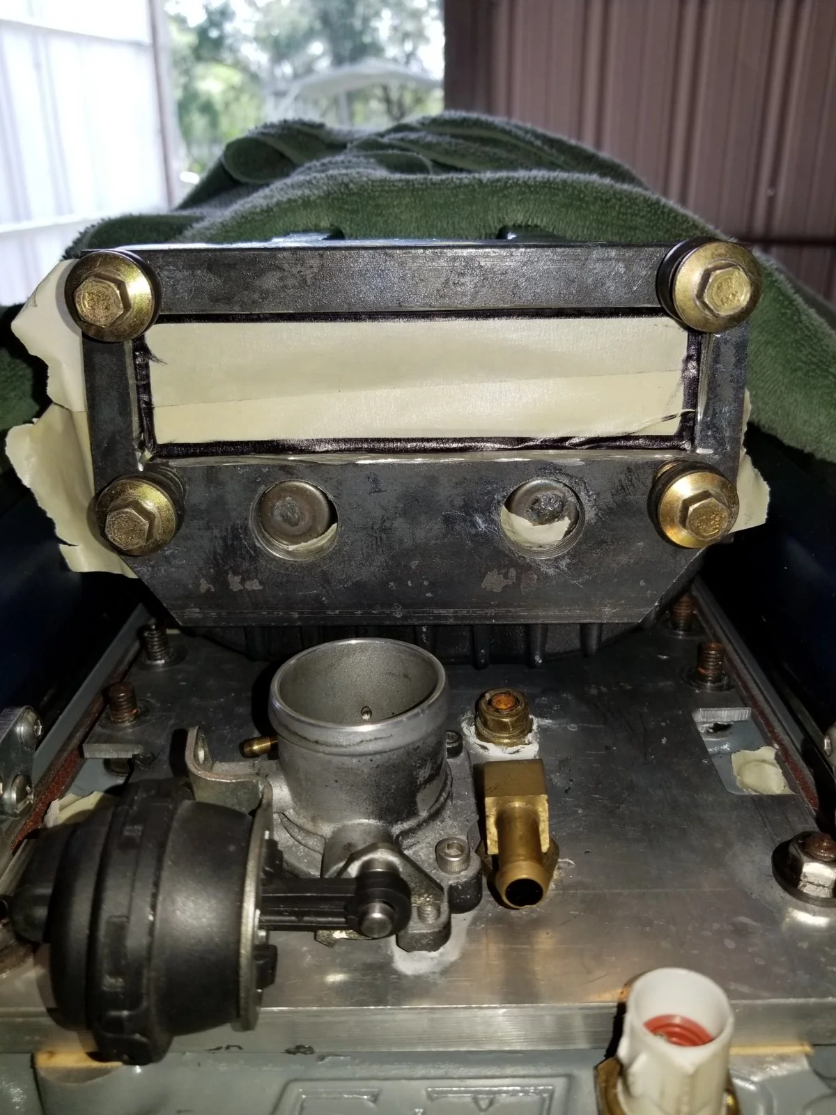

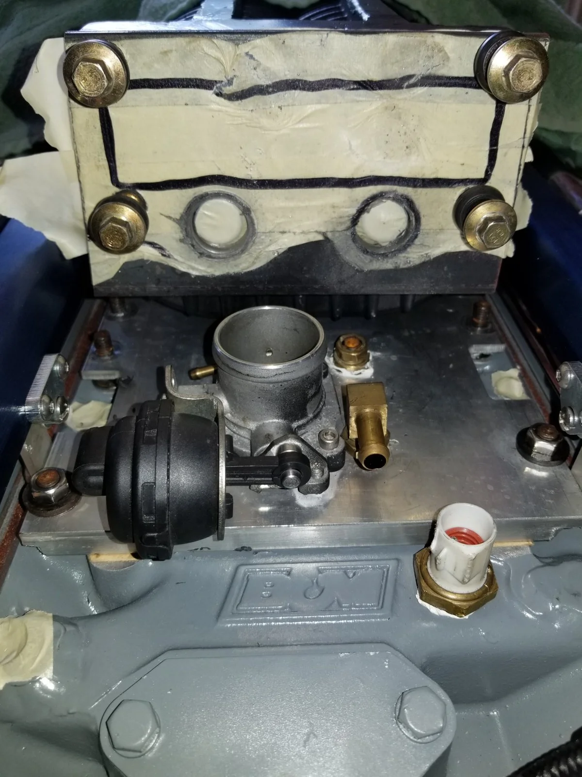

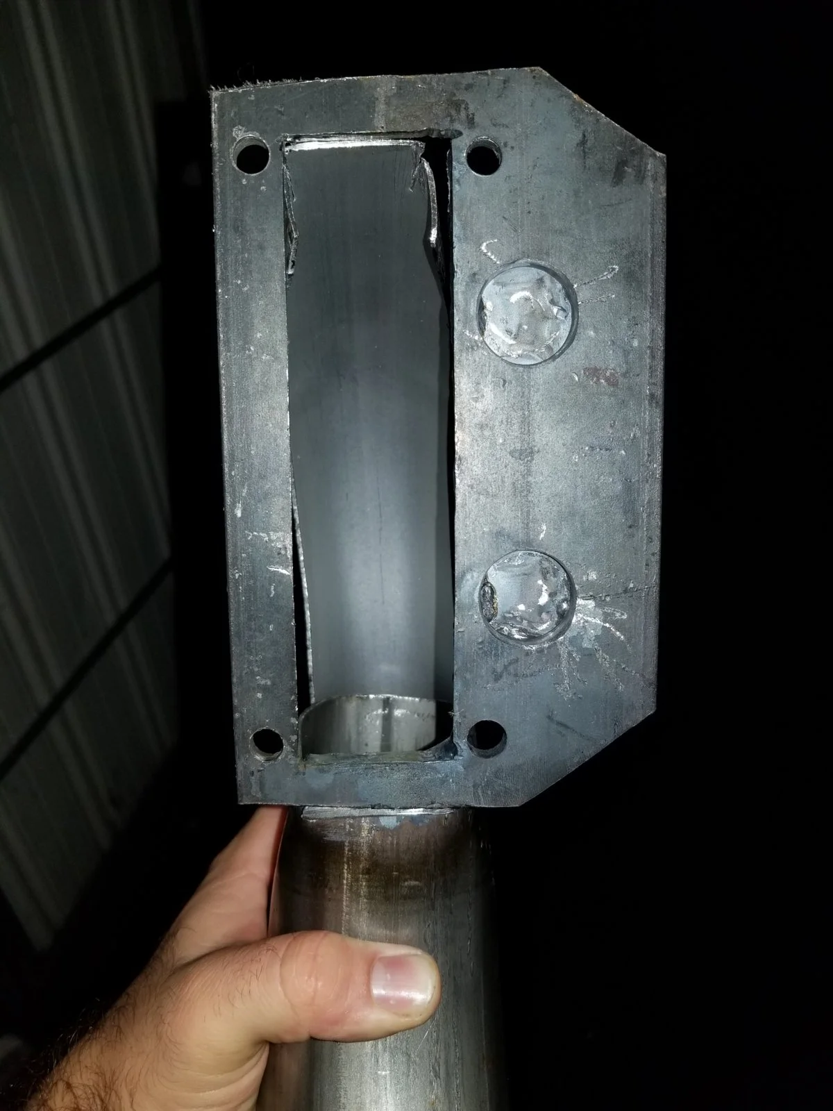

Flange.
Tape shifted a bit while it was clamped for drilling.

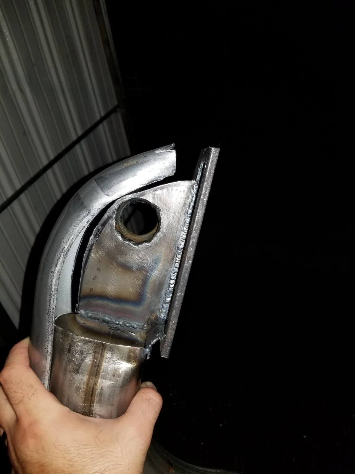

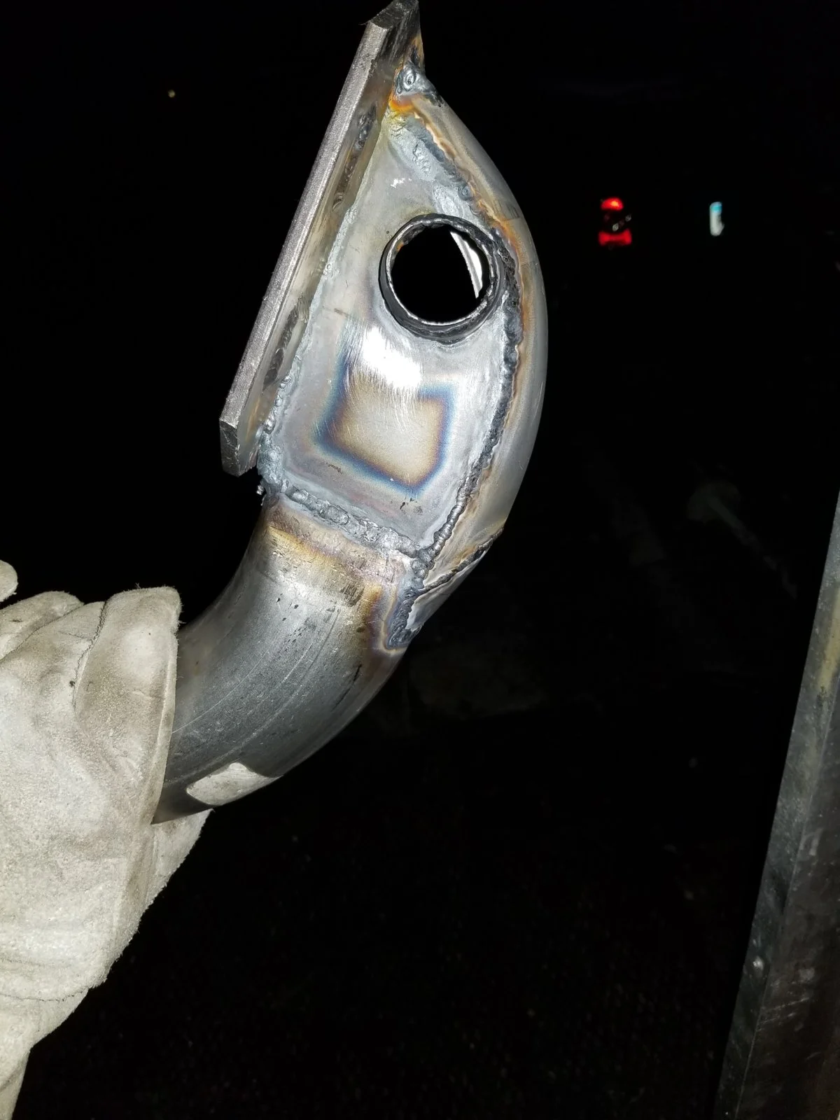

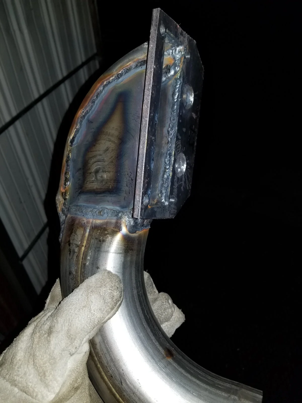

Completed flange.

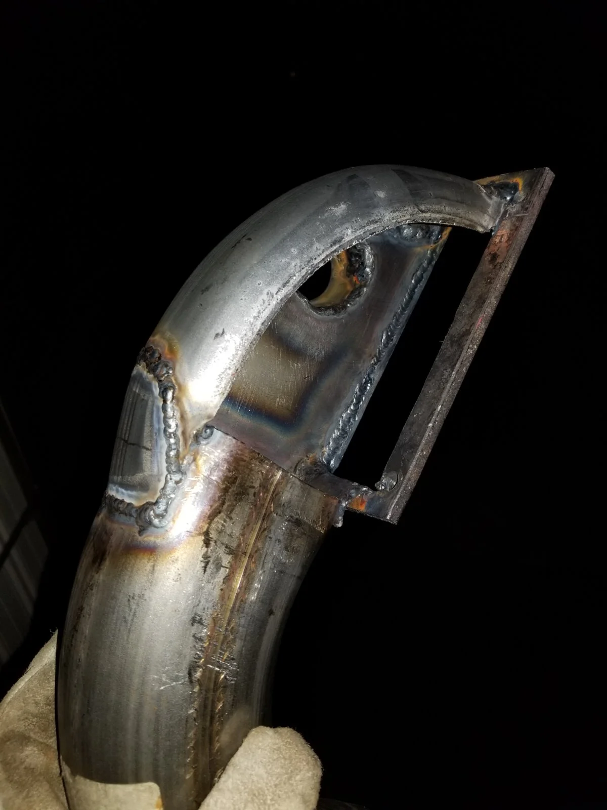

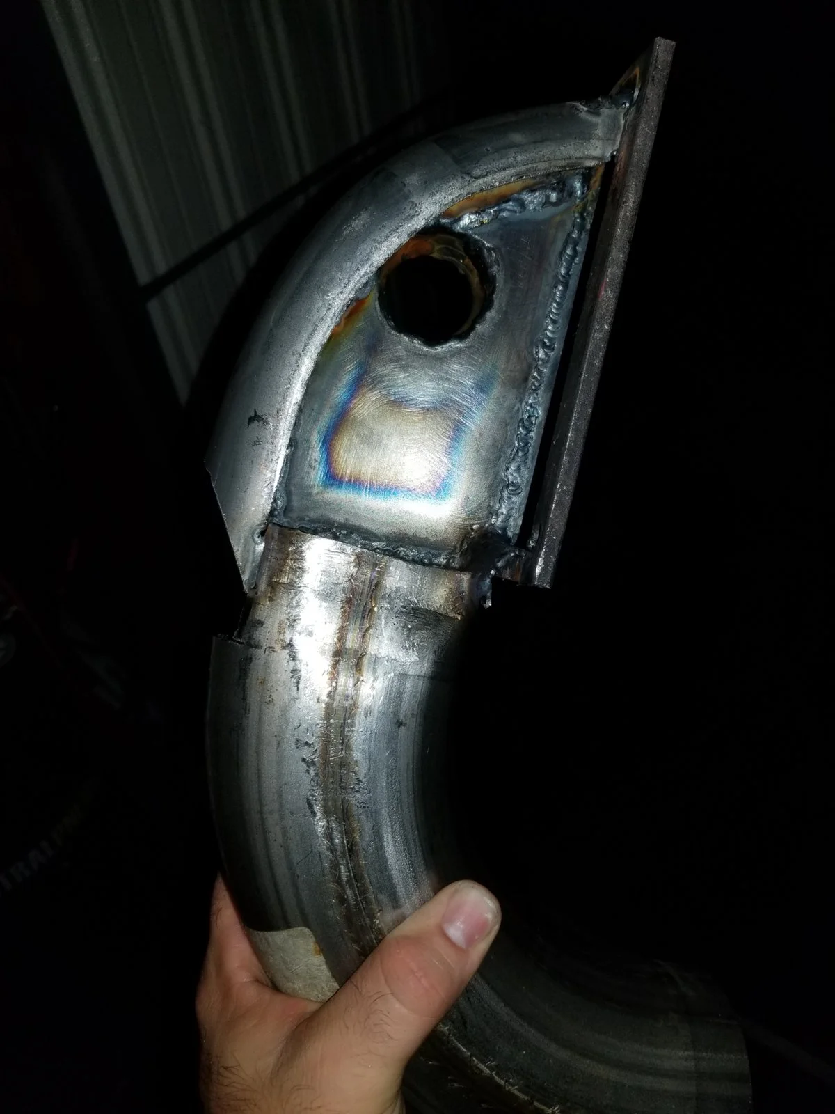

Now that I have something to show for my efforts.... @CarMichael Angelo may actually approve of this design.
I took a 2" exhaust 90* and cut the back off of it so I had a clean radius to work with. I then cut and boxed the end so it would fit.This is the general idea i am going for.for after i got it partially welded i cut the pipe so i could make a smooth transition from the round 3" to the back of the 2" radius. Remember i had to squeeze the 3" pipe down so it would fit the mold, now with this little bump out I have my area back.
I need a new welder, this thing has no heat control (no pedal) and its finally starting to act up on me. It will randomly go from a controlled arc to blow a mo@#th÷r f<"king hole in .
Reactions: 90sickfox, wiseguyk and Davedacarpainter

Dude my welds are a lot worse, you did good.

Wow lookin good Steve! What's the purpose of the hole on both sides?

Well the one side just hasn't been finished yet (still need to weld the top on it). The bottom side has a 1 1/4" pipe that will line up with the bypass valve located behind the blower.
I will still need to add a 3/8 vacuum port to feed the booster ect. The only boost referenced port will go to the ecu/boost gauge.
I also need to come up with a way to get the wmeth where I want it..... this may require drilling/tapping my adapter plate, not my favorite idea. I will be doing some measuring to see if it is possible.

I guess I just coulda gave you one of those thumb up thingys, but that wouldn't be me now would it.
That is exactly what I was talking about back when you were drawing horse peen concepts on the picture of the blower a month ago. Good job.

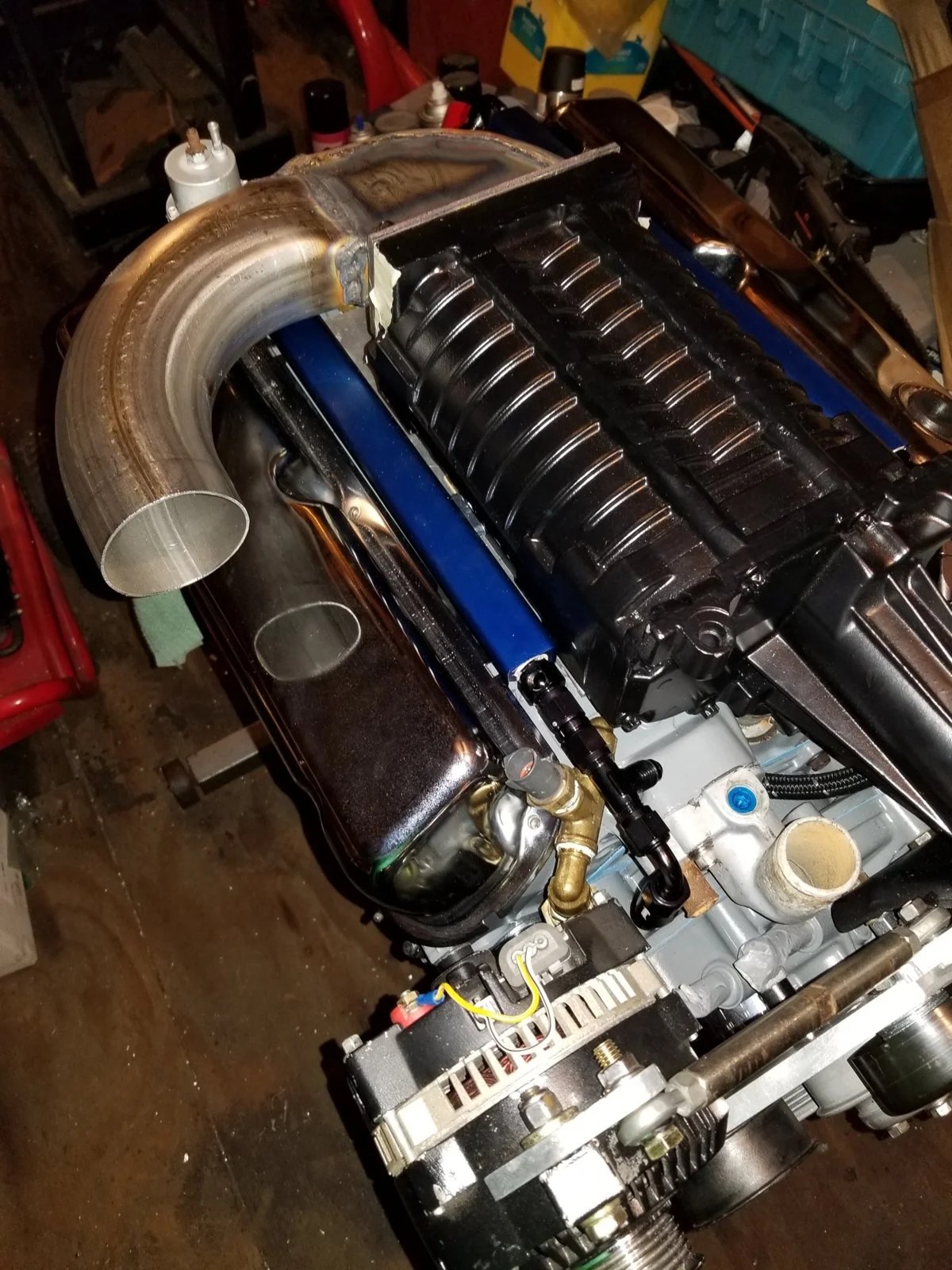

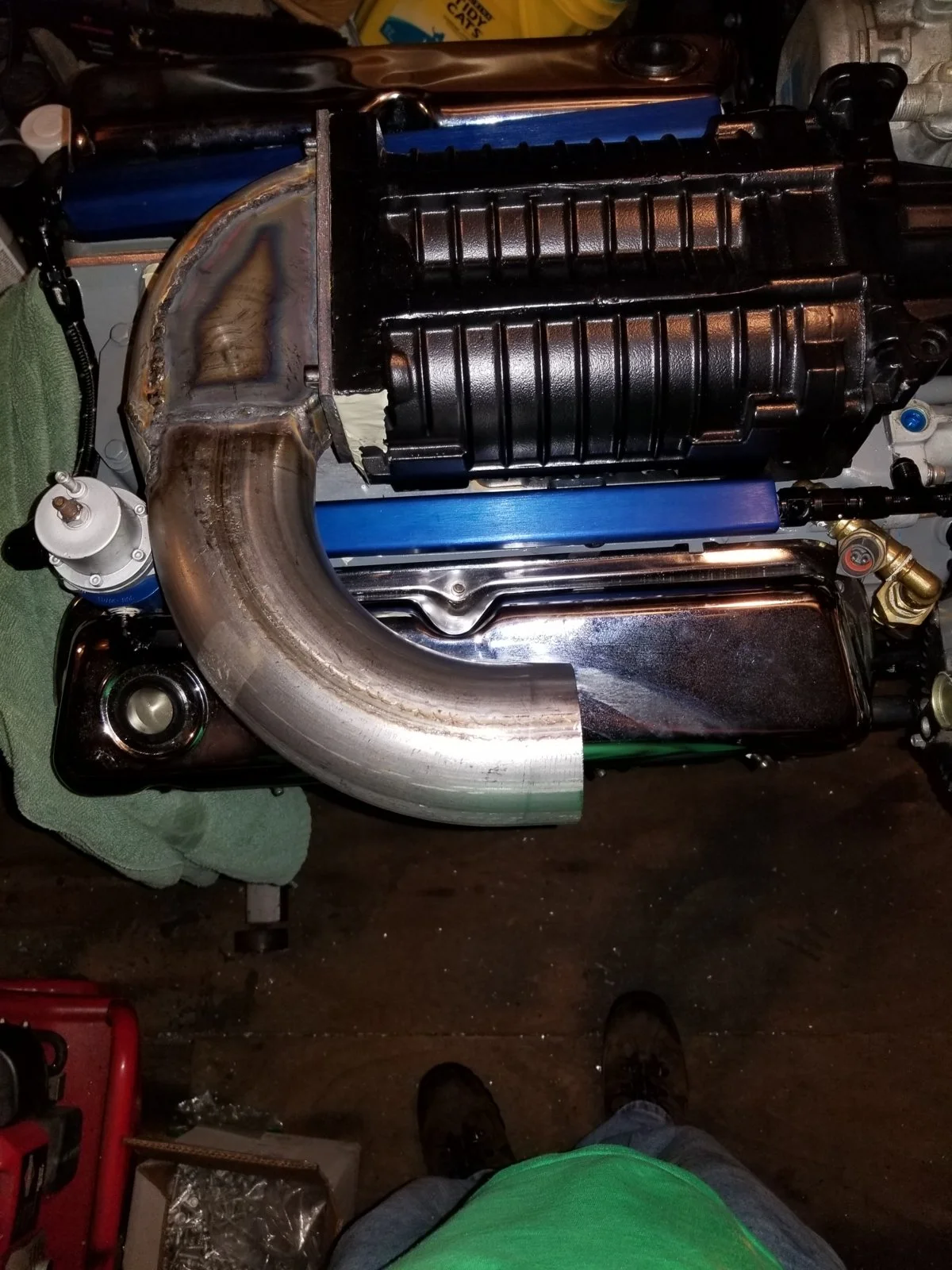

I must now cut a flange off the other intake I made and mate in to this one. I could/should have made the pipe higher for more clearance but I am confident it will work out. If it wont fit the way I want it too I see a remote mount iac in my future.

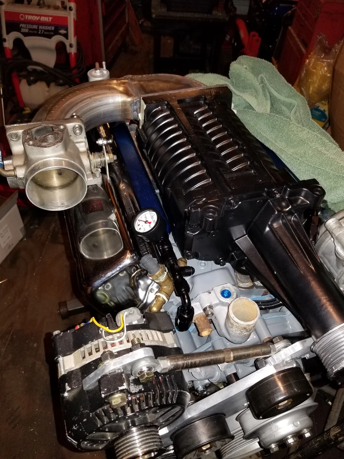

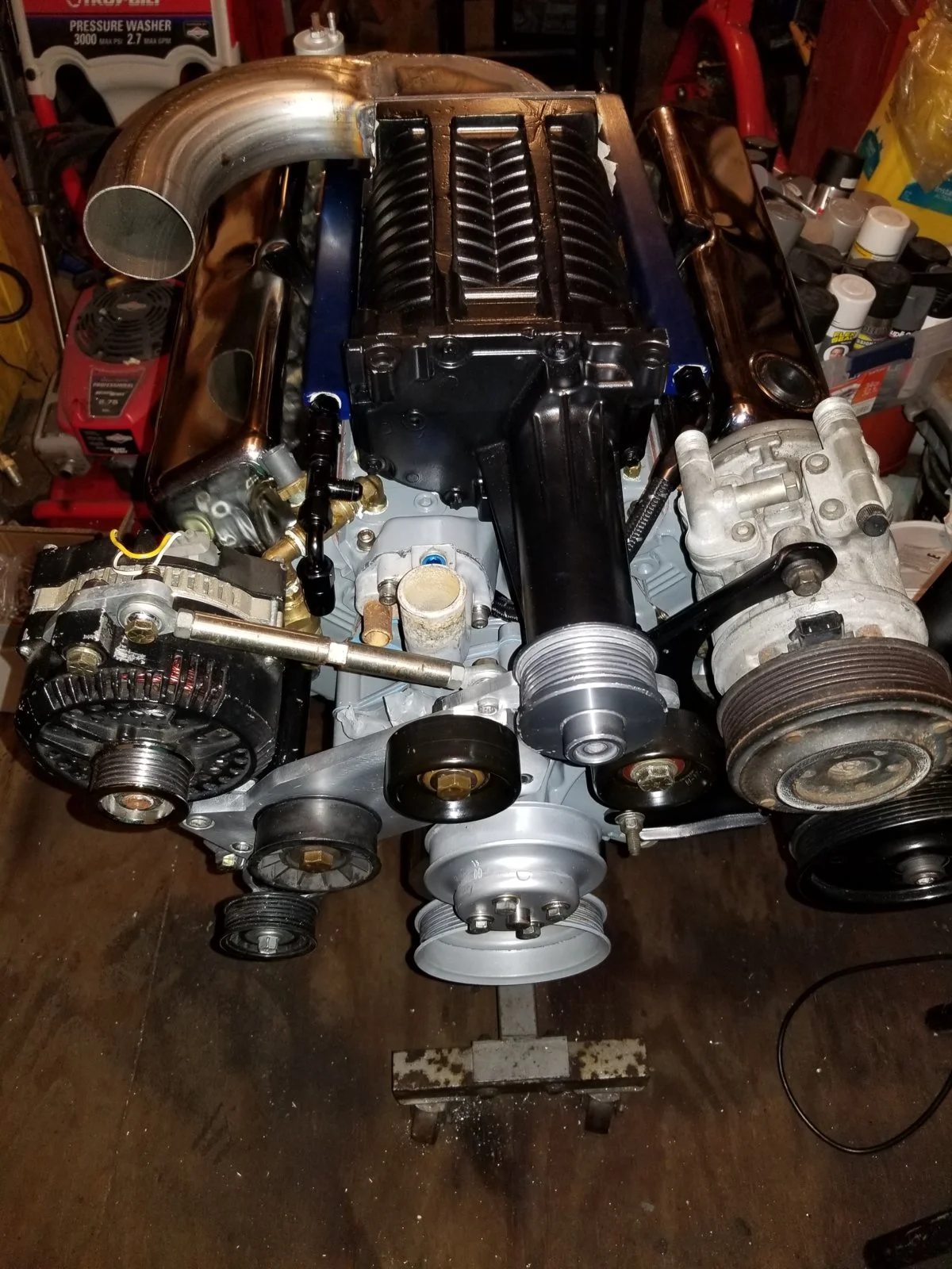

Well what do you guys think so far? I think the pipe will have to be cut back before the TB flange can go on, this way it's an easy turn into the fender. Going MAF this time with the tune, already have the 90mm maf lying around.
Reactions: 95BlueStallion and 90sickfox
hoopty5.0
mechanicus terribilis
Dec 14, 2010
7,811
6,961
214
SW Houston
Jun 21, 2018
#2,671
  • Jun 21, 2018
  • #2,671
I'd say if the pipe is currently pointing down at 6:00, cut it so it terminates in the 7:30 position to run it into the existing hole in the fender apron.

Tons better than the first time around, sorta looks like it belongs there.

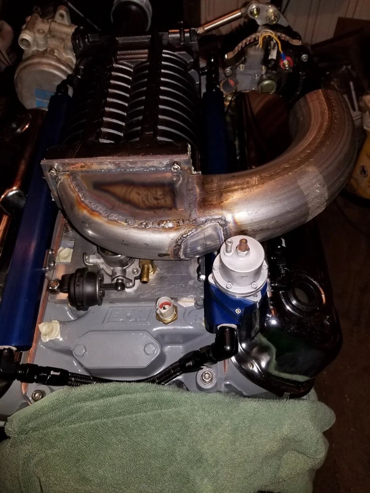

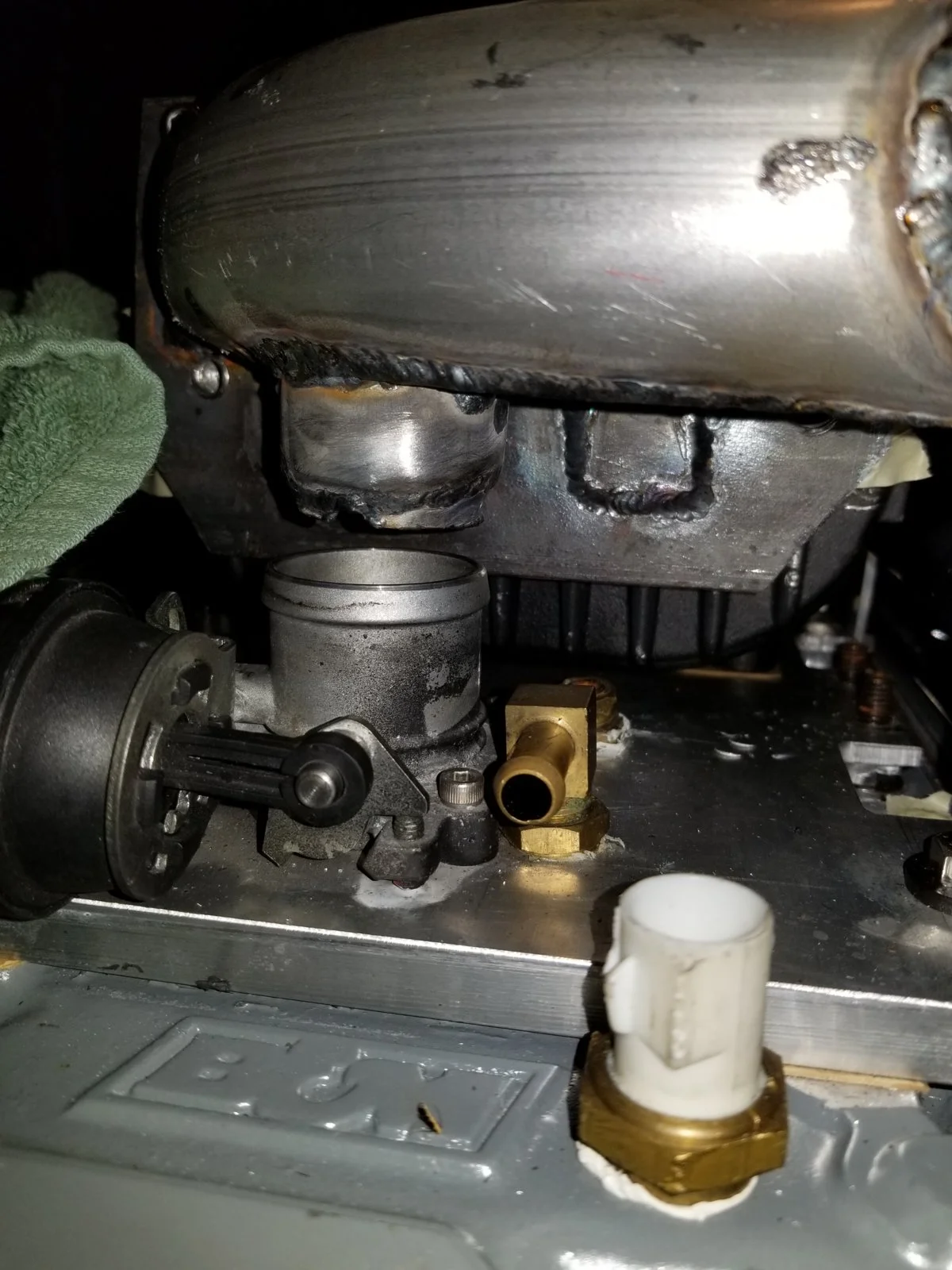

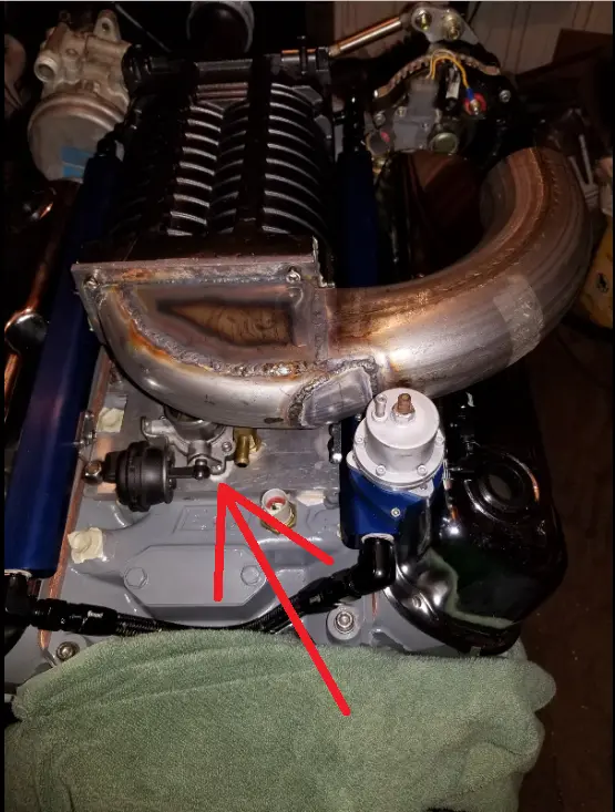

I did this after work.
There it is partially bolted down, I have not yet determined what position the TB will be positioned for the linkage connection. Not sure how much more awkward it will look with the idle valve connected. It will be more work but I think blocking the iac off will look better. I can then port in a remote iac valve and attempt to hide it.
A close up of the bypass valve just for you noobz, a rubber coupler will join them.

That turned out great.
Where would you remount the iac?
I would likely try and hide it either under the intake near the back of the blower or somehow incorporate it into the bracket that will hold the coil packs.
Either way it will get air from in front of the TB and feed the inlet just before the blower. This will make the valve slow to respond but i can work around that.
