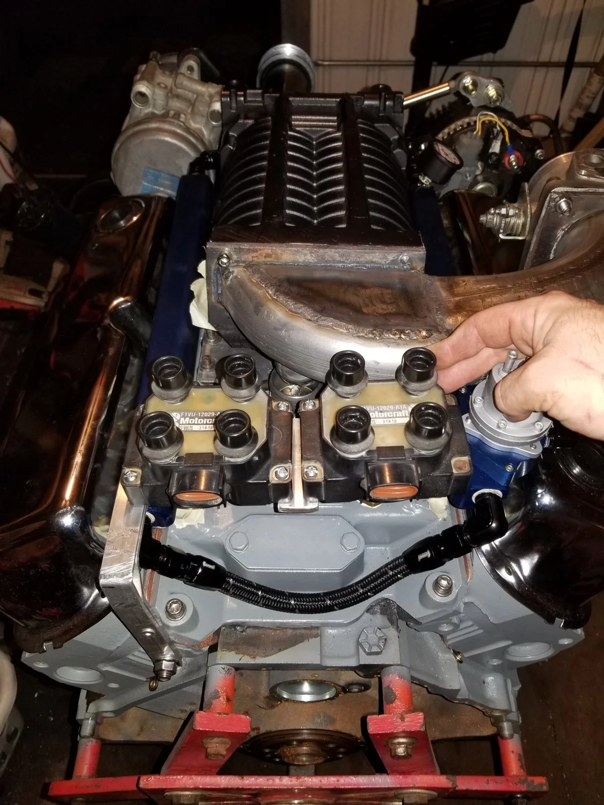

Small progress today but progress non-the-less...
its not complete but you get the idea, I still have to figure out a support from the other side... i may weld a small bracket on the inlet to catch that side. Looks as if there will be room for the idle valve somewhere below the coils but we shall see. I can always tuck the idle valve off in some remote corner.

You are going to brace the passenger side of that coil setup, the vibration may be too much and it will look even too.
i like it so far but I'm thinking you need to just call it Franky, he is not so much of a science project now, that crap looks like it belongs there!

the aluminum bracket is actually going to get a rubber bumper placed under the bracket so it will not rub on the fuel rail. The passenger side will get a support welded to the inlet, I want to leave the driver side open for harness placement for now.

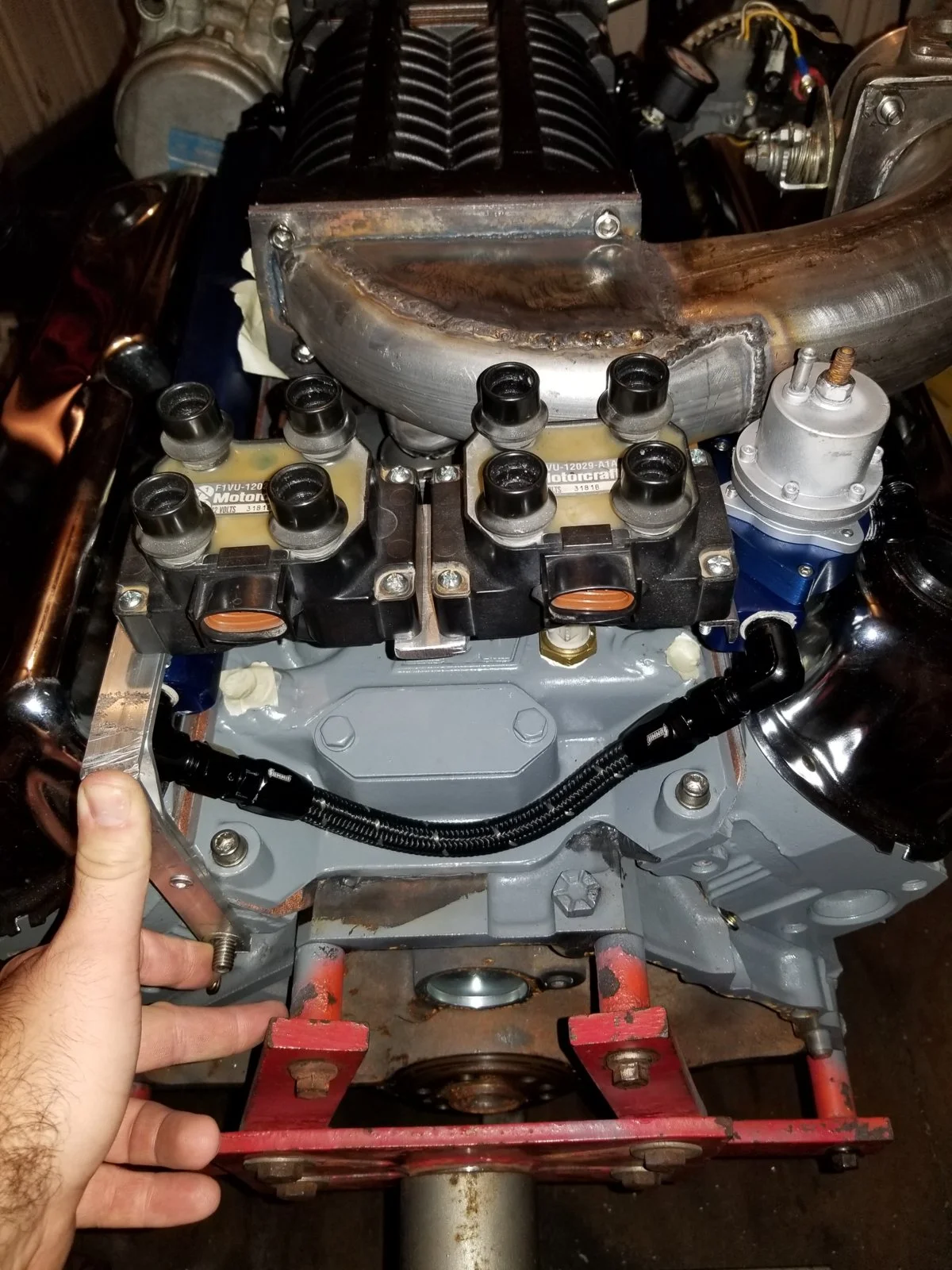

I did a thing.
they are mounted now, still have to dress some welds and paint... figure out the idle valve and throttle cable bracket.
It has been hard to get anything done with so much going on, have a few side jobs right now and they take up a bit of time with question answering and troubleshooting.
